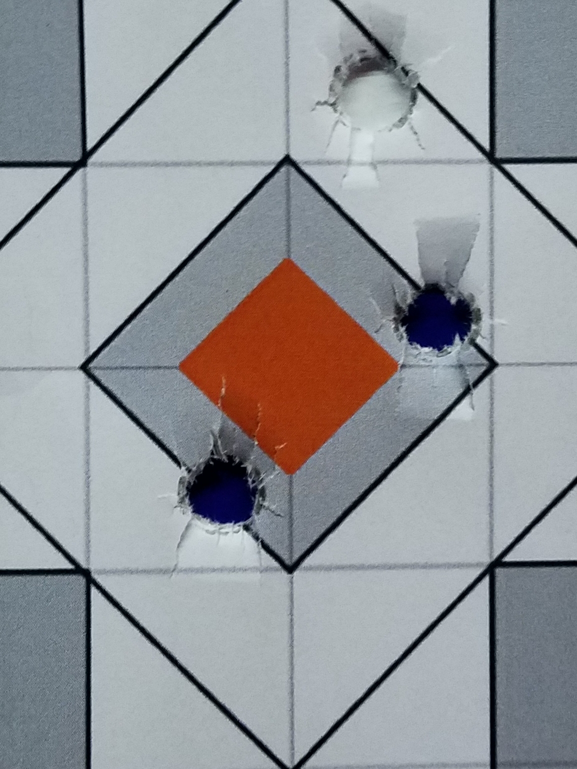

Ok, so I decided to follow up my previous test with the same load (54.0 IMR 4198, Nosler 300gr BT), only changing the primer. I wanted to see if using Remington, Winchester, and Federal primers shot any better or worse than the CCI's, and to the same POI. Obviously, if I really wanted to do a thorough test, I would set up a ladder with various loads for each one, but I didn't want to go that far at this point.
First of all, I only had about an hour to shoot this morning, and I think I was not taking my time as much as I normally do, and it showed. My groups were not as tight as they are normally, but I still got some info worth knowing.
Before starting my test, I fired two of the HSM cowboy loads to foul the barrel, as I had cleaned it recently. Then I fired 4 shots with the CCI primers.
The next three were with Remington 9 1/2 primers. One note: These primers are pretty ancient, so a fresh batch of Remington's may perform better. As it was, I don't think I'll do anything further with these fit now, at least not with this load.
The Winchester's were next. Only two of them, but they looked to be very good. I'll load a few more of these up for further testing.
Last came the Federal Gold Medal Match (not Magnum). Again, only two shots. They did OK, I think with just a little tweak they would be good, but I'll put them on the back burner for now.
It should be noted that none of these primers showed any signs of excessive pressure with this load.

So, I loaded up 6 with the WLR primers and went to the range yesterday. I fired 6 with the CCI primers and 6 with the WLR. Both shoot good, but the WLR seems to be more consistent and shoot better. I'm locking this load down with the WLR primers. I'll try going up and down by .5gr to see if I can get the same result with the CCI. For the record, here are the specs for this load:
Nosler 300gr BT
54.0gr IMR 4198
Starline brass, trimmed to 2.095"
Winchester WLR primer
C.O.L. 2.550" (crimping right on the cannelure)
Velocity is about 2125 fps.

I wasn't shooting over the chrono yesterday, so I can't say for certain. But the fact that they shot to almost the same POI leads me to believe that velocity differences were minimal. The WLR groups seemed to impact just a little bit higher, so maybe a slight increase in velocity.
Now to work up a load with the 300gr Speer bullets for comparison.
