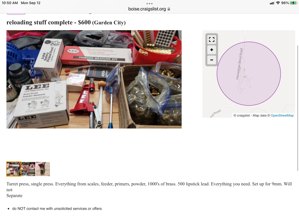

I actually have this one saved, planning on heading to a friends to do some reloading with him at the end of the week to make the decision to jump in or not. Dies, kits, tools, material and time all add up. As long as I can get the materials there is never a shortage of ammo.
