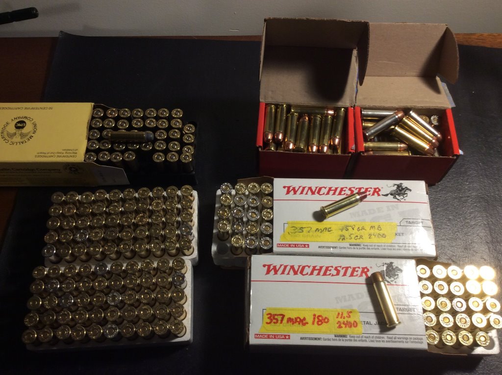

Post by fortyshooter » Wed Jan 22, 2020 3:11 pm
Finished up loading various .357 Mag loads for the new Henry to come!
357 Mag ammo.jpg (145.45 KiB) Viewed 5145 times

Post by TMB » Wed Jan 22, 2020 6:35 pm
Nice! Maybe someday mine will look as good.
