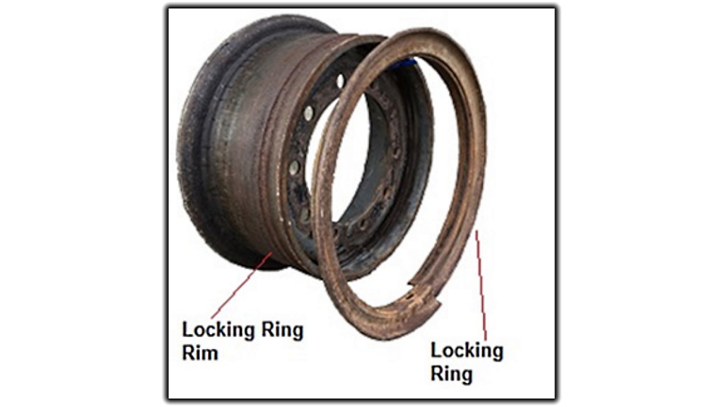

Kinda. A split rim is a wheel with a full rim on the back side of the wheel and a smaller diameter grooved rim on the front of the wheel that a rim lock ring locks into when the tire is pressurized.

So is that like the bead lock rims that they use on rock crawler vehicles? Those have a lot of bolts all around the rim though.
My understanding is that they use those because they run such low pressure in those tires, and they can drive the tire off the rim.
I'm guessing that a rim like the one pictured has to use a tube, or the air will find those gaps and leak out.

I don't know what rock crawlers use. Split rims do require a tube. 50+ years ago split rims were common on pickups, log trucks, semi's, construction vehicles, etc. Today, I believe they are illegal for highway use. I think they are still common on off road construction equipment.
I have seen split rims when I was a kid that only required a boot and not a full tube.
