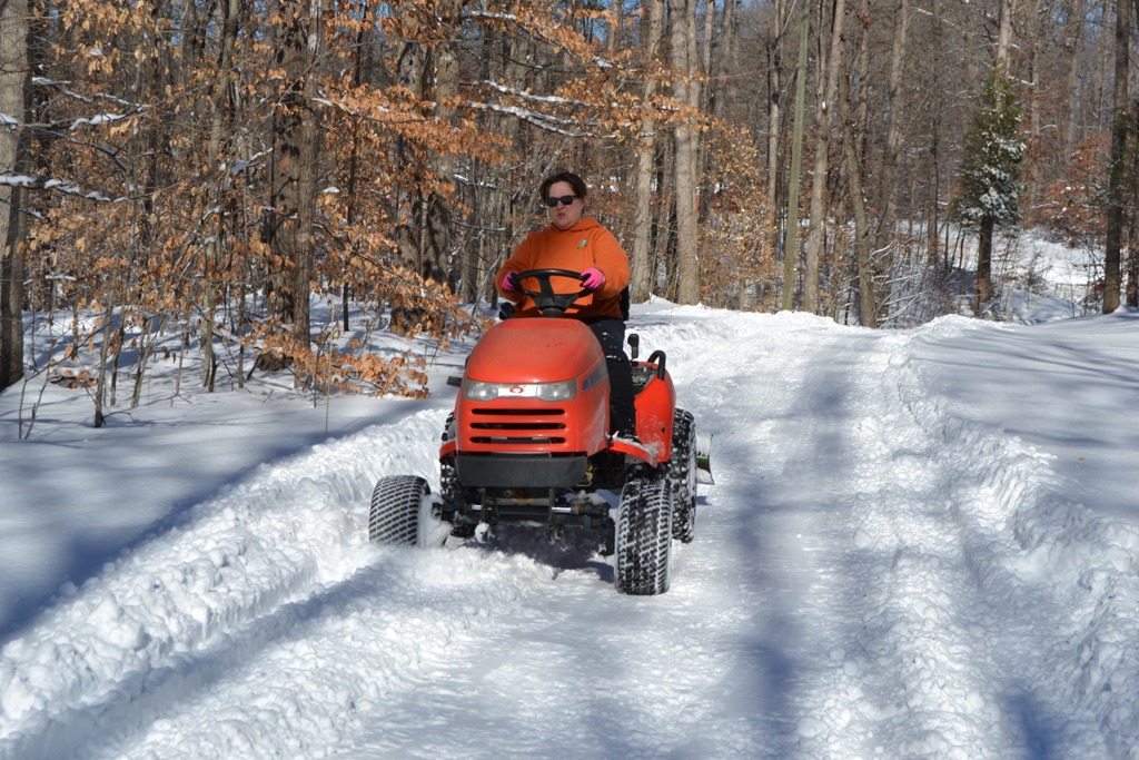

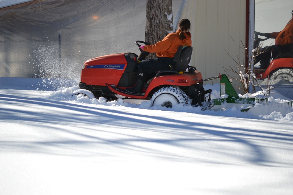

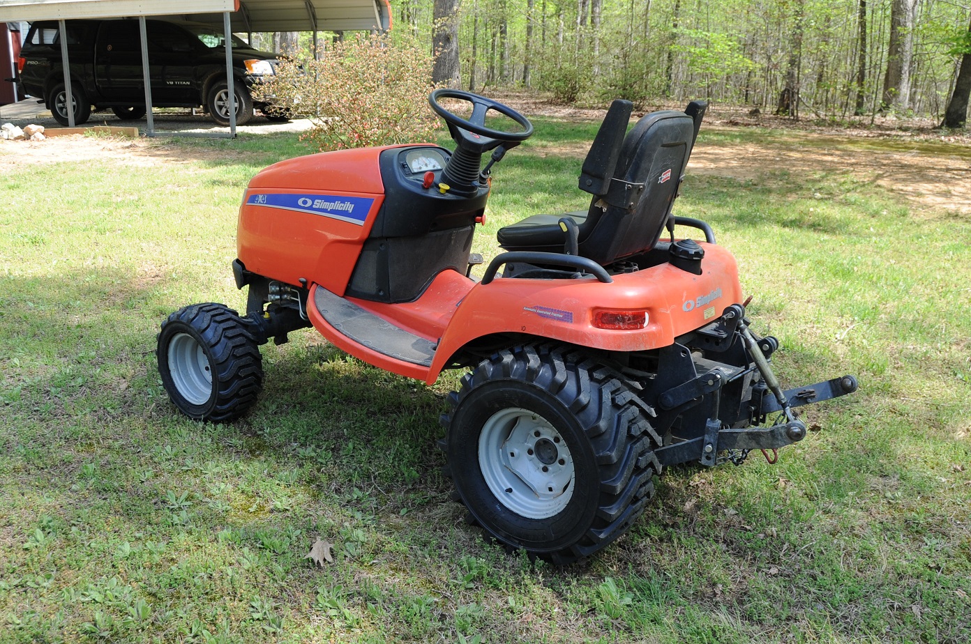

Tina used the Simplicity Legacy tractor to work the farm in VA, and when it came time to get new tires, she chose the ones shown on the tractor in the pic below. I don't know what they are called, or the type, but if you have been looking at tires you may know. She mowed with a pull behind finish mower rather than the under mower deck by this point and was careful not to turn HARD or use Brake Turns so the tires, even though aggressive, didn't tear up the yard. What they did do, it let the 4WD tractor do the work she needed done, including plow the deep snow in the winter and pull things. Lot's of things.
Simplicity was basically Massey Ferguson, bought by Japan.
New Tractor Tires.jpg (772.12 KiB) Viewed 8744 times
The tires really worked well for us in VA. We sold the tractor and all it's attachments when we moved, and bought a bigger tractor with a front end loader. Old Folks don't need to be close to a shovel and wheel barrow. But while we were there, we used this tractor a lot.

Post by Mags » Wed Sep 04, 2024 2:16 pm
BrokenolMarine wrote:
Wed Sep 04, 2024 12:45 pm
Tina used the Simplicity Legacy tractor to work the farm in VA, and when it came time to get new tires, she chose the ones shown on the tractor in the pic below. I don't know what they are called, or the type, ...
R4.
