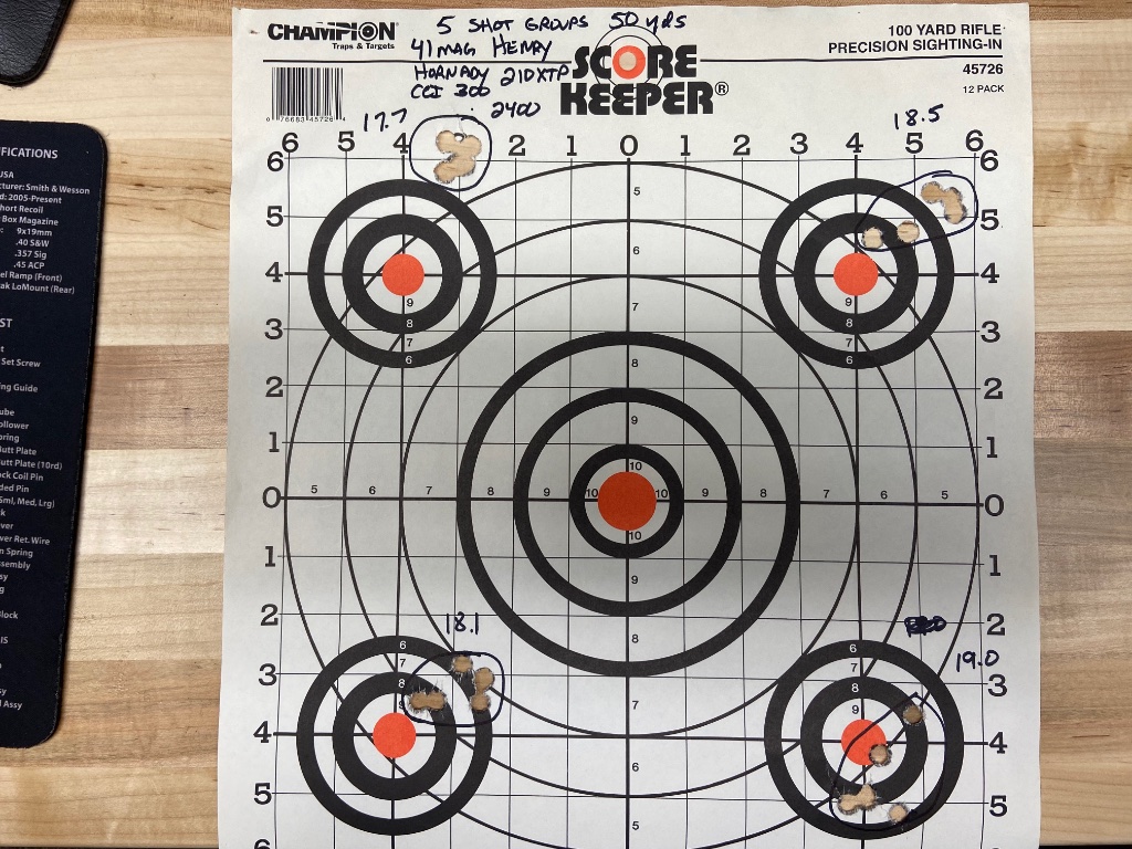

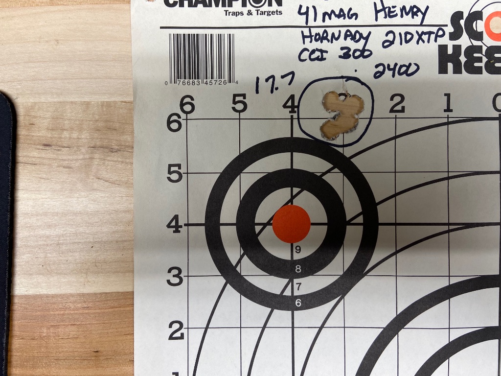

Well after way too long I finally got the 41 mag Henry back to the range to try the 2400 powder BigAl52 recommended. The results are promising as all groups are slightly better than my H110 loads. Pretty incredible that the lowest velocity load shot a one hole group. As the speed increased the groups opened up somewhat but not too bad. This is exactly what I experienced with my .357 Big Boy with the lowest velocity shooting the best group, again a one holer’. I’m sure the shooter had something to do with the bigger groups. :roll:

Five shot groups from a bench at 50 yards. 7X scope for the old man shooter’s eyes. :lol:

Hatch, that 17.7/2400 group is outstanding! I'd lock that one up and call it a day. Good shooting all the way around.

The proof of a great load is on the paper....great shooting!

Bet you hate that 41 mag about now dont ya. Nice job Hatcher love that 2400 in 41 mag.
