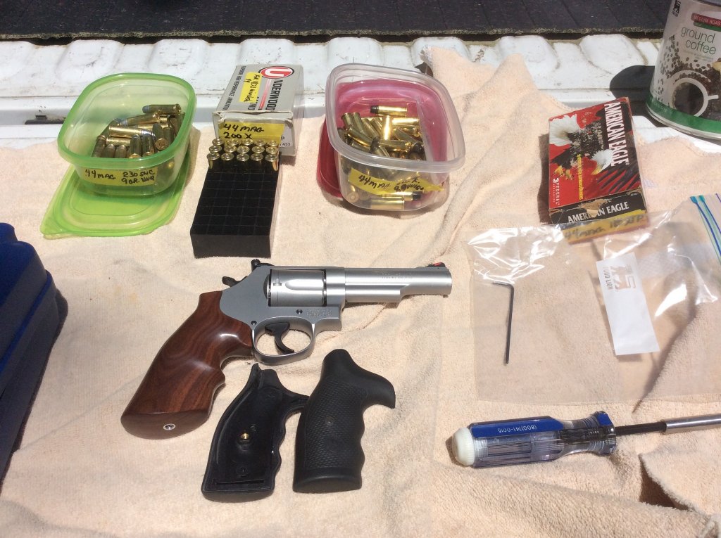

Have had this S&W 69 44 mag revolver for a good while and I remember it shooting right most of the time. It had seen 2 trips back to Smith to fix some issues when new and those were fixed. However I wanted to take it out today and make a grip change and try different loads to see what it likes.
So I swapped on the Hogue wood grips from my SW Model 25-7 revolver and was going to test those compared to the factory rubber grips which are slimmer in size and then put the factory grips on. Ammo was MB 240 gr. SWC loaded with 9 gr. of Unique...230 gr lead SWC Matt's Bullets loade over 9 gr. Unique and my sweet 200 gr Xtreme Plated load with 9 gr. Unique that shoots very well in my 1873 Uberti Winchester.

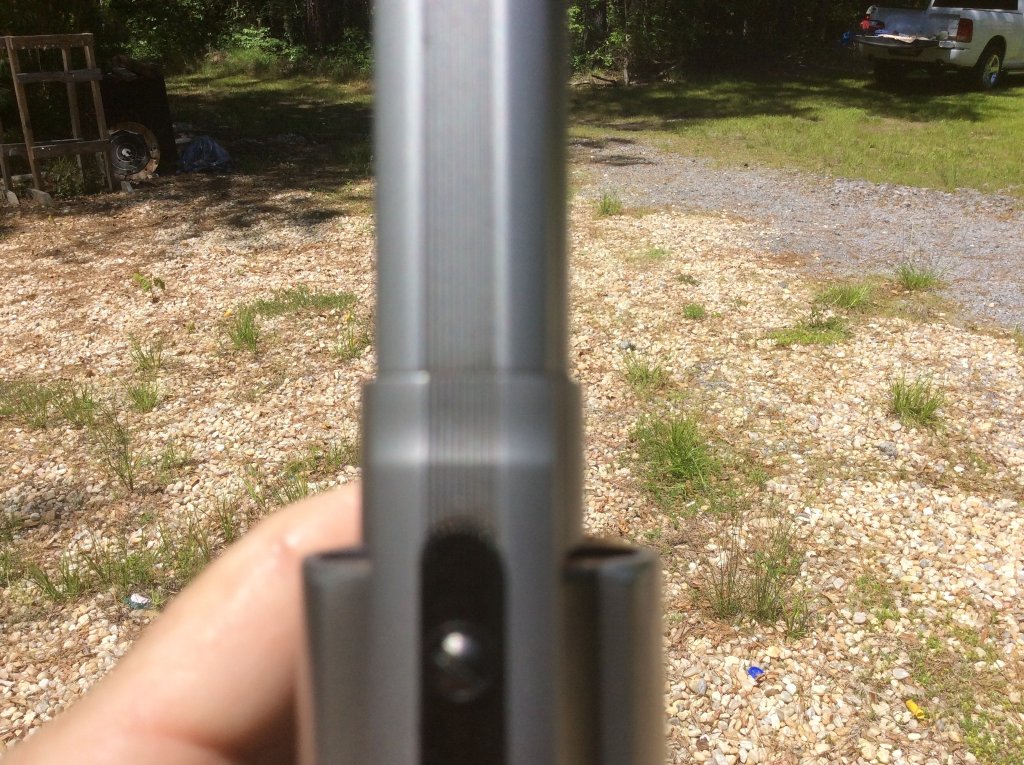

Yep somtimes I wonder about that myself but today it was the barrel being canted to the left just a bit as you can see. The barrel is actually a shroud that fits over the actual barrel. The front sight base is one with the shroud and can't be moved so had to crank the rear sight over.
