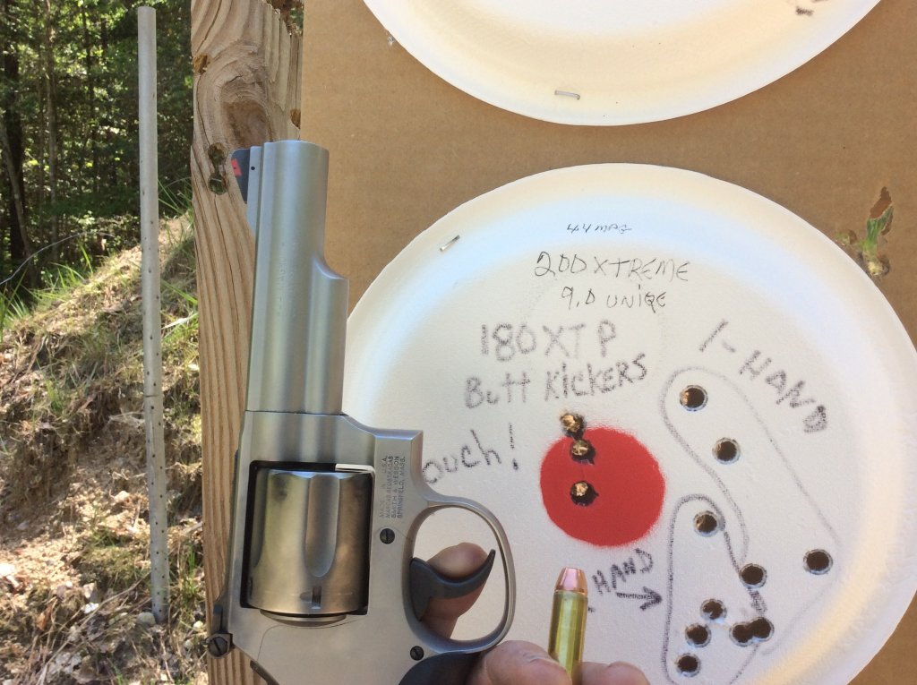

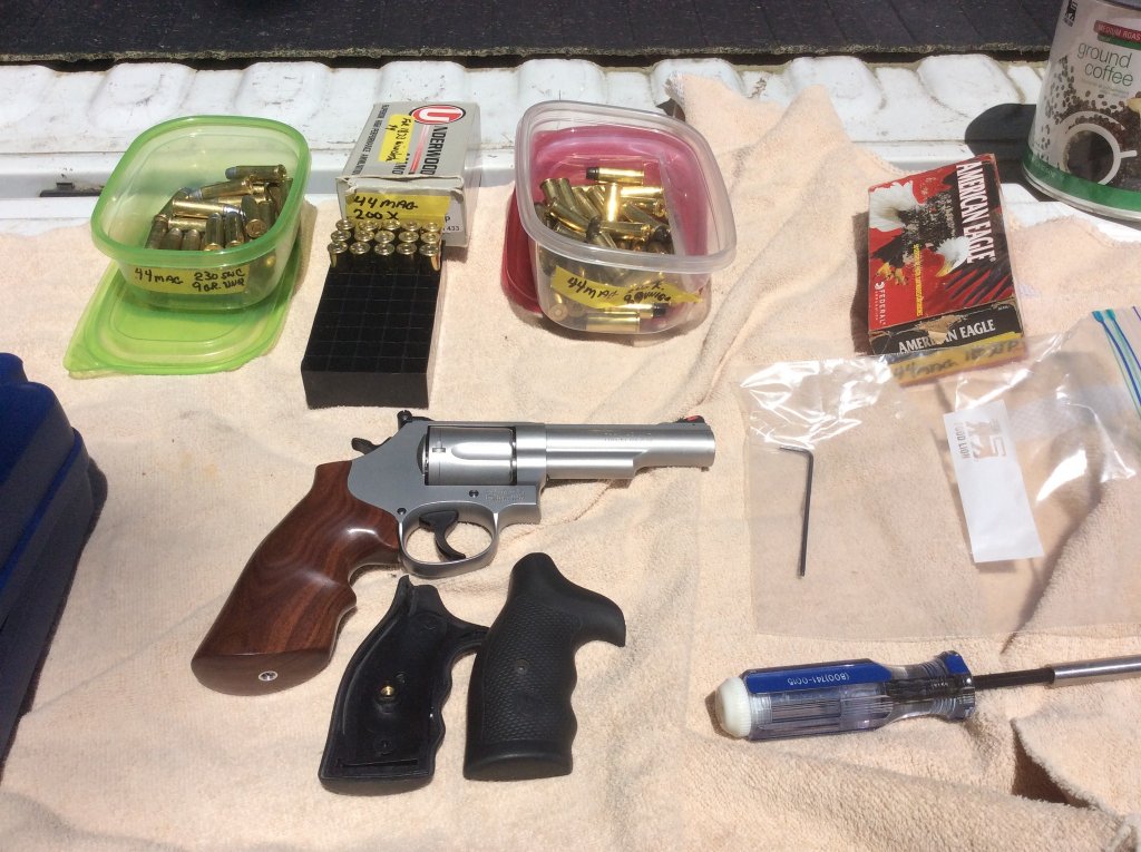

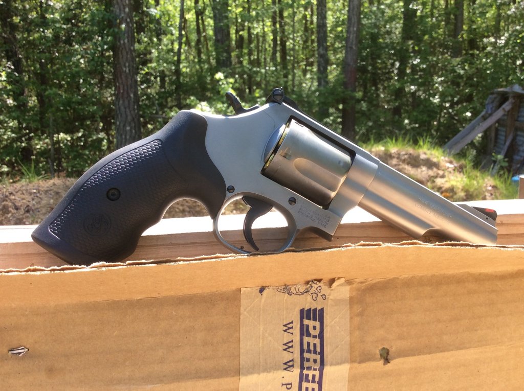

Have had this S&W 69 44 mag revolver for a good while and I remember it shooting right most of the time. It had seen 2 trips back to Smith to fix some issues when new and those were fixed. However I wanted to take it out today and make a grip change and try different loads to see what it likes.
So I swapped on the Hogue wood grips from my SW Model 25-7 revolver and was going to test those compared to the factory rubber grips which are slimmer in size and then put the factory grips on. Ammo was MB 240 gr. SWC loaded with 9 gr. of Unique...230 gr lead SWC Matt's Bullets loade over 9 gr. Unique and my sweet 200 gr Xtreme Plated load with 9 gr. Unique that shoots very well in my 1873 Uberti Winchester.

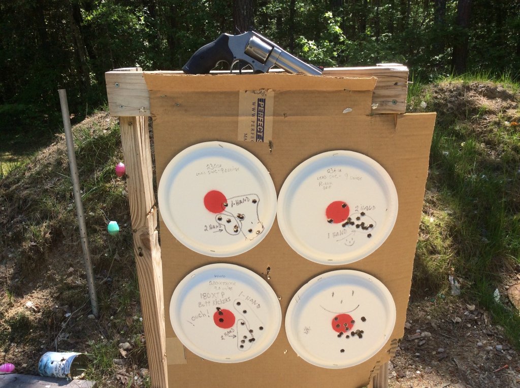

First target on top left was with the wood grips one and two handed shooting and then lower left same grip with the 200 gr. Xtreme load.
To sum it all up quick all loads and grips still shot right but with some giving good groups. Then I look and notice the barrel is clocked or canted to the left the way it returned form S&W. Well now that will do it to you for sure!
So I grabbed my small screwdriver and moved the rear sight to the left coast! Bingo right in the red zone no matter which grip used! Happy day here again!! Then I tried 5 rounds of my HOT 180 gr. XTP loads and the ground shakes when you touch off those! Three on the plate target hit home and the other two put a hurt on the steel swinging plates!
Now we have a nice shootin' L frame 44 Mag shooter!! Plus don't have to buy new grips! :D

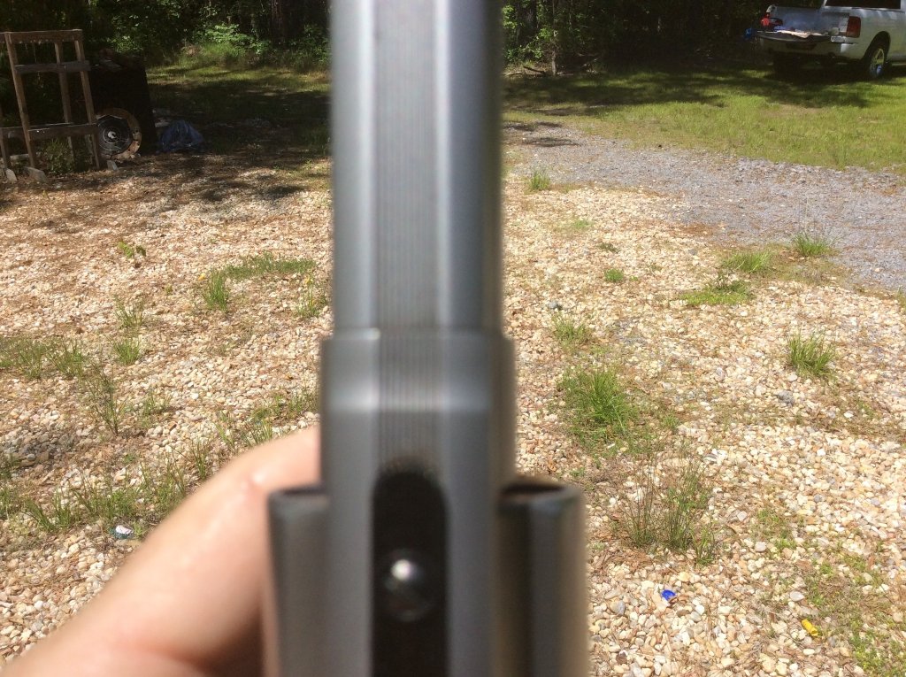

Yep somtimes I wonder about that myself but today it was the barrel being canted to the left just a bit as you can see. The barrel is actually a shroud that fits over the actual barrel. The front sight base is one with the shroud and can't be moved so had to crank the rear sight over.
