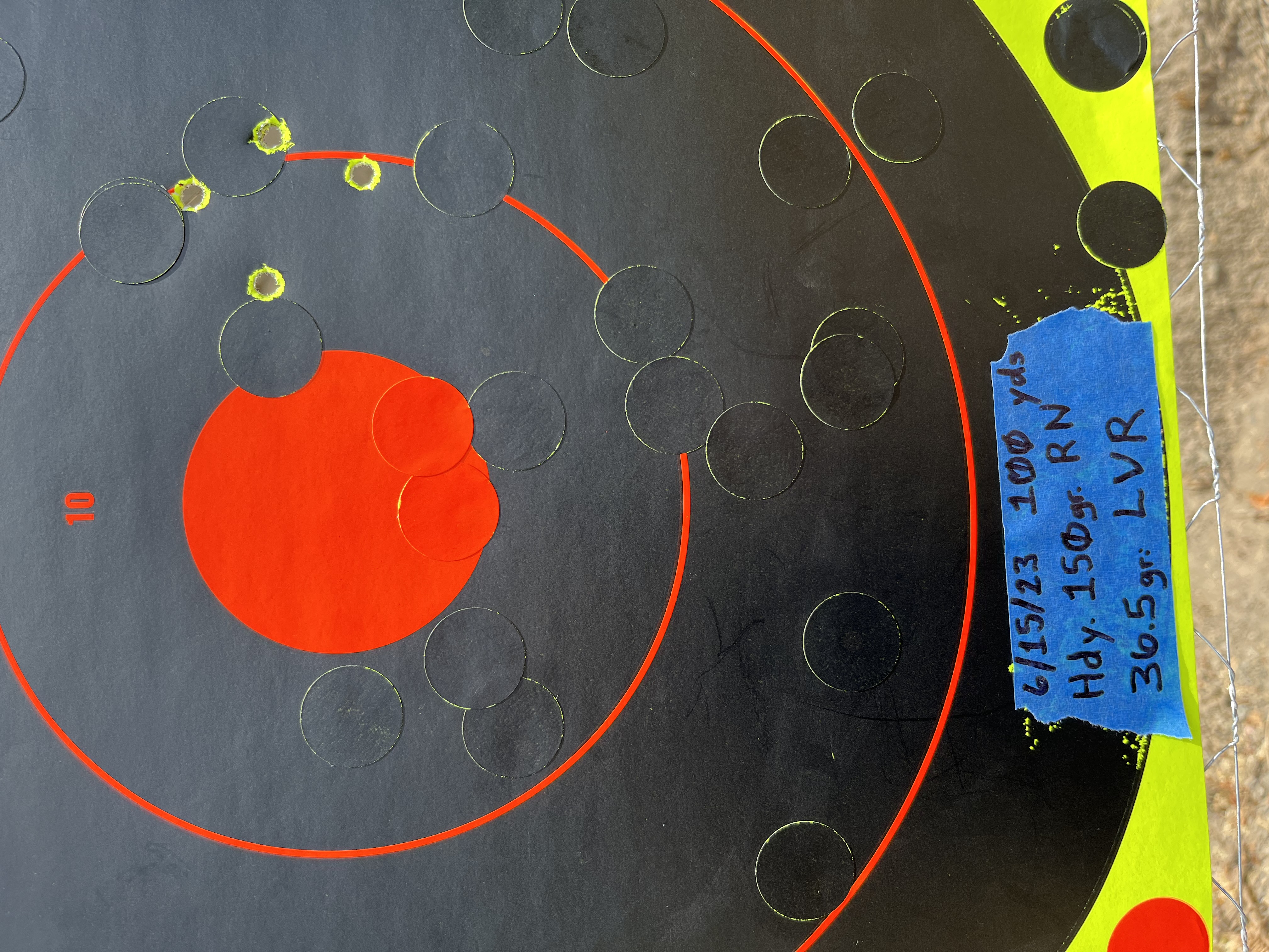

Back around June or July, I shot a 4-shot group of rounds with 36.5 grains of LVR and mixed cases. I managed to squeeze out a 1.7" group at 100 yards that day; another group was around 2.5". Wanting to shoot the same load again to see if I could duplicate it or improve it after my eye/cataract surgeries, I shot again last week.
Made it out to the range with some LEVERevolution reloads. Used all Winchester cases (because I seem to have more of them than other brands), Federal #215 primers, Hornady #3035 150 grn. RN bullets (because that's all I can source locally), and 36.6gr of LVR, and a batch of some with 37 grains of the same powder.
I shot 2 4-shot groups of each. Both charge levels grouped just under 2 inches for 3 shots, and then I would manage to send one flyer down to open the group up nicely. :roll: I seem to have a knack for snatching defeat from the jaws of victory. :lol: Or, maybe I just flinch consistently on shot #4 everytime......
One other guy in my gun club was there, and asked me if I wanted to shoot through his chronograph. At first I declined, but he kinda kept insisting, so I caved. I only had 4 reload rounds left with 36.5 grains of LVR, but sent 'em through the timer. The shots went 2320 fps, 2334, 2330, and 2329. I was happy with the consistency. Shows me a that a better shooter, or the gun with a scope, might group a bit better. For me, groups somewhere around 2-3" at 100 yds is plenty fine. I'd rather not pull the trigger if I can't hunt closer. It is, after all, called "Hunting", and not "Shooting"......
FWIW, the factory loaded Winchester 150 gr. Power Point ammo claims 2390 fps on the box, probably shot out of a 24" barrel. The guy's chrono had 3 of these averaging around 2250 fps out of my brass frame rifle (20" barrel), about 140 fps below the factory's claim. Evidently, size does sorta matter.

Just took my brass framed .30-30 (20” octagonal barrel on this one) out to the range this afternoon. Also, after using one at my range a coupla weeks ago, I succumbed to something stupid and bought a cheap Caldwell Ballistic Precision chrono. It was $83 shipped from Amazon, so I don’t have a ton of $$$ into it.
Long story short, this 30-30 likes the Hornady #3035 150gr RN bullets over the 170 grainers I had hoped would group. Using 36.6 grains of LVR got me a decent group at 100 yds. a coupla months ago; somewhere around 1.70”. I could not duplicate that result again this afternoon with that charge, but managed to get very close with a 37 grain charge. Max charge for 150 grain bullets from Hodgdon is 38.5 grains, so I’m still at what I consider a safe charge level of LVR with 37 grains. And to me, getting a group under 2” @ 100 yds. with open sights is “okay to hunt with”. I’ve stepped out into the fall woods with worse in my younger days…..
FWIW, IF this chrono is somewhat accurate (it’s given me no reason to believe otherwise), my 4 shot group tonight netted 2400 fps average. Pretty good, but I try to chase accuracy first over speed. But the other info I got from it was encouraging to me.
The 4 shots were:
2403 fps
2403
2404
2390
The app you can download for this chrono gave it an average of 2400 fps. The extreme spread (fastest shot to slowest shot) was 14 fps. The “standard deviation” was 6.68. Now I’m not the sharpest tool in the shed here. And I know that one 4-shot group on a warm day isn’t always indicative of how things really are. Ya need more shots across the chrono to get gooder data. But I DO know that the lower the ES & SD values are, the better. It shows some uniformity/consistency with the loading. Which, if someone better was pulling the trigger and used a scope, might show that this load and rifle kinda has a bit of accuracy potential for a lever gun.
FWIW again, for those like me who are curious, Winchester factory loads (150 Power Points with the buck on the white box) advertise 2390 fps, probably out of a 24” barrel. It shot an average of 2275 fps from my rifle, with larger ES & SD values. And an inch+ larger group size over the hand loads. Haven’t shot any Hornady LEVERevolution 160 grainers or Federal blue boxes through the chrono, but have noted their points of impact is about where my hand loads are hittin ’.
