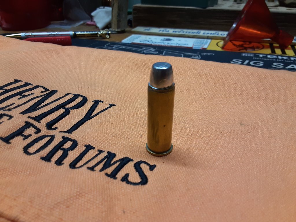

;) I loaded a single 44 round just for forty. :lol:
That one there is 19.3 grs 2400 with a Keith style 250 gr.
OAL 1.635, that's the longest my BBB will cycle reliably.
