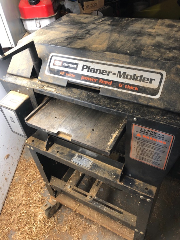

Found new feed rollers for this 12" 5 hp planer so I am going to replace the old ones which are too slick to pull planks through. Found a manual on the Belsaw website but cannot locate new drive chains on any site so I am going to clean up the old ones and lube them before re-installing. No idea how old these are but when they break I think I am hosed. Taken off the covers and gotten pictures of everything in place and spraying all the bolts with Blaster hoping this will go smoothly. Intending to get into it this week after work, just have to get brave enough to start tearing things apart.

Replaced the feeder rollers in the planer yesterday. Was a bit of a challenge removing the drives and returning everything properly. Fortunately I had located a manual with an exploded parts diagram and took plenty of before pictures. Cleaned chains in kerosene and used chain lube. Had to manually work each link to free up and get lube worked in, and greased up all the bearings. Works great. Now have a functional old workhorse, they don't make them like this anymore.
before removal
finished project after trials.
