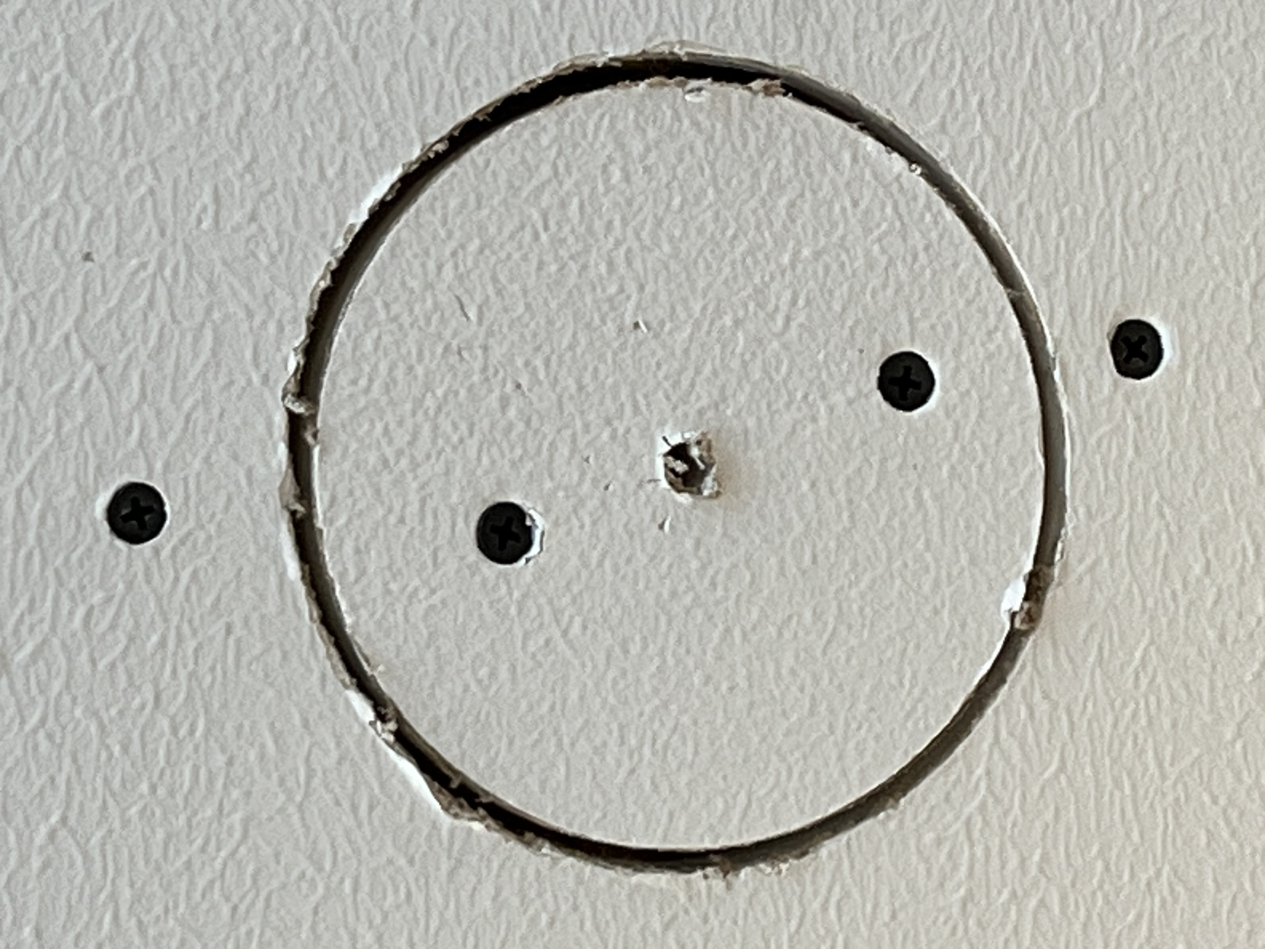

I worked on patching the ceiling yesterday. The first step is to cut a 1x4” board about a foot long and place it in the hole.
Then put two screws into the sheet rock in the ceiling and then into the plugs that were removed.
I saved the pieces taken out and they will fit back in perfectly.
I have more time in taking the pictures and posting than I do thus far.
I still have one more screw and then of course the mudding.

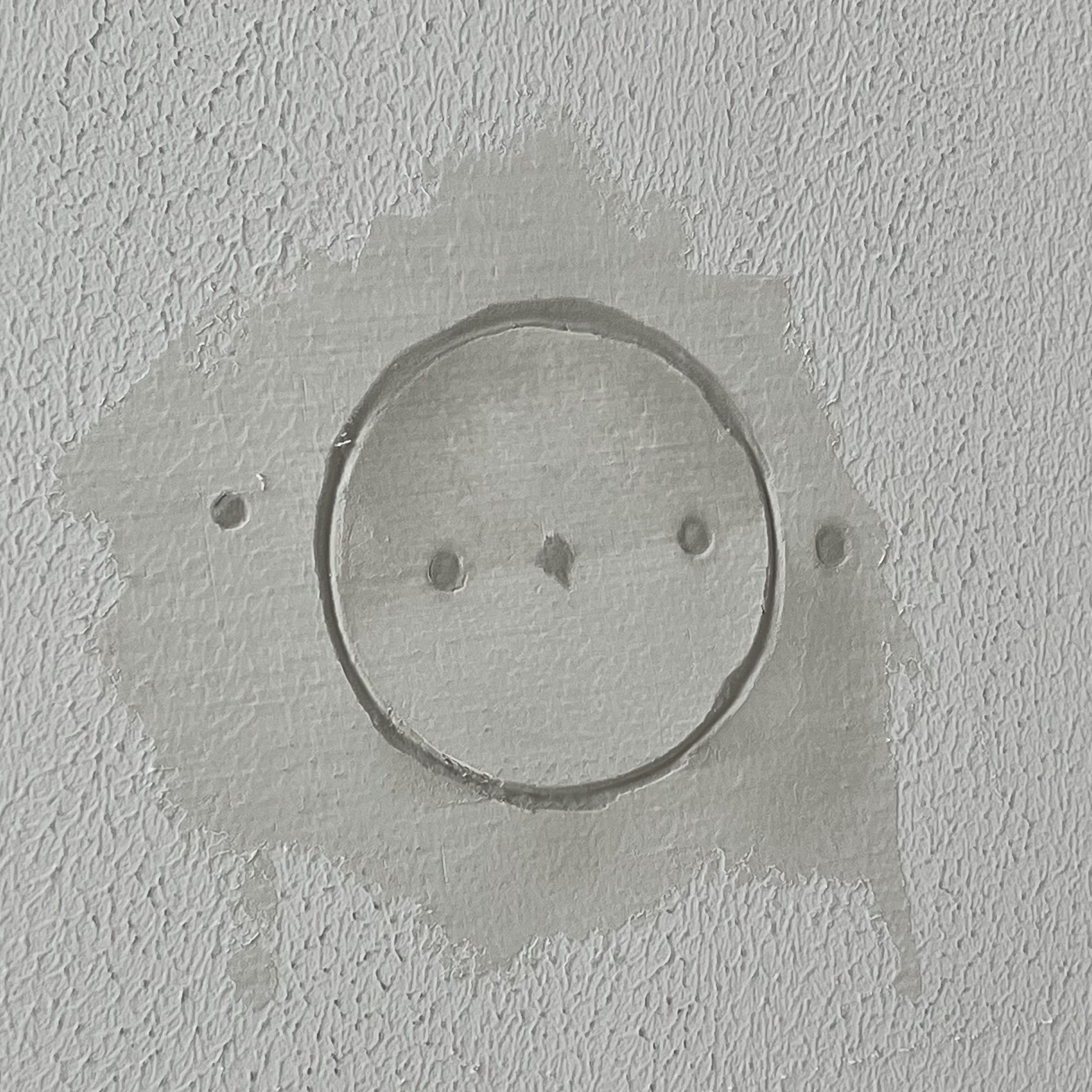

Posts: 13588
Re: Track Lights
Post by Sir Henry » Sat Mar 01, 2025 4:45 pm
I did some filling today. I estimate it will take me three fills to get it right. The picture was taken when it was still wet. The gaps now are much lighter.
When it’s completely dry I’ll take a damp cloth over the excess and then fill the gaps in again.
