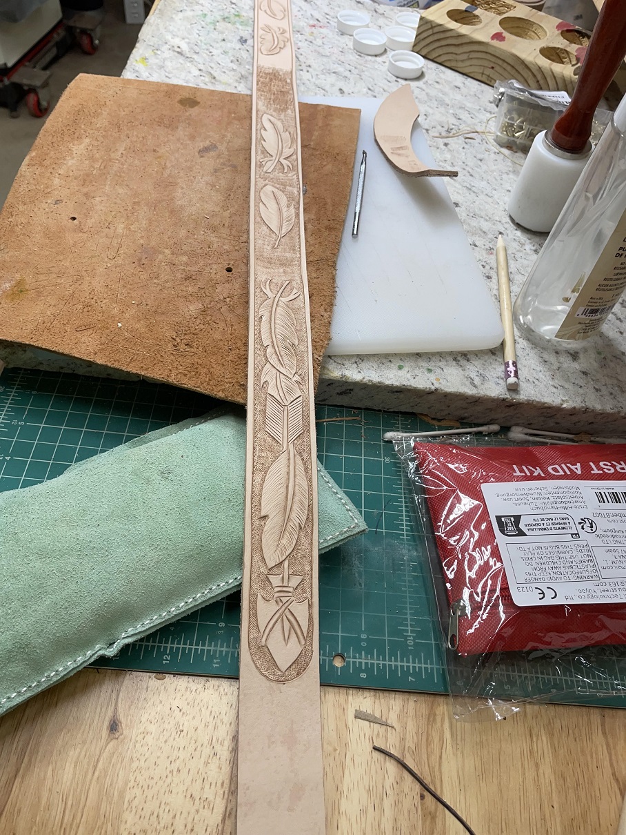

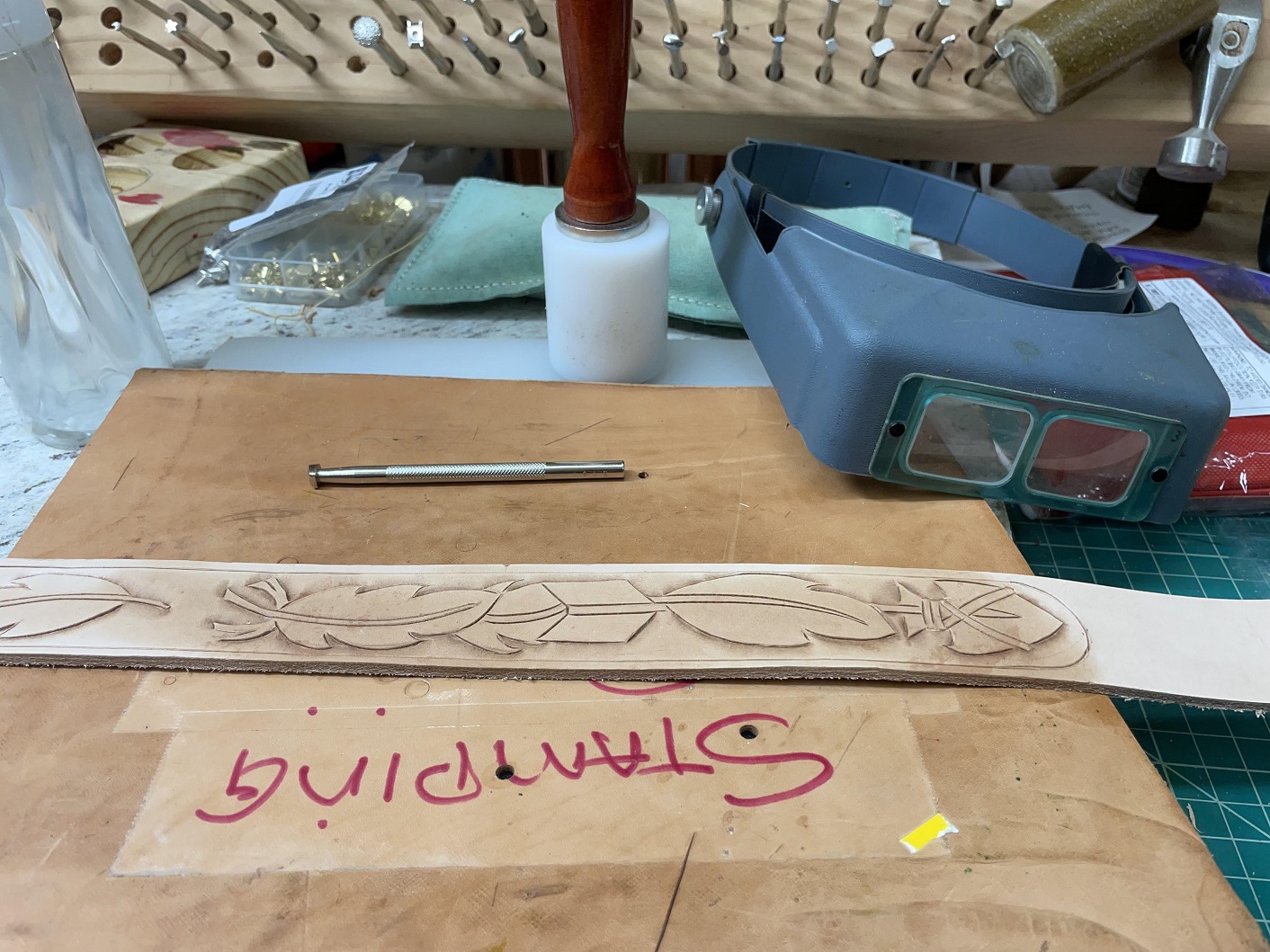

I started the next belt, a much nicer oak leaves and acorn belt. I took my time and used an illuminated drafting plate to transfer the pattern to the tracing paper. I made sure the leather was exactly 1-1/2 inches wide. I took care to stay exactly on the template lines. I should have been beautiful. :lol:
Each template section is about 10" long and you have to shift the template and reposition it each time to move down the belt length. Then you move down the template, tracing the pattern to transfer it to the damp leather. Slow and careful gets it done. I was slow, I was careful, and made sure I stayed right on the lines. :)
What I didn't notice until I was done, is that the template shifted on one section. The pattern was OFF, and nearly to the edge. The belt pattern is supposed to have a 1/4" border down both sides. :evil: That's a stitching line. Nope... time to start over.
I took a long break, that way you don't throw things, or cut off a finger. 8-)
(That's always a good thing, NOT cutting off a finger.)
The NEW pattern is called, Feather's and Arrows, and honors my Grandfather's Bloodline. Choctaw and Blackfoot. I've just gotten started, but you get the idea.

I had a second session yesterday and got the beveling done. I got back in the shop today for a bit of work til the hands cramped up. The tooling is bad enough, but the backgrounding is a killer. :lol:
I added the details and it really starts to bring it to life....

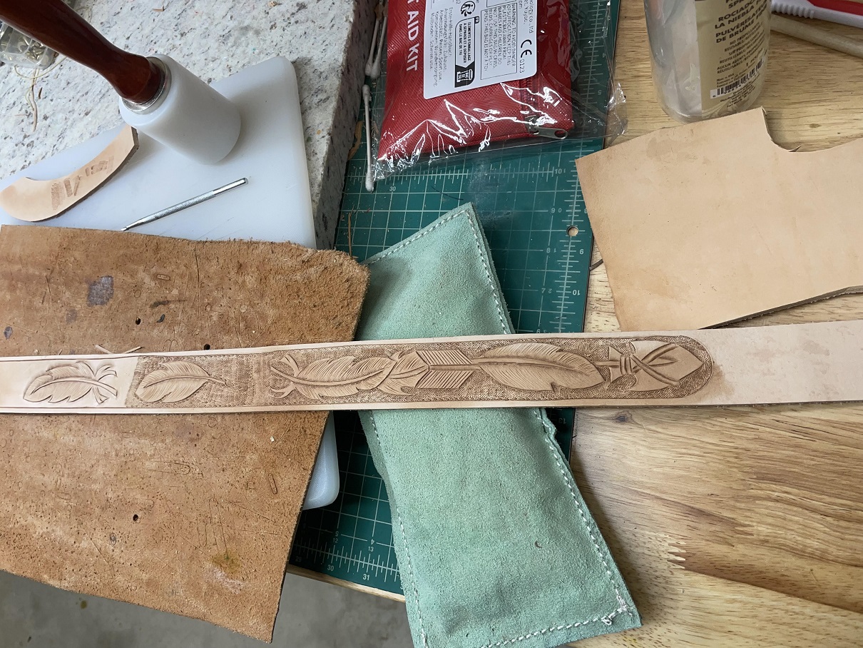

Then, when you begin to background, putting in the shading... it adds to the 3D effect and makes the rest pop. ;)
Unfortunately, the tool I really like for this is small, and has to be to get into the areas I need to background. But I don't have the larger matching tool for the open areas, which means a lot of tap, tap, tap in those areas. Kills the hands. You can tell where I took my break. :lol:

Another session in the shop. Worked until the hands asked for some time in the heating pad. :lol:
A bit over halfway with the backgrounding. JUST a bit. Two more sessions should see that done. Then on to working on the extra highlighting details, then dyes and finish work on all the parts and components before assembly. Seems like a lot of work, but it passes the time and I'll have something to show for it. ;)

That little scrap laying in front of the belt strap on the granite? I use it to test punches or the sharpness of the swivel knives after I strope them before cutting into the real project. Always have scraps laying around. When I am ready to dye the belt, I'll use that to test the dye color, then test the antiques to decide which one I want to use. Scraps are very handy. LOL.

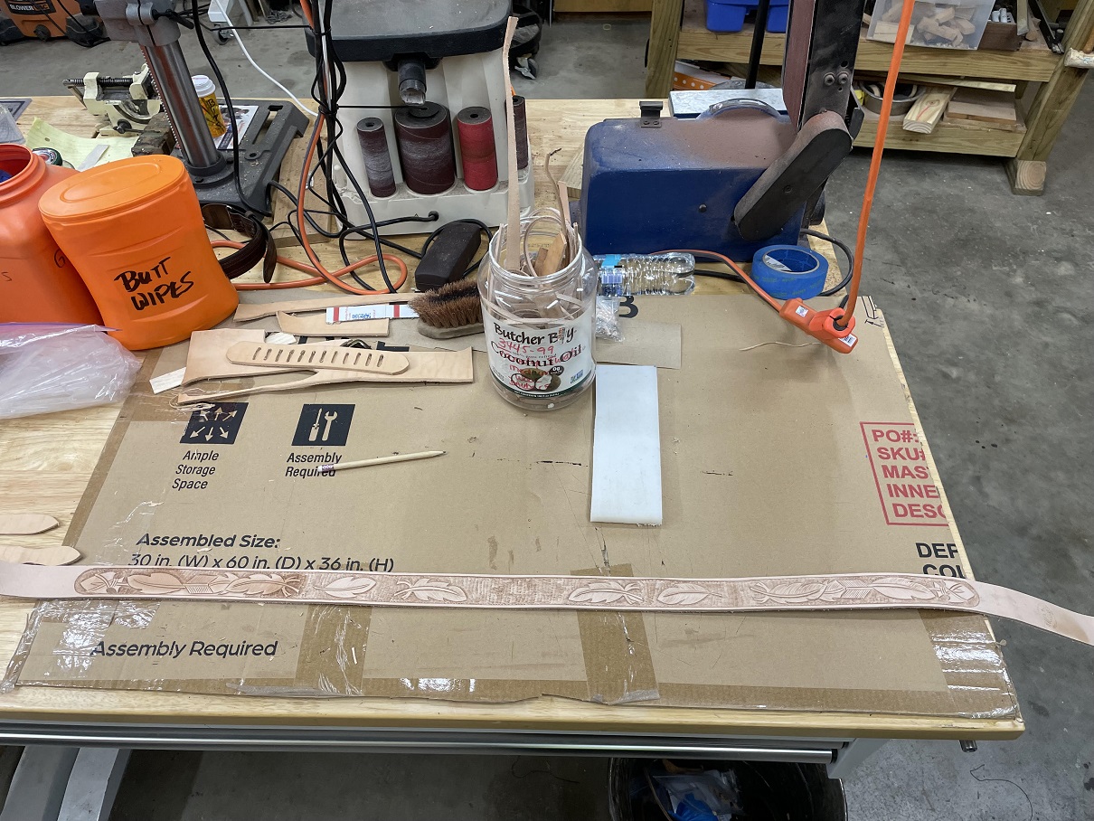

I was about to post up that the backgrounding was completed after my afternoon session, but when I resized the picture, I noticed a couple small sessions I missed. Ten minutes of work, and they will be done and the backgrounding WILL be completed. Uh... duh. :roll: Tomorrow we'll be making that long five minute drive to a friends for Thanksgiving. But, I'll likely find ten minutes to knock that out. Can't do much more until the Buckle comes in from Tandy, I'm guessing midweek next week?
07 backgrounding complete.jpg (441.46 KiB) Viewed 8172 times
Yeah, yeah, the colors will match once the working area dries. :lol:
I have the billets cut out and ready to cut the buckle holes and the holes for the buckle bar in them, but THAT will also wait for the tools I ordered. A 1 inch oval punch for punching out bullet slots, which should work for belt slots as well.
We are moving right along. Until then I can burnish the edges on the parts and pieces, and do some staining.

I see you keep a supply of butt wipes close by. Never know when you can’t trust a fart, :shock:

Well, that, and knowing that butt wipes are great for taking off the gunk I get on my hands working with leather, woodworking, or in the making of knives. The soft wipes are great for blowing my nose when the chemicals get it running, and will remove some of the index marks I put on metal. Between the wipes and paper towels, I'm covered for "most" things. :lol:

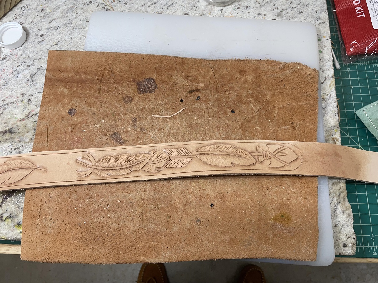

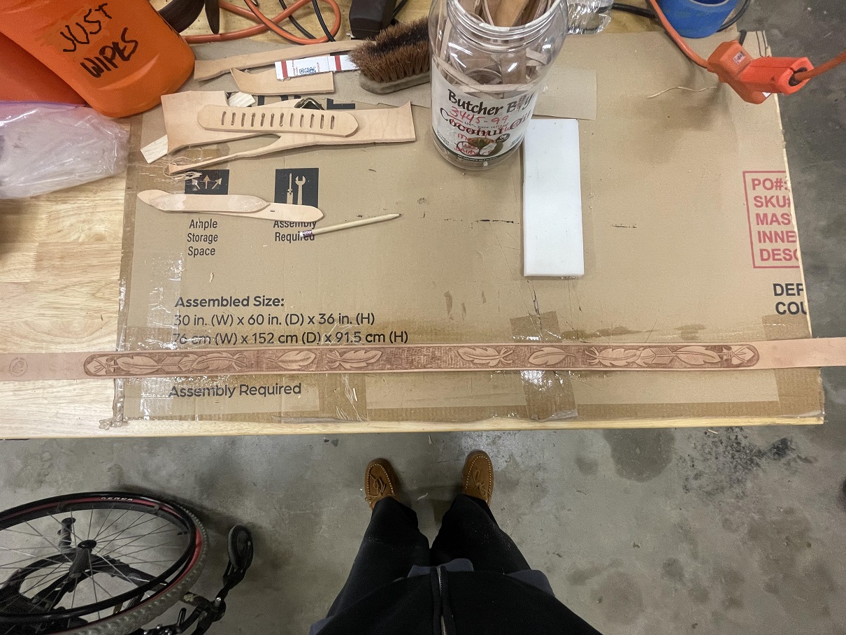

Got out for a few minutes this morning and shaded (Backgrounded) the area(s) I missed. I think it's all backgrounded now. I'll be able to burnish the edges and do a few other minor things while I wait for the orders from Tandy. :lol: I might even cut out the 2-1/2" blank for the gunbelt while I wait. I have to check the leather I have under the bench and make sure I have what I need. :lol:

Re: Well, that didn't work...
Post by RetiredSeabee » Thu Nov 28, 2024 7:45 pm
From that camera angle you have very small feet. Have quite a few of the same self portrait shots.
Posts: 7516
Post by BrokenolMarine » Thu Nov 28, 2024 10:18 pm
10-1/2. Those are my lined moccs. Keep my tootsies warm in the shop. :D
Surprised they showed. Guess my diet is working. ;)
