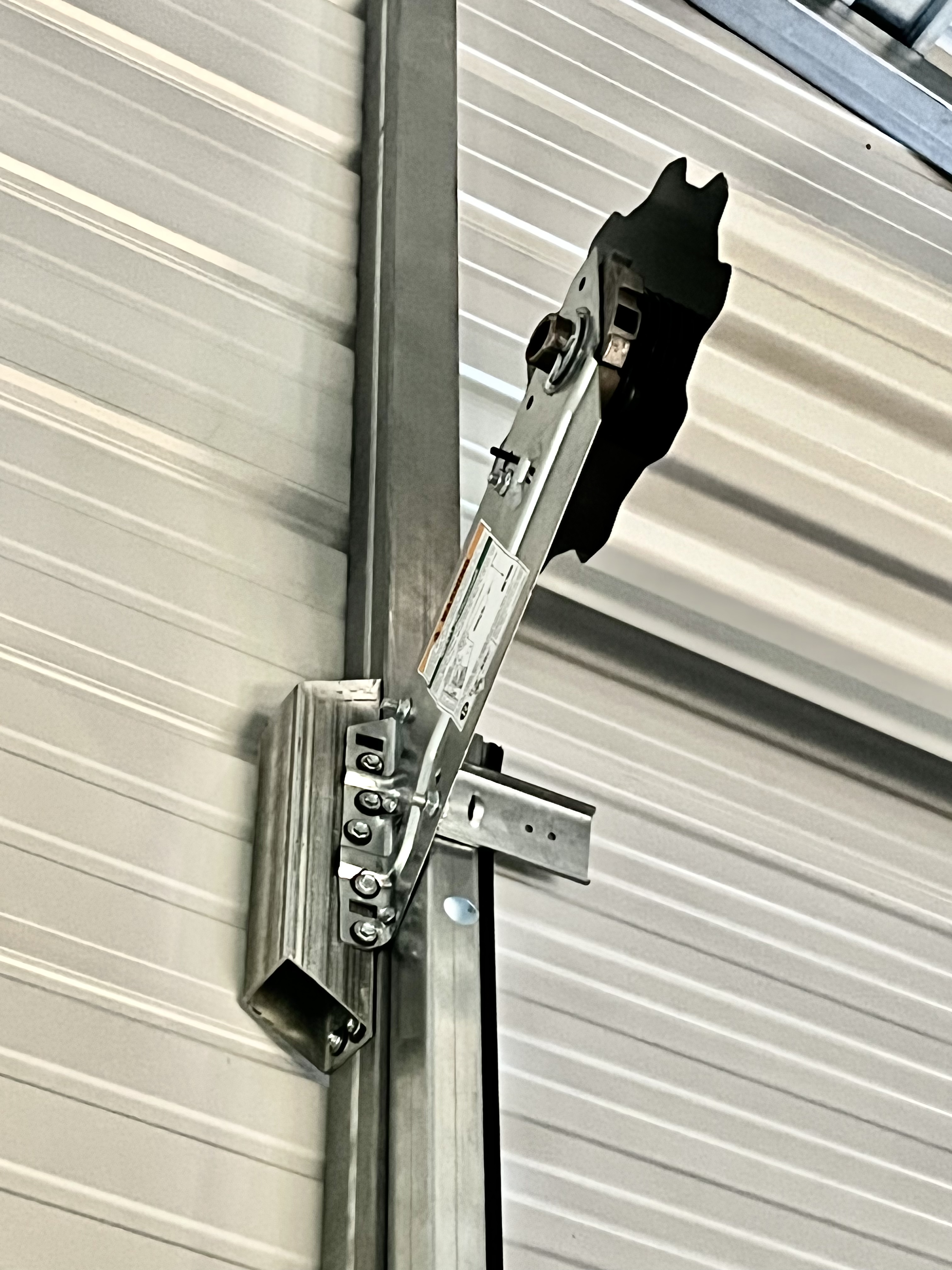

My new garage has 10x10’ rollup doors and I’m wondering what kind of electric door opener I should get. I’m really not familiar with these kinds of doors.
Any suggestions?

My doors are rollup as in a roll and not in panels. They don’t have rollup tracks. They seem very straightforward.
I think this is what I need.
https://www.amazon.com/Electric-Opener- ... YXRm&psc=1
