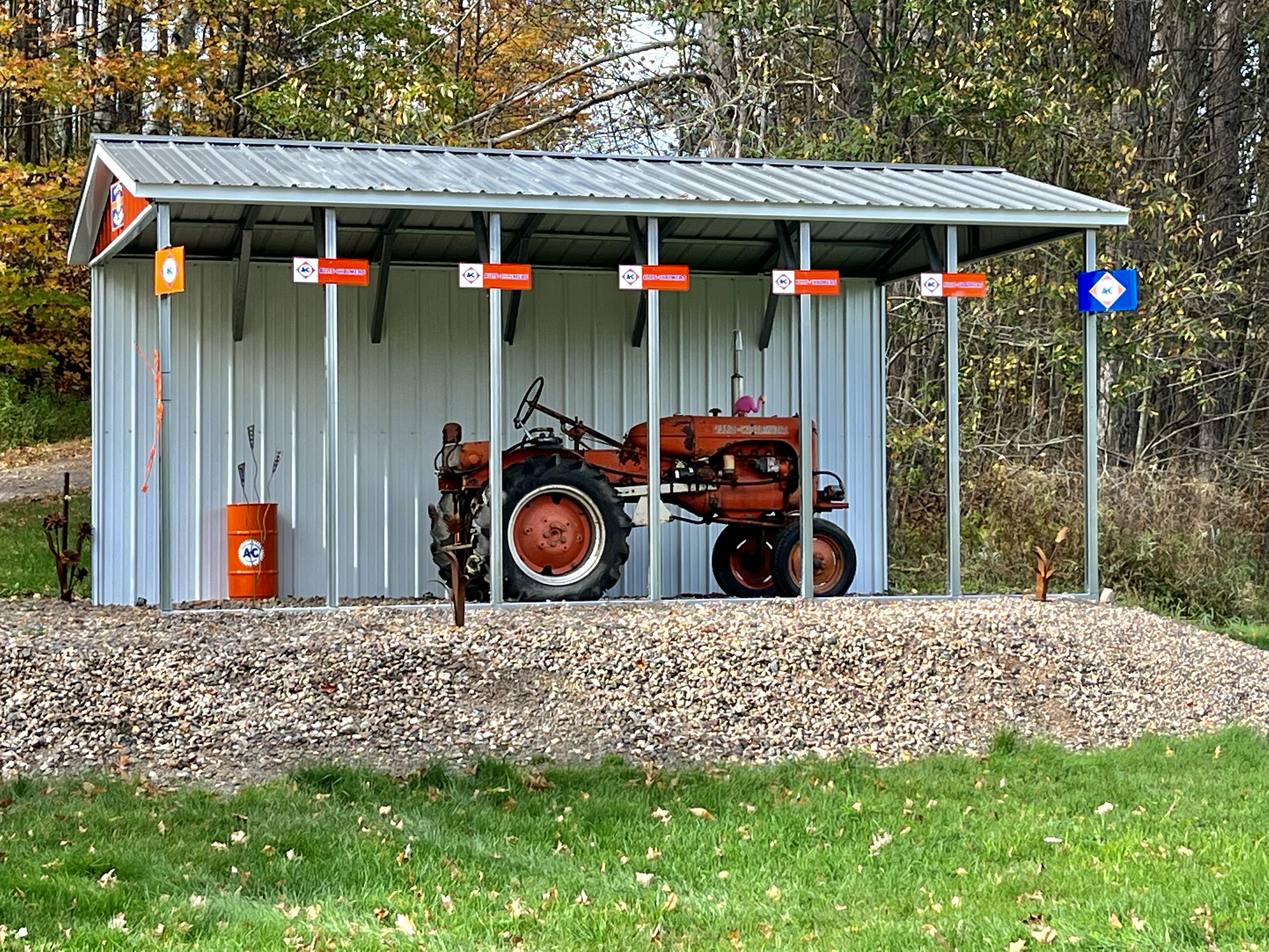

I’m getting an estimate for a 120v 20 amp underground feeder line to Alice.

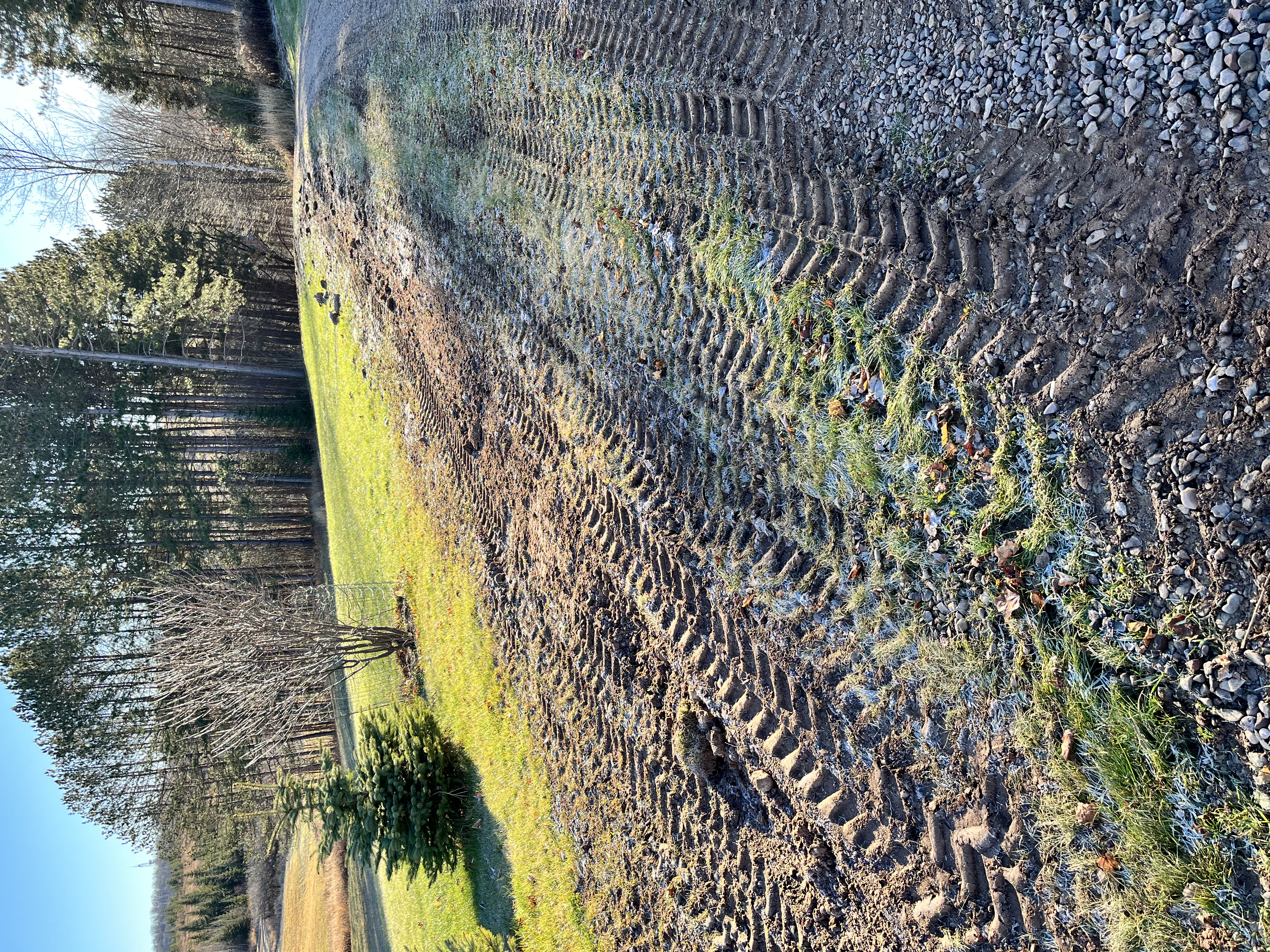

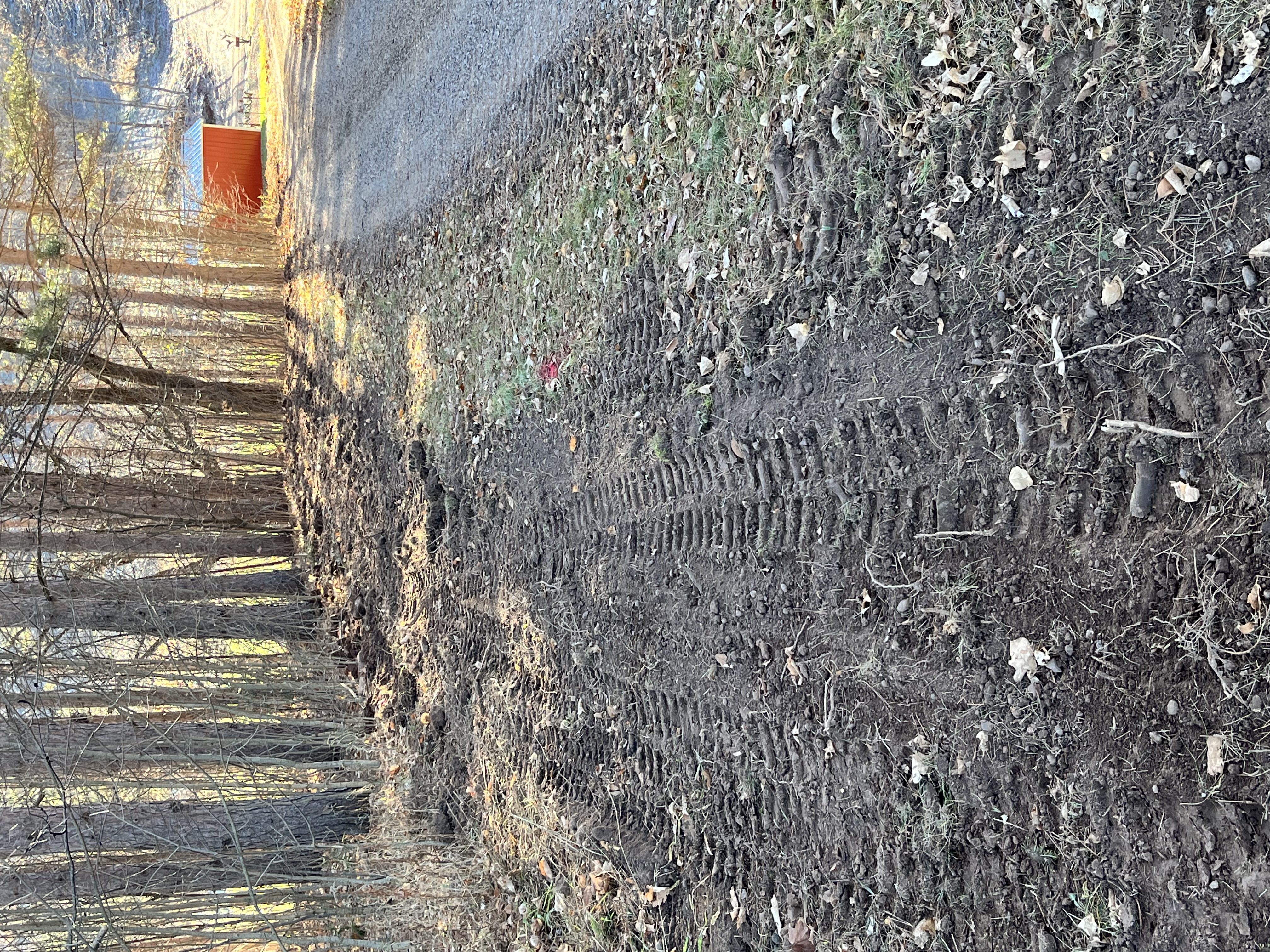

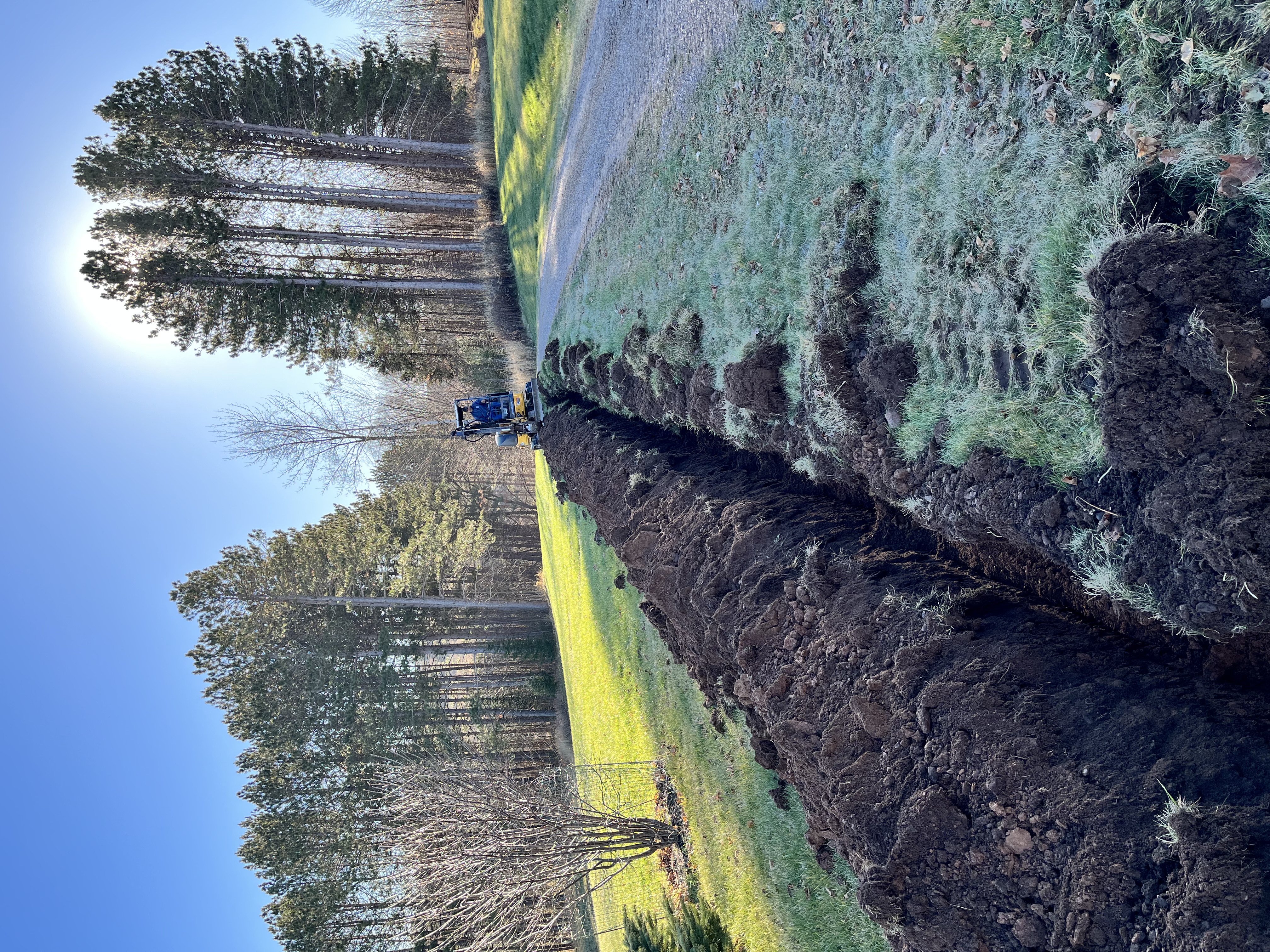

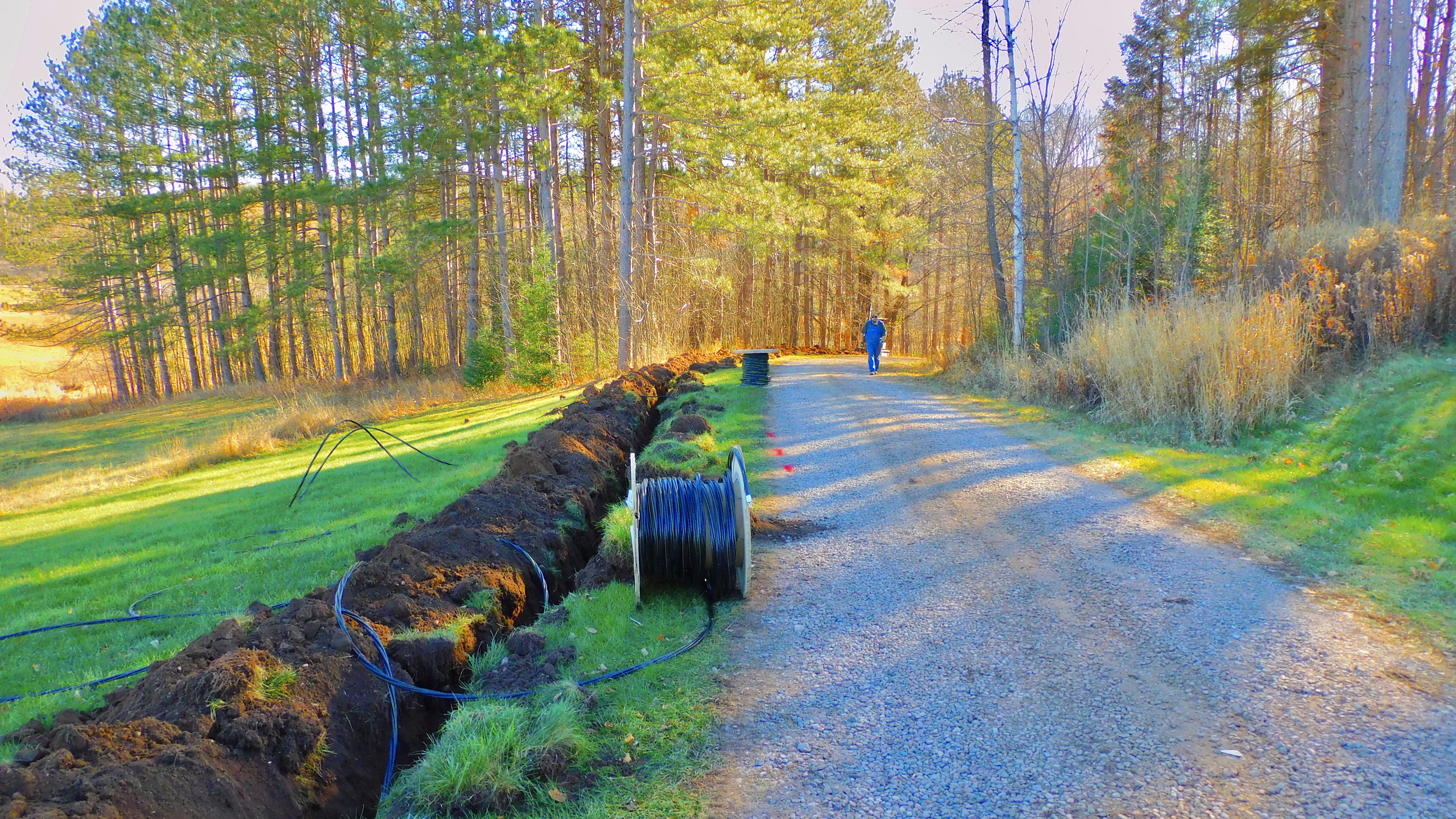

The trencher is coming Saturday so I should have power to the tractor shed by next week. They will also trench to the top of the hill and lay the line. I’ve contacted a neighbor to bulldoze the road and it might also be done in a few days. Then everything will sit over the winter till it’s warm enough to pour concrete. A month later I’ll be having a metal garage that’s 30’x72’ and a lean-to that’s 12’ wide and 36’ long installed.
This is the view from directly in front of the RVport and the road will go straight in front of it for about 100 yards.

I hung some party lights down by Alice this morning. I’m still scheduled to have the trenching done Saturday and the wires hooked up on Monday. These party lights are the same as I have on the house and garage.

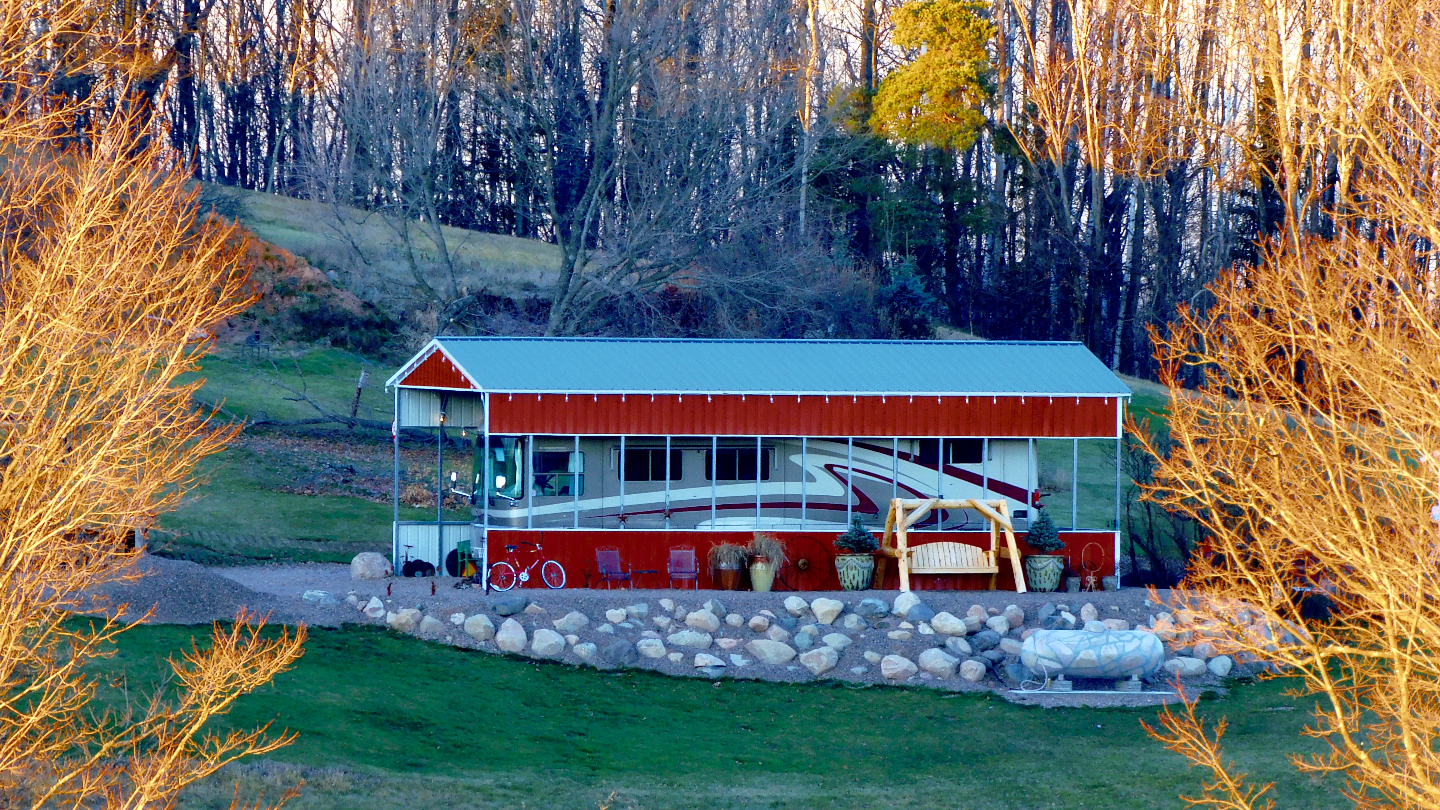

A neighbor just stopped by and told me my RVport really looks nice from the road. We walked around and I showed him my propane tanks, we went inside the RV then walked up the hill where the garage is going. Everyone is telling me I’m doing a good job fixing the place. Actually I’m not fixing it but rather completing it.
