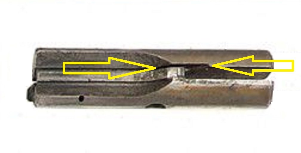

Armalite AR-7 bolts have a groove (ejector cut) machined into them which allow the bolt to be removed from the receiver without removing the side cover and disassembling the entire fire control group (FCG).
Bolts from Charter Arms do not have an ejector cut. Bolts from these rifles cannot be removed without removing the side cover and disassembling the FCG.
Bolts from Survival Arms AR-7’s have an ejector cut.
Bolts from the HRA 1st Generation AR-7’s do not have an ejector cut. Bolts from these rifles cannot be removed without removing the side cover and disassembling the FCG.
Bolts from HRA Gen 2, 3, 4 AR-7’s have ejector cuts.
The photo above is of a Survival Arms AR-7 Bolt. The arrows indicate the ejector cut.

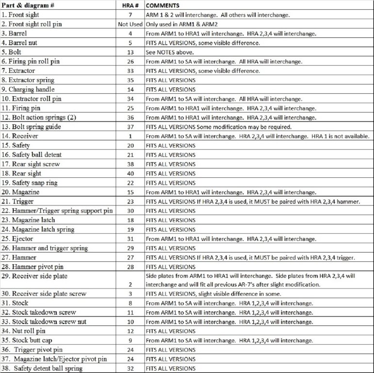

KEY TO INTERCHANGE CHART BELOW
Armalite 1st Generation = ARM1
Armalite 2nd Generation = ARM2
CHARTER ARMS = CA
SURVIVAL ARMS = SA
HENRY REPEATING ARMS GEN 1 = HRA1
HENRY REPEATING ARMS GEN 2, 3, 4 = HRA2,3,4
FITS ALL VERSIONS = SAME
ALSO:
1. In the chart below, HRA # is the part number as shown in Henry Repeating Arms catalogues.
2. If you read “From ARM1 to HRA1 will interchange. HRA 2,3,4 will interchange.” this means parts from the first group will interchange and parts from the second group will interchange, but parts from the first group and second group are different and will NOT interchange.
3. “Some visible difference.” means the part may have a visible difference from the original part, but it will function as the old part did.
4. “Slight modification” means that after some modification the new part will function as the original part did.
PARTS AVAILABILITY
As the chart above shows, many of the parts for today’s Henry Repeating Arms AR-7 will fit rifles going back to the original Armalite AR-7 and are available from HRA at reasonable prices. There are notable exceptions. HRA no longer makes barrels, firing pins, receivers, magazines or original 2-magazine-stocks for it’s first generation AR-7’s. Fortunately, there are some suppliers, notably AR7.com, who stock these items.

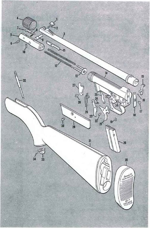

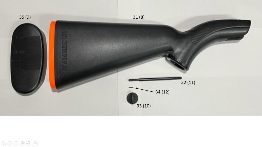

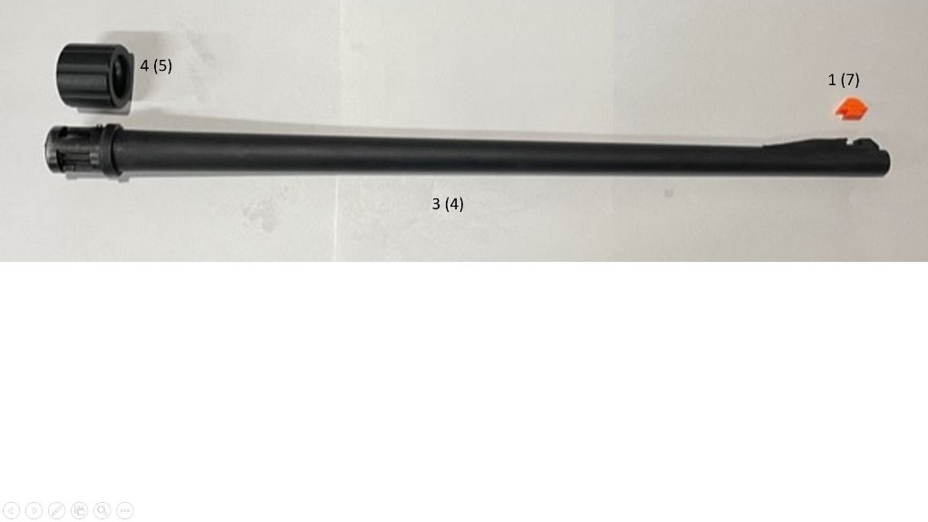

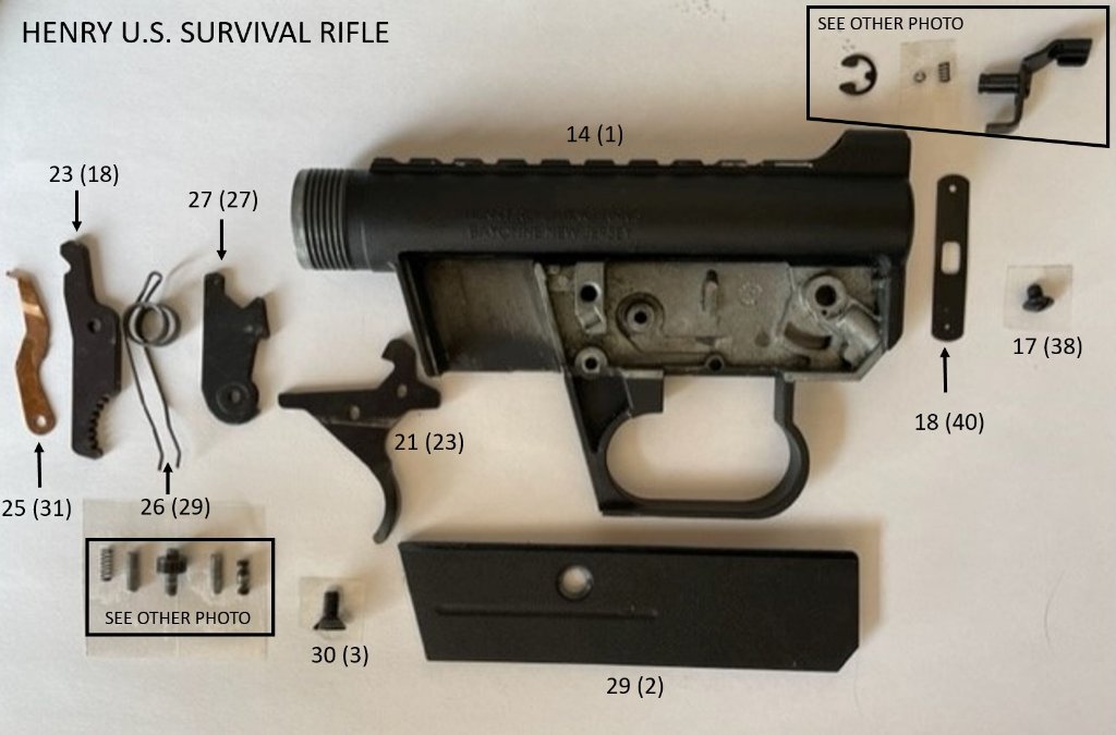

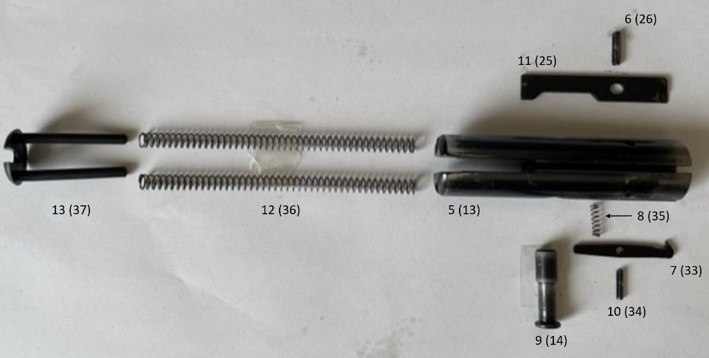

Re: AR-7 RIFLE PARTS INTERCHANGE

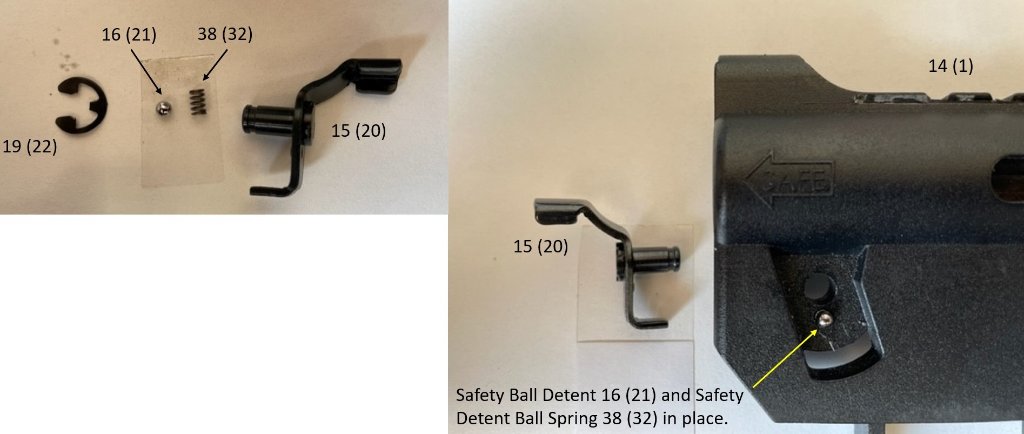

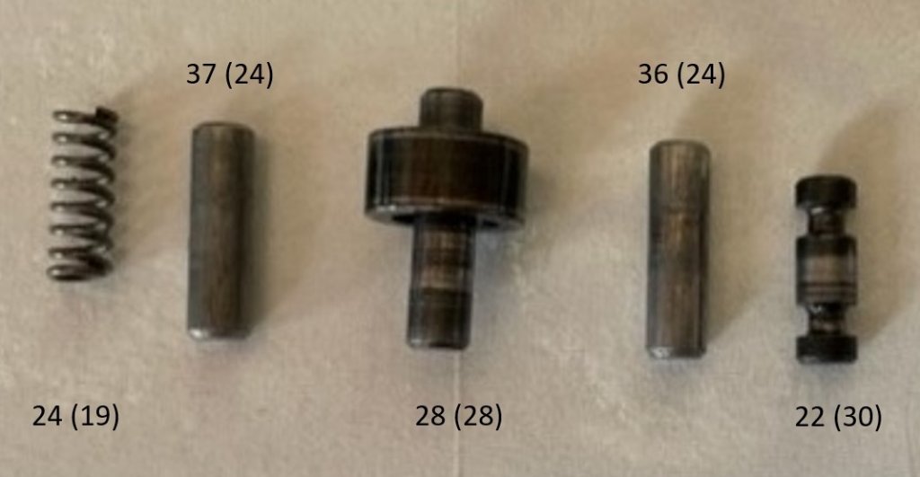

Attached are some photos showing the parts from a Henry U.S. Survival Rifle manufactured in Bayonne, New Jersey. This rifle has the model number and serial number marked in white on the receiver so this rifle is what I consider to be a Generation 3 Henry rifle.
Where numbers are shown on the photo the first number corresponds to the Part and Diagram number listed in the AR-7 Parts Interchange Chart provided by BMCTED in Post 1. The number in brackets corresponds to the HRA # listed in the AR-7 Parts Interchange Chart.
NOTE: This rifle has just over 6,000 rounds through it and is still running fine. All parts are original.
- AR-7 Parts_1.jpg (84.87 KiB) Viewed 17888 times
- AR-7 Parts_4.jpg (48.97 KiB) Viewed 17888 times
- AR-7 Parts_3.jpg (54.28 KiB) Viewed 17888 times
- AR-7 Parts_2.jpg (52.51 KiB) Viewed 17888 times
The first number corresponds to the Part and Diagram number listed in the AR-7 Parts Interchange Chart in Post 1. The number in brackets corresponds to the HRA # listed in the AR-7 Parts Interchange Chart.
- AR-7 Parts 5new.jpg (44.16 KiB) Viewed 17875 times
- AR-7 Parts_6new.jpg (25.94 KiB) Viewed 17875 times
