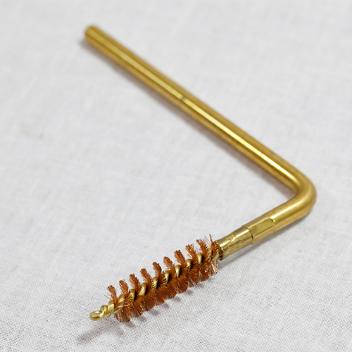

It amazes me with all these opinions on cleaning or not cleaning no one ever seems to mention the "dreaded carbon ring" which is a killer on 22 accuracy and notorious for being the cause of the first shot flyer. Maybe that is why I have little to zero problems with the first shot flyer because I clean my rifles more often. The chamber and just a head of it should be cleaned for better results with your 22's. They even make special tools just for removing the carbon ring. If you don't want to clean your barrel you should at least keep up with keeping the carbon ring at bay.

Post by Lyman » Sun Nov 18, 2018 11:41 am
Good point Bandit1250, Not mine but I made one like it.

Lyman wrote:Good point Bandit1250, Not mine but I made one like it.
I had a rifle that shot around corners that took a brush like that.
