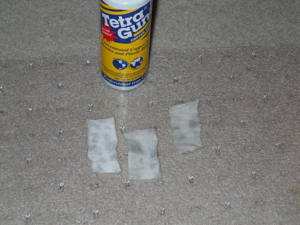

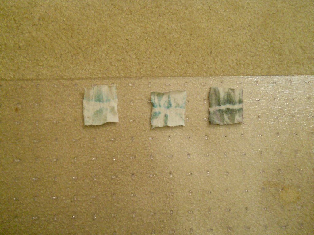

Before and after pictures using Tertra:
P.S. x 2
Note: Patches are after cleaning with Hoppe's No. 9 (i.e. before and after using Tetra).

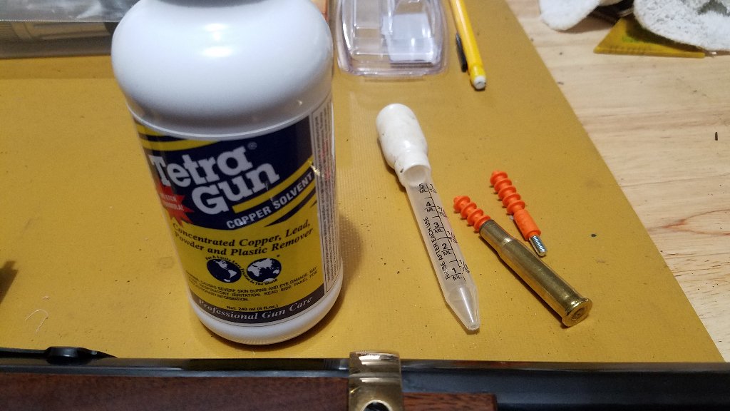

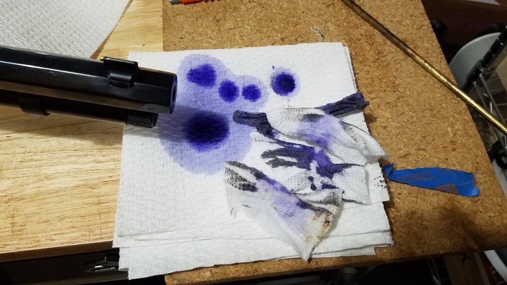

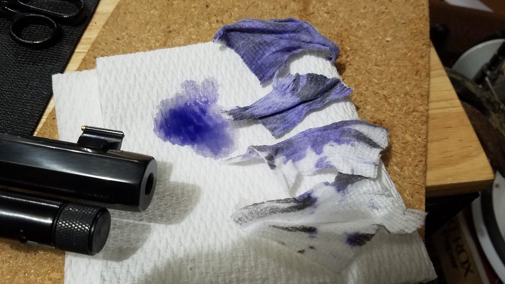

The bore squeeg-e's came today. I put one in a brass casing and fed this one into the breech to plug the barrel at the receiver end. Using the medicine dropper squirted 1/2 tsp of Tetra Gun into the muzzle followed by the other squeeg-e to plug the muzzle. I then rotated the Henry in various orientations to distribute the Tetra Gun throughout the bore. Let it soak for 20 minutes. Then with dry swabs cleaned it all out and repeated the process a 2nd time.
I got a lot of purple. I was not expecting purple. I don't know what to make of the purple. What is purple, I was expecting bluish green.

Post by JEBar » Wed Aug 01, 2018 12:04 am
what color is the solvent :?:
if not purple, could it be a chemical reaction with the last cleaner/lubricant you used :?:

The squeegee is very interesting. I may have to try one. I typically get a purplish tint as well. I just keep cleaning until it is pretty much gone. I also used a brass brush and tornado brush as well. As I recall, I spent a couple of days initially on the process. I worked on it a few hours each day. Now, I may spend a couple of hours one day (soak time mostly), and an hour or do the next day. I seem to get a purple color patch (like yours) on the next day as well. But, the next few patches are clean. Then, I check the barrel with a bore light. Once I see no more copper, I am a happy camper. I would just keep cleaning and use a bore light to check my progress. It seem like you are making progress. Just may have been a lot of copper fouling in the barrel.
