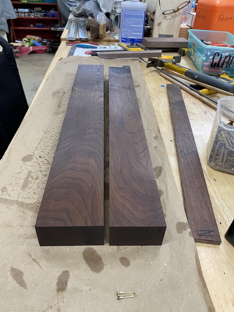

Back out for an hour or so. Sanded down the knot and then the tops of both pieces of walnut to 600 grit. Then sanded the end face that will show thru 600 grit as well and LIGHTLY rounded the edge so you won't cut yourself on that sharp edge. Then I wiped them down with Mineral Spirits to remove all the sawdust, check the grain, and check for scratches or defects. Looks good.
47 checking the grain.jpg (342.87 KiB) Viewed 5182 times
Here is that Hole I had been filling. After FIVE cycles of fill and sand, this is the result. If it was a presentation box I might have gone SIX. :?
48 five treatments later.jpg (477.33 KiB) Viewed 5182 times
I will make up a test strip and test the Natural, Medium Walnut, and dark walnut Watco Oil, then compare them to the countertops. Closest Match wins. Then I'll stain the walnut slabs and start the assembly.

HERE is that test strip I made from a cut off of the original live edge slab the walnut was cut from for THIS project, and the two slabs that have now had the Dark Walnut stain applied and been left to cure. I chose the Dark Walnut because they all appeared to be about the same shade, but the dark walnut appeared to bring a greater contrast between the lighter and darker areas in the grain.
51 test strip and cutting board tops.jpg (323.96 KiB) Viewed 5171 times
