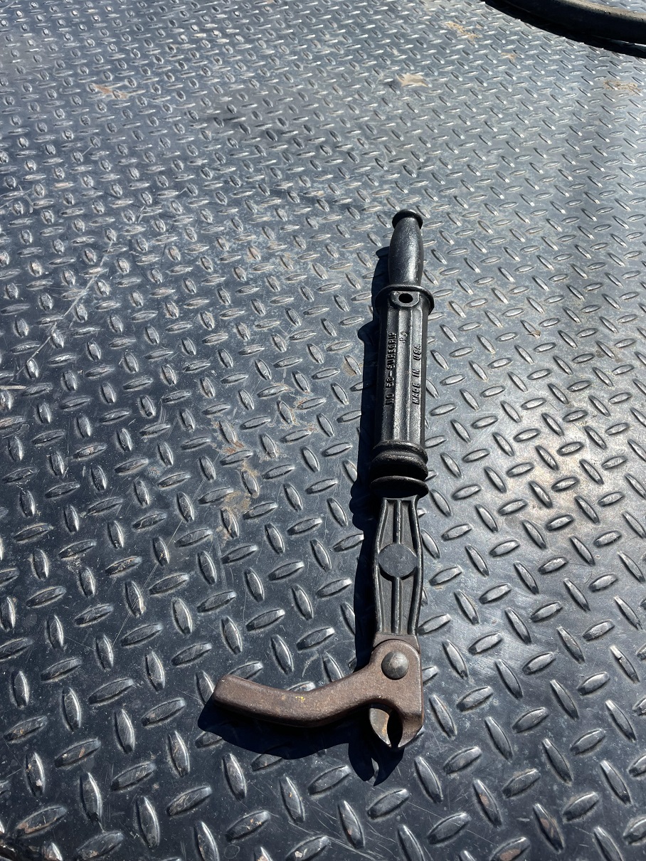

I mentioned the "Antique Nail Puller" in an earlier post. For those who like old tools, here is a picture of the tool.
antique nail puller.jpg (616.31 KiB) Viewed 7 times
To use the tool, you open the bird beak looking thing at the bottom, placing it on either side of the nail with the tool held vertically. Your hand wraps around the grip just above the beak with the foot pointing toward you and helping to stabilize the tool. The handle at the top of the tool is lifted about a foot then hammered down onto the tool in a sliding motion. The teeth bite into the wood on either side of the embedded nail. Pulling back on the handle closes the teeth on the nail. If you don't get a bite on the nail, you reopen the teeth and reset them on either side of the nail in the same grooves you just cut, and slam it again. Reattempt to bite the nail. Once you have that bite, you can use the leverage of the tool like a crowbar to pull the nail, levering against that foot. Stubborn nail? Extend the upper handle and increase the leverage. :) It will easily pull large nails from stubborn wood.
Once you learn the use of this old thing, you can get good with it and pull most embedded nails with just one or two strikes. The key is proper positioning prior to the first strike and a steady bottom hand so that the tool doesn't move on the down stroke. ;) Slip and strike off target.... move and reposition 90 degrees off or the tool will slide off into the old grooves every time. :roll:
The really important thing is that the lower hand STAYS in the grip area. If any portion of that lower hand rises above that little ridge on the lower grip... :o It's a mistake you only make once. You'll have a huge blood blister at minimum once that upper portion slams down. That pinch can cut the skin. Leaves a cut that looks like scope bite. Don't ask me how I know this. :twisted:
