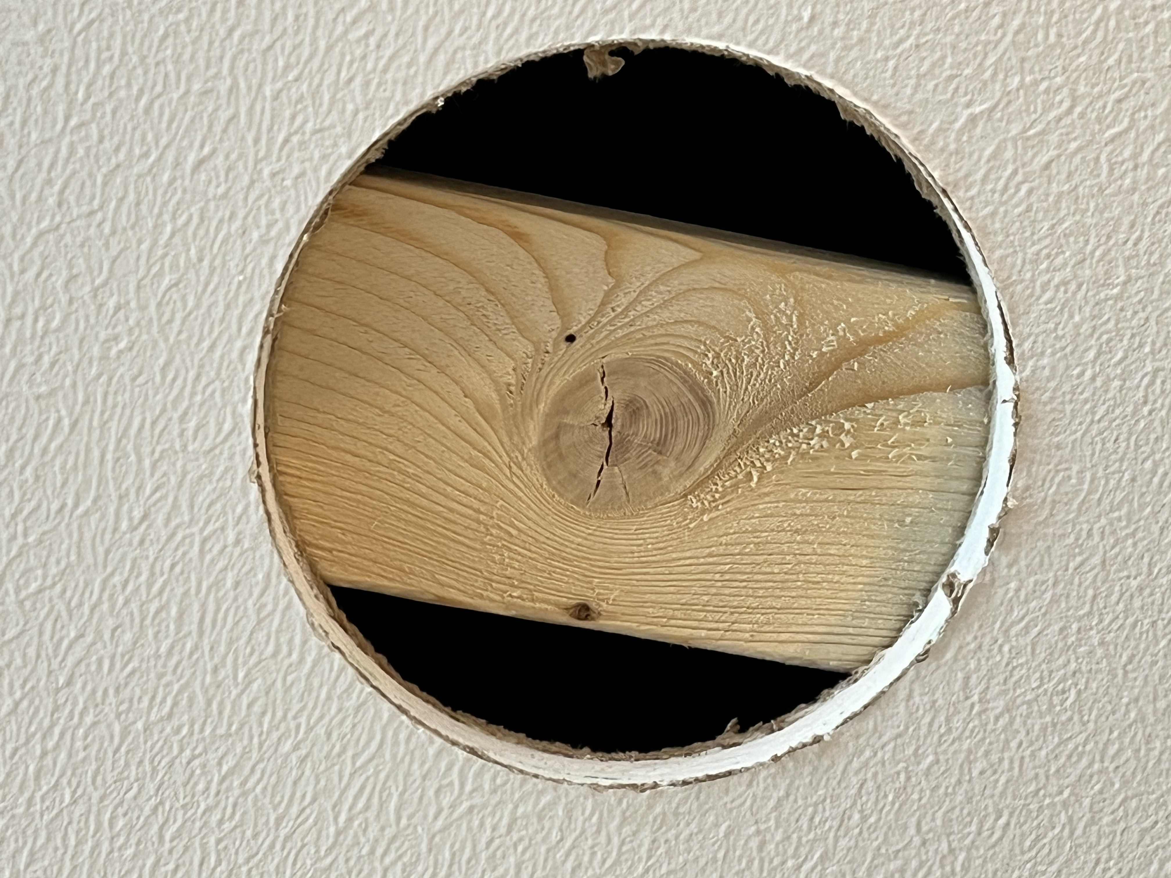

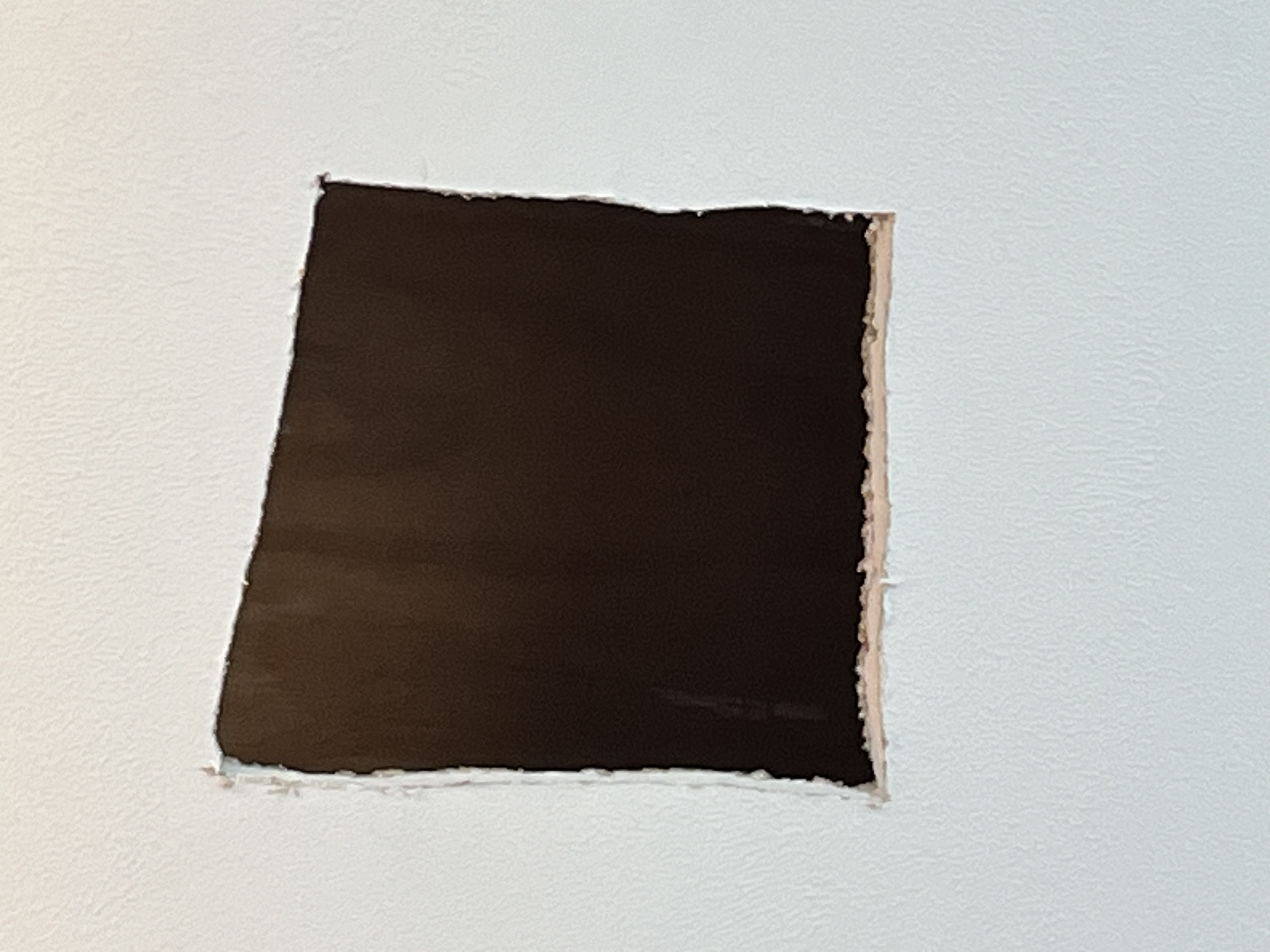

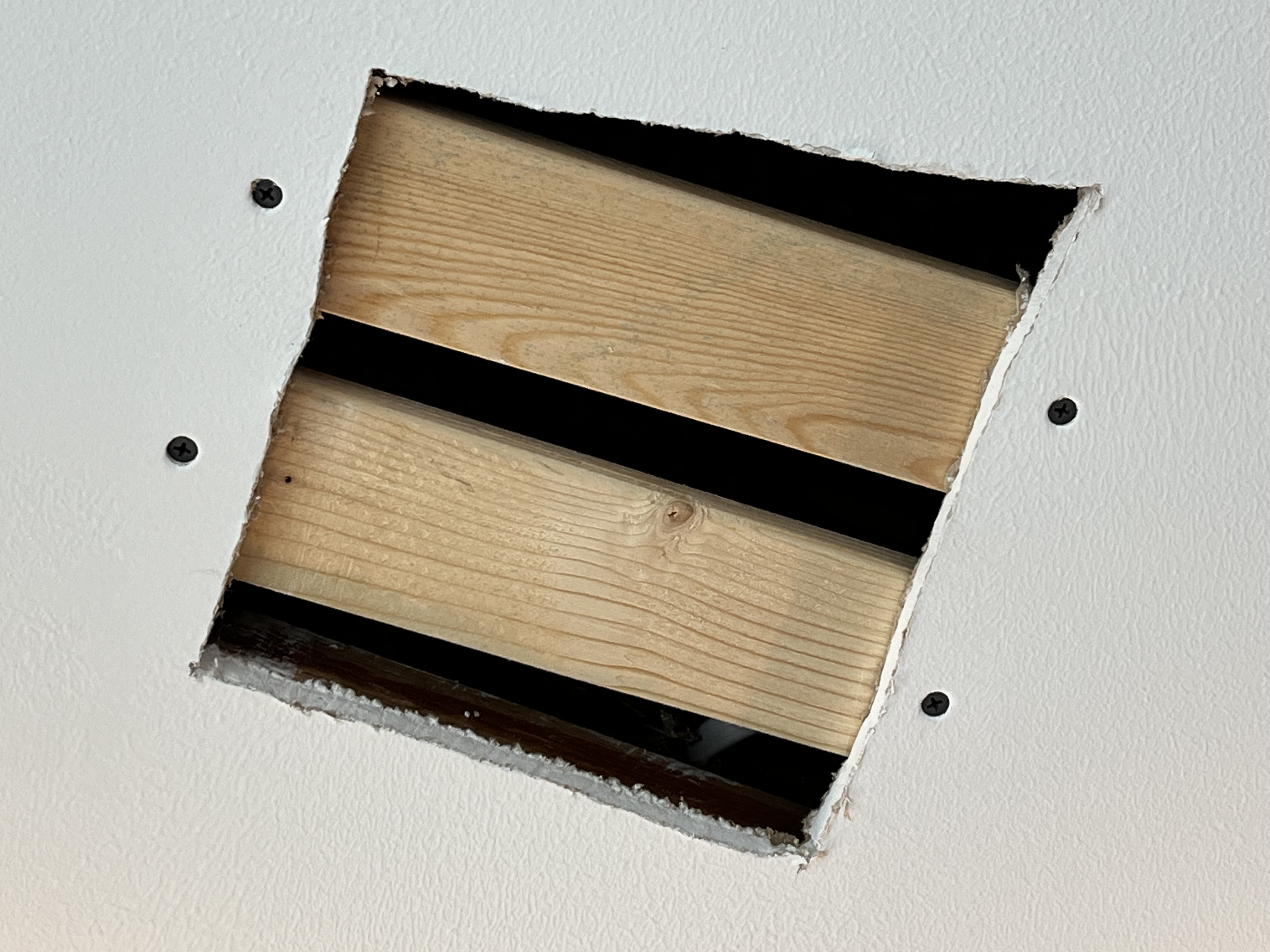

That was the first holes to see what was up there Once he knew he drilled smaller round holes. This was the first.
The second
Then the are small. Remember he had to get a drill up through it.

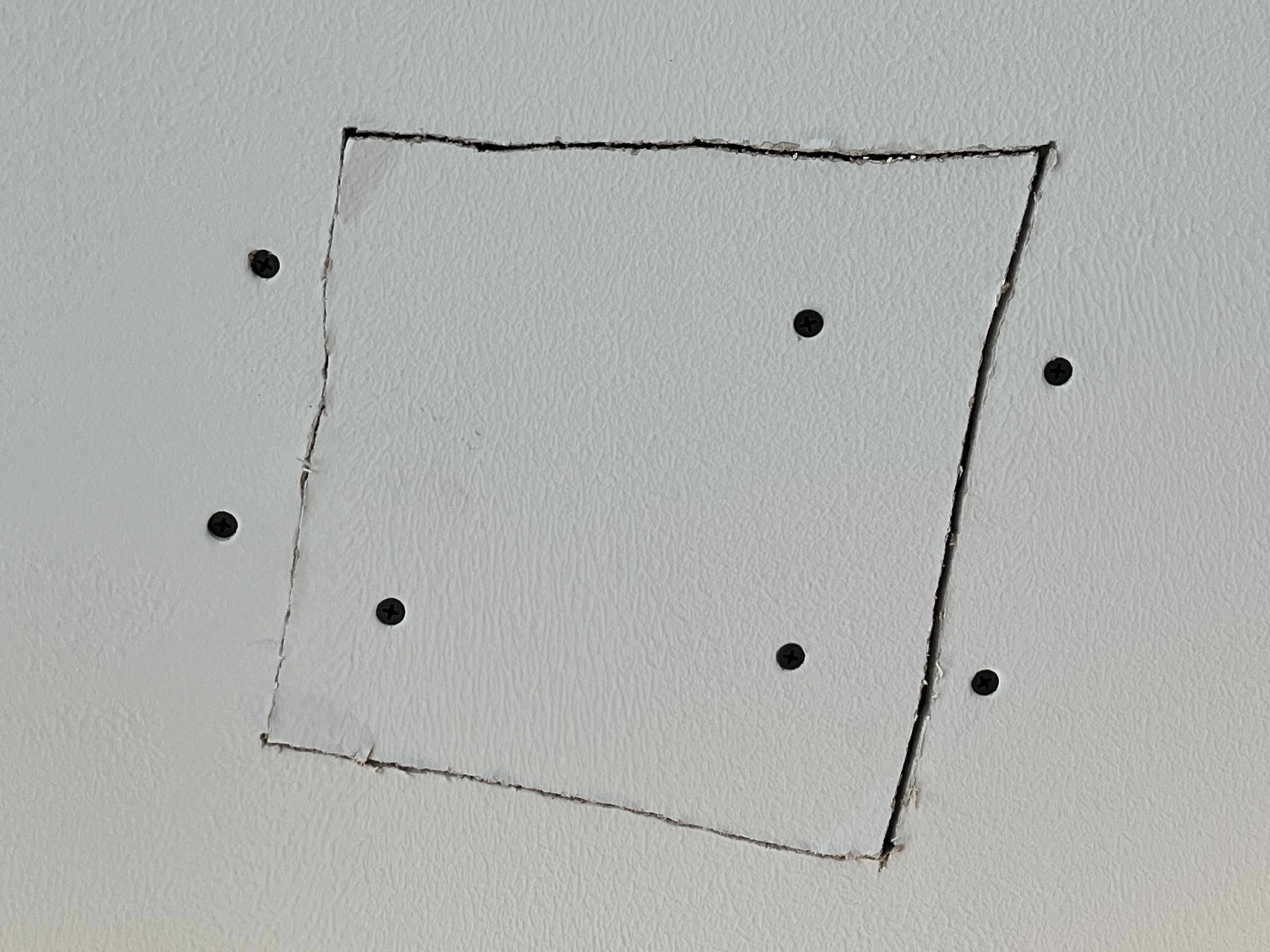

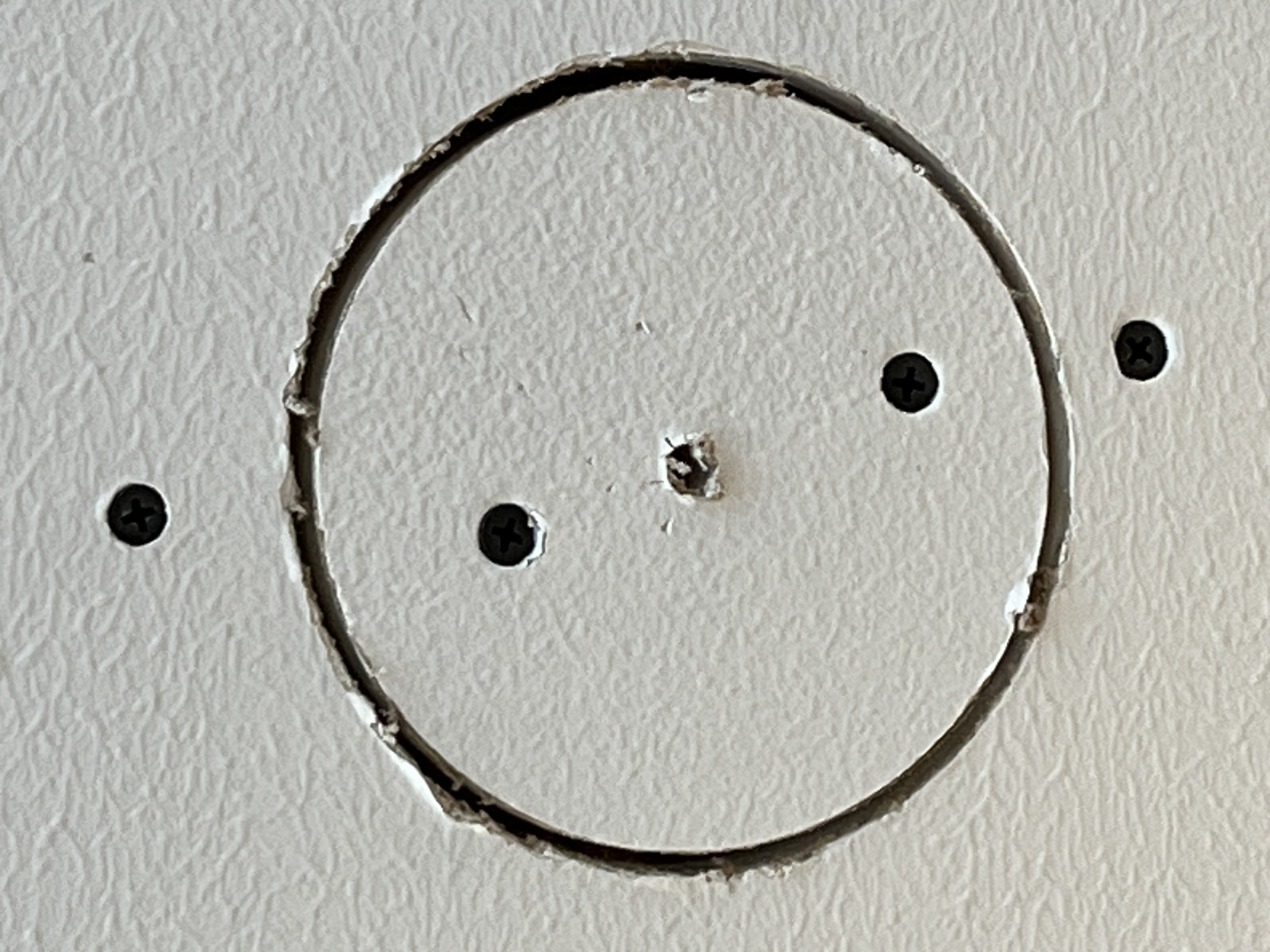

I worked on patching the ceiling yesterday. The first step is to cut a 1x4” board about a foot long and place it in the hole.
Then put two screws into the sheet rock in the ceiling and then into the plugs that were removed.
I saved the pieces taken out and they will fit back in perfectly.
I have more time in taking the pictures and posting than I do thus far.
I still have one more screw and then of course the mudding.

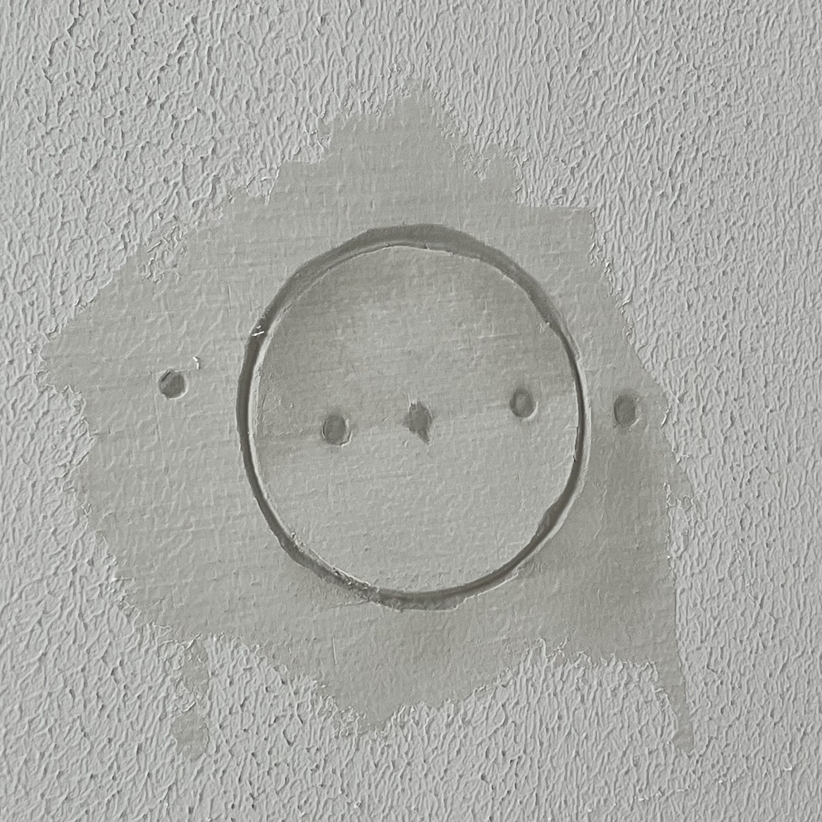

I did some filling today. I estimate it will take me three fills to get it right. The picture was taken when it was still wet. The gaps now are much lighter.
When it’s completely dry I’ll take a damp cloth over the excess and then fill the gaps in again.
