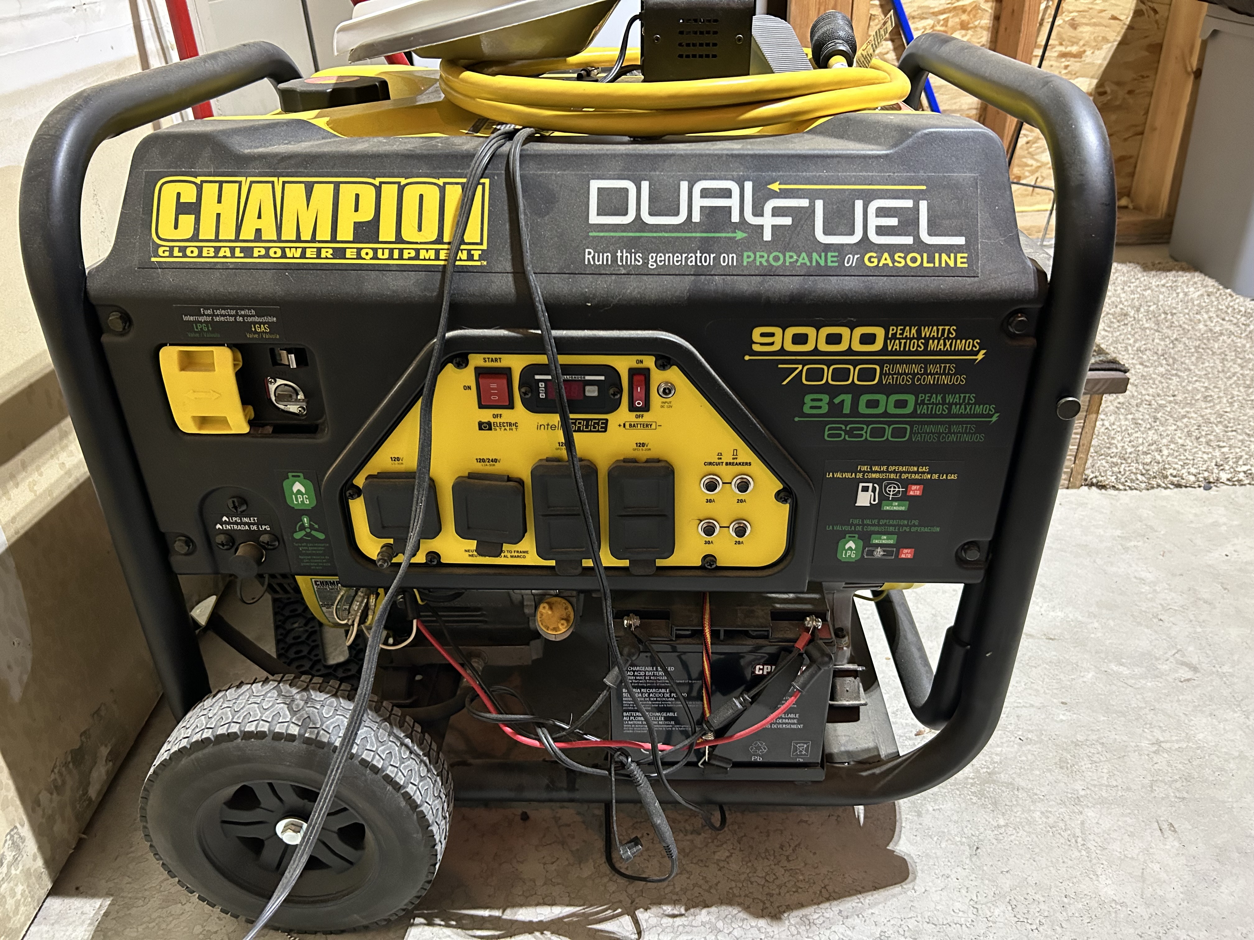

I have this Champion generator I bought from Costco on sale for around $700 as I recall. I keep it in the garage and move it outside when needed. I try to remember to run it for 15 minutes with a load once a month. Once a year I change the oil and using a squeeze ball siphon I remove the gas and put fresh treated gas in it. The old gas I just put in another vehicle and burn it up. This is not an inverter gen but Costco does sell those too but not as powerful as this one.

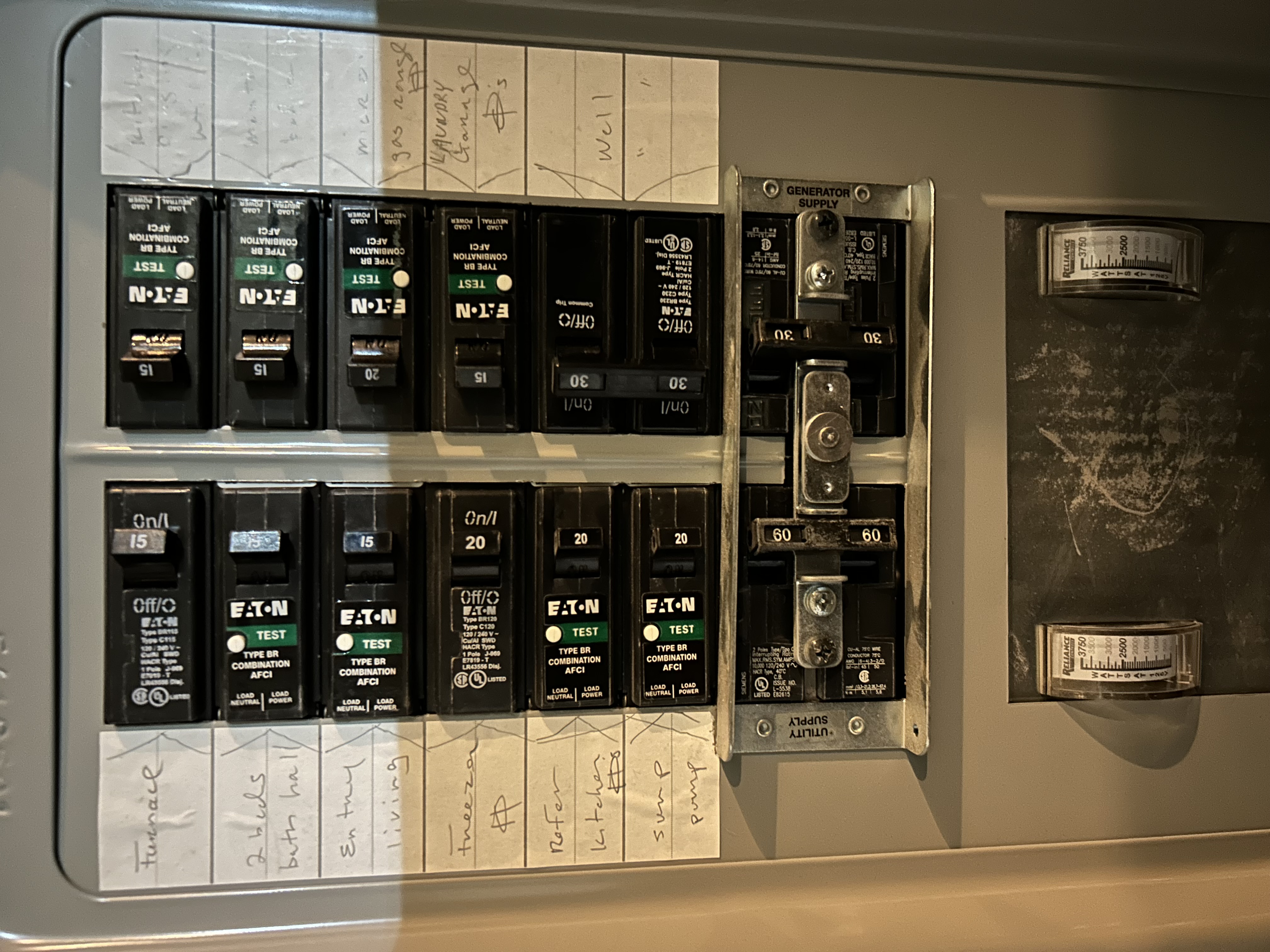

I had the opportunity to have a side panel installed by the electrician when the house was built. I already had the gen so the electrician was able to choose the circuits most important to me and stay within the limits of the gen. I can’t run my electric water heater or clothes dryer but my furnace is gas so it will run the blower.
It gets expensive but a generator side panel can be installed to an existing home. My son had this done but I don’t recall the cost.
Good luck with your decision and as you know anything can help even if you’re running extension cords to critical appliances. Even a 2K Honda Al mentioned. (Been there :lol: )

How noisy is it?

Very loud. It’s an open frame contractor unit nothing you would want to use in a campground. For me I don’t have any close neighbors so the noise only bothers me. In fact, when we have an outage I can hear others generators running but it’s not very loud.

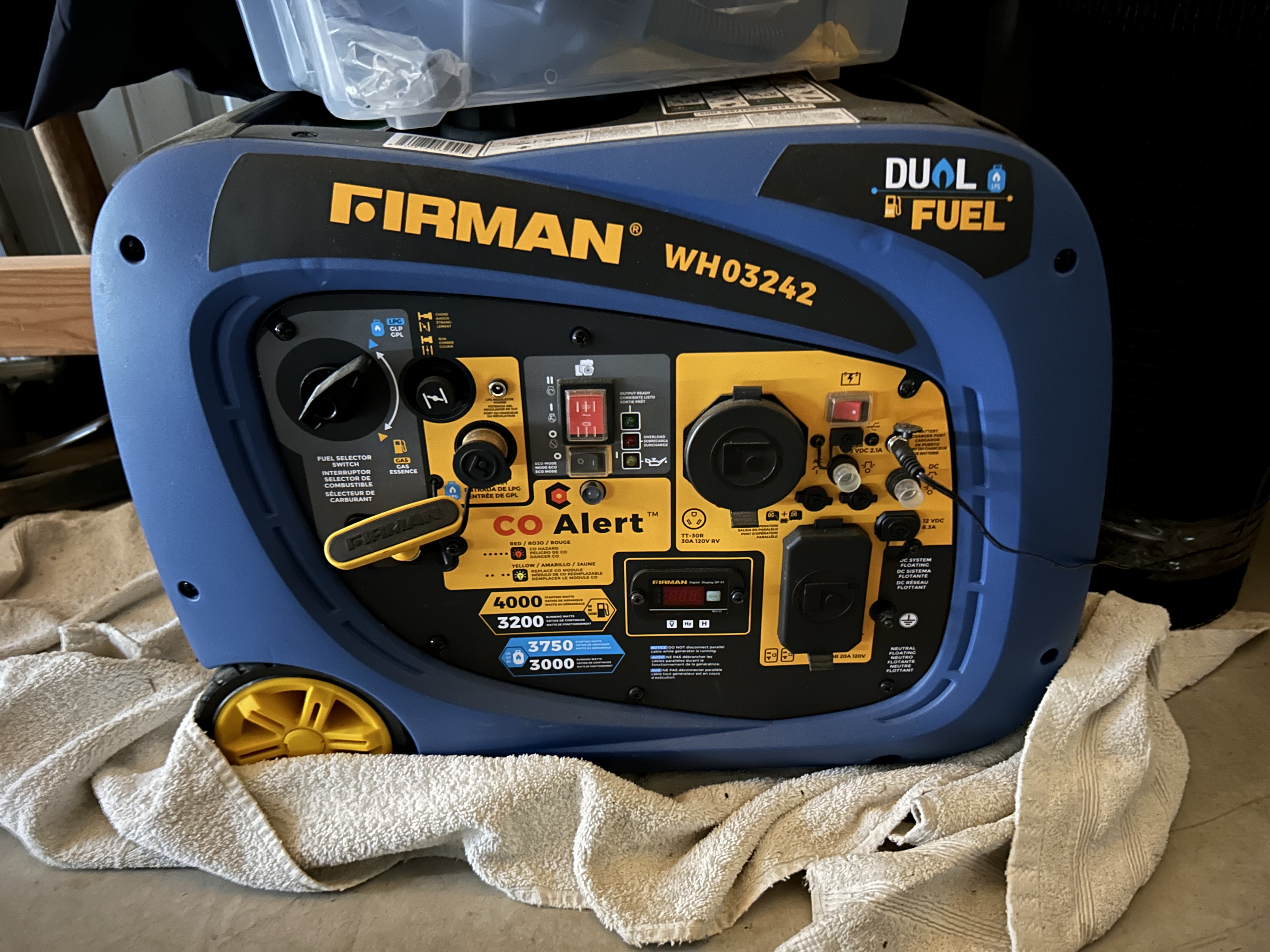

I have this one that I also bought from Costco to use with my travel trailer. It’s powerful enough to run the 15,000 A/C on the trailer and is campground quiet plus it’s an inverter. I no longer have a need for it and too bad Mark doesn’t live closer, I would make him a good deal on it.
