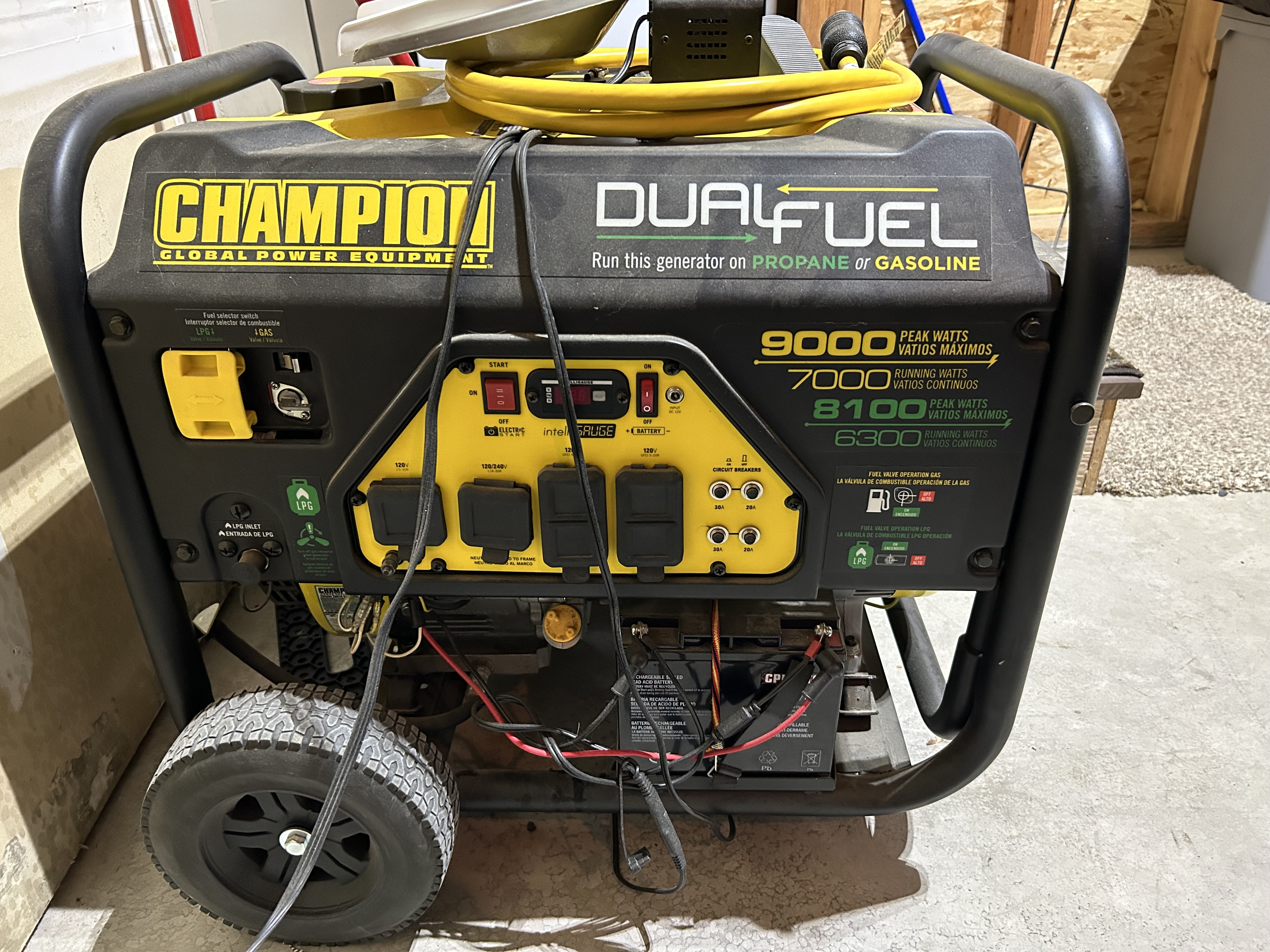

I have this Champion generator I bought from Costco on sale for around $700 as I recall. I keep it in the garage and move it outside when needed. I try to remember to run it for 15 minutes with a load once a month. Once a year I change the oil and using a squeeze ball siphon I remove the gas and put fresh treated gas in it. The old gas I just put in another vehicle and burn it up. This is not an inverter gen but Costco does sell those too but not as powerful as this one.

Thanks Hatch...yet more great information. I too was thinking extension cords for emergency use. That would definitely keep the initial costs at a minimum.
The pics are appreciated as well.
Re: Preparing for Next Time
How noisy is it?
Very loud. It’s an open frame contractor unit nothing you would want to use in a campground. For me I don’t have any close neighbors so the noise only bothers me. In fact, when we have an outage I can hear others generators running but it’s not very loud.
