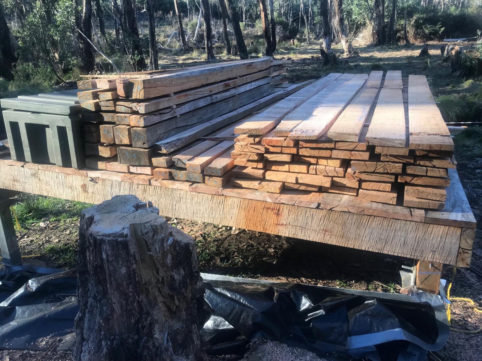

Current timber I have milled and sawn, mix on the left some 8x4 for beams 4x4 post but mainly 4x2 for framing, boards on the right more than it looks as there is nearly 150 lineal yards.

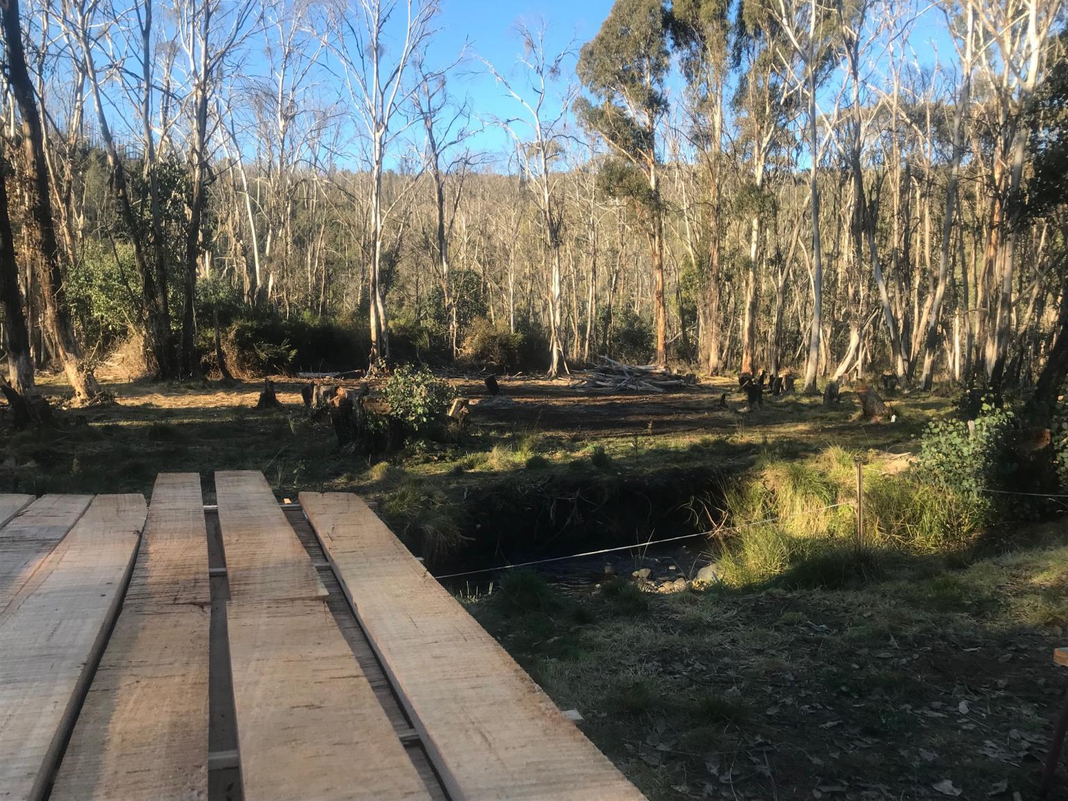

Looking across the creek from what will be the front of the hut where I have been clearing

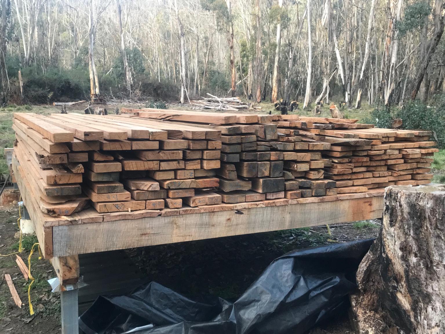

Ended up carting and stacking the rest of the timber I have milled the past week at the hut site today.
Snapped a progress picture for anyone interested, it is starting to look like an impressive pile now

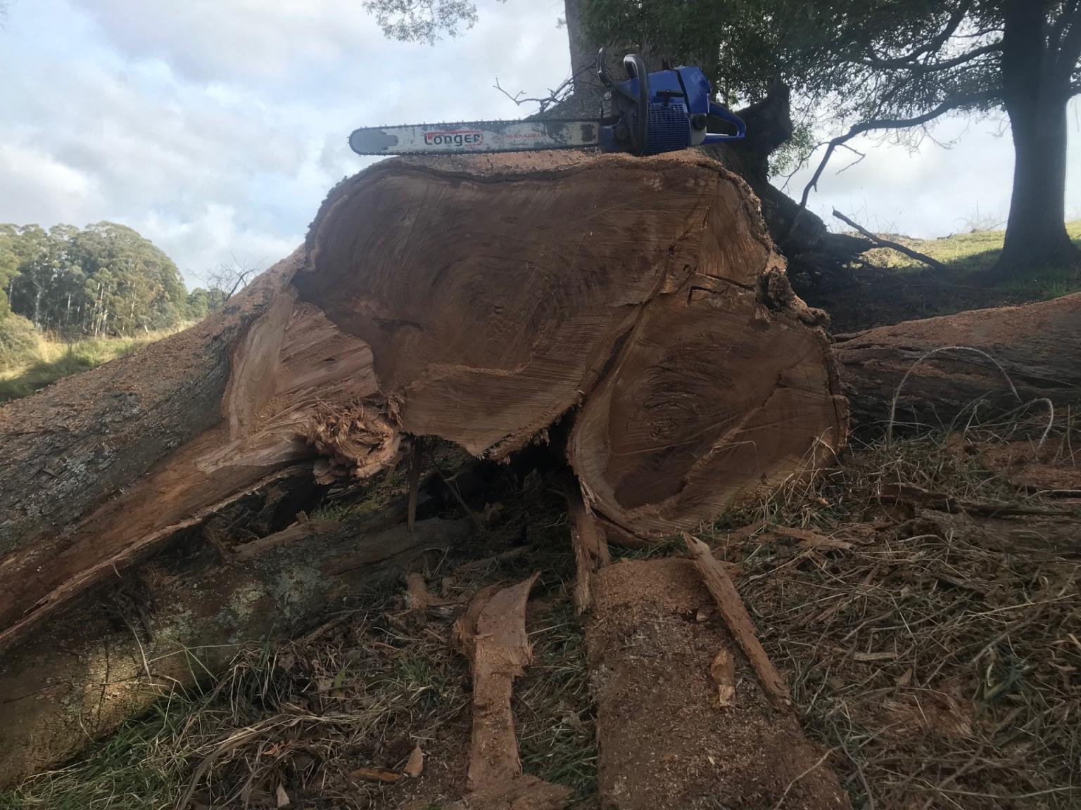

My blue thunder chinese MS660 clone was only just enough saw to get the last few logs today.
92cc saw with a 30" bar, didnt run a tape across it but would be about 5 feet across, only gets bigger for the remainder of the trunk.

Wow, 30" x 2 = 60" ÷ 12" = 5'. You were definitely at the limit for that saw, impressive.
