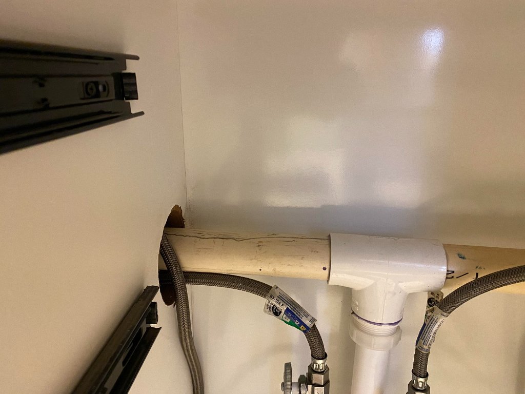

If you look at the snarl of plumbing the former owner and his dad installed, you'll note that they did NOT add shutoffs below the T's splitting the lines going to the individual sinks, so you can't turn the water off to both sinks at once, NOR can you remove the countertop and sinks, without turning off the water to the entire house. In addition, the crowding of the pipes after gluing, made it impossible to turn off the right hand sink hot water, which was the ONE that was leaking. Not helpful. Had to turn off the hot water to the house unless needed. We put a drip pan under the joint until the plumber could arrive.
Also, the drain line from the sinks going into the OUTGOING line into the floor was NOT glued in, it was just stuck down into the pipe. NOT to code.
Look at the picture below, note the drainpipe from the lefthand sink, flowing to the center T, it has a major crack almost the full length across the top. This is the master bath, and it was NOT exposed to the elements. The crack is centered at the top of the pipe. Our plumber figures they installed it that way since it's a drain line and not under pressure. BUT, also not up to code. :evil:
003 cracked drainline.jpg (96.46 KiB) Viewed 6434 times

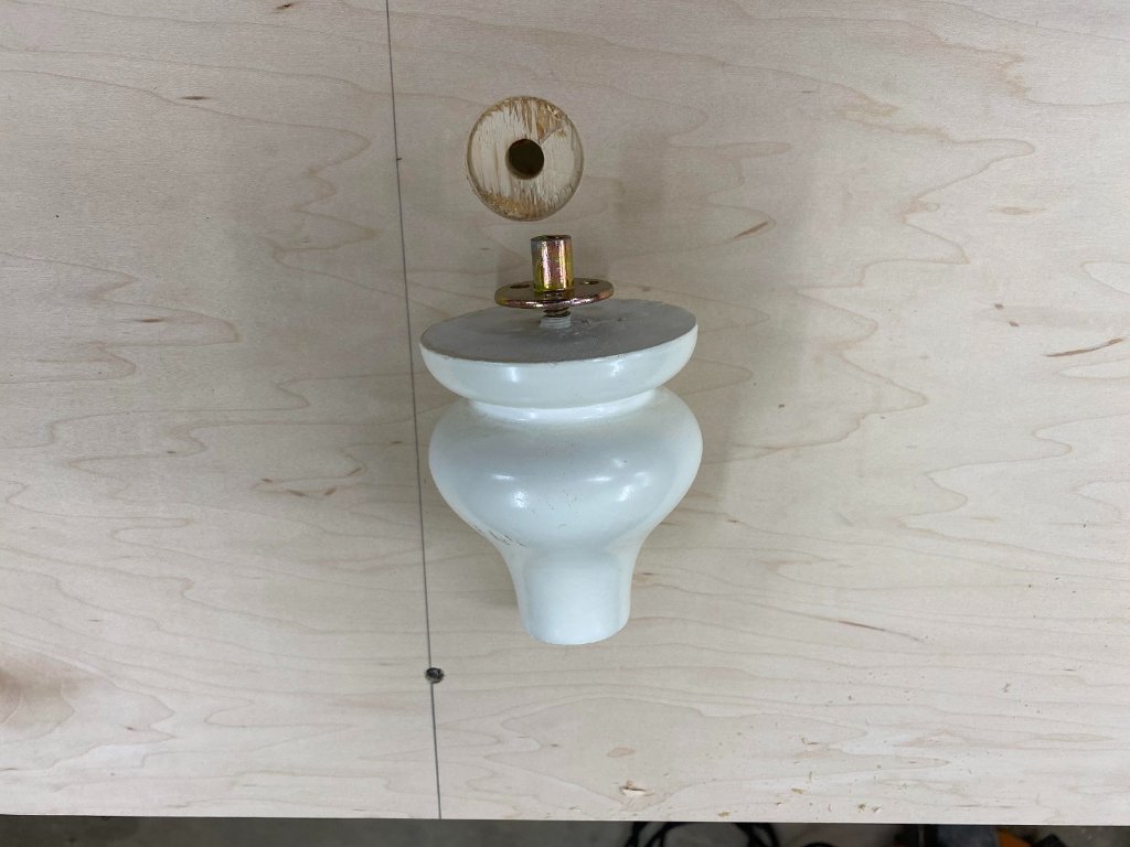

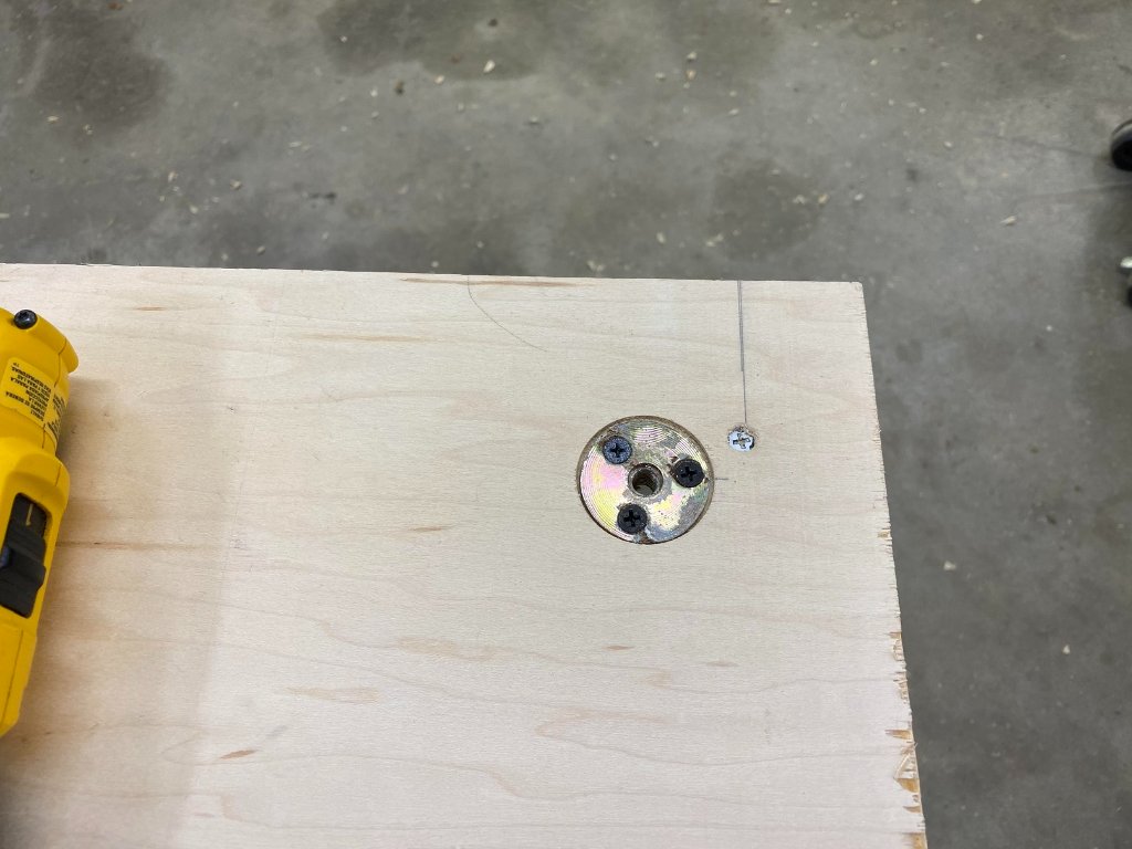

Laid the bottom on the vanity and marked the location of the feet, then drilled the countersinks for the brass threaded bases. Drilled the holes for the threaded portion as well. All that was done with a pair of forstner bits. Then I screwed the six plates in place.
007 countersink feet base.jpg (97.73 KiB) Viewed 6434 times
Here is a close look at the base / foot combo
008 better look.jpg (92.77 KiB) Viewed 6434 times
The base was glued and screwed, carefully marking and measuring the location of each screwhole I drilled before doing so.
009 base glued and screwed.jpg (184.42 KiB) Viewed 6434 times

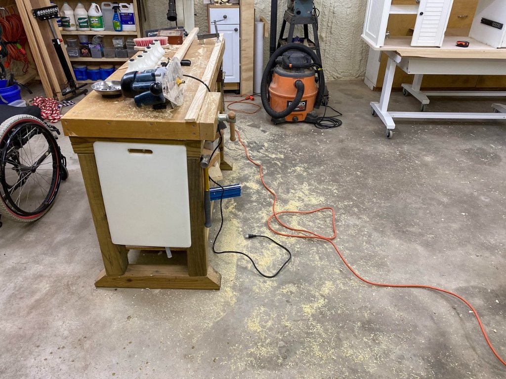

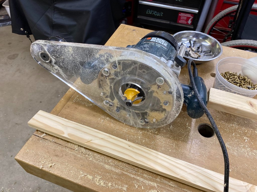

I had planned to make the trim I needed with my molding planes, but after two passes thru the drawer, I couldn't find the profile I needed, so I went thru the box of bits for the router, and there she was. I chucked it in the router, carefully measured the depth needed and set that on the router.
0010 router setup.jpg (199.03 KiB) Viewed 6437 times
I took a piece of 2x4 the right length, with extra, and secured it on the bench, then made a pass across it with the router, then checked the result. The shoulder on the trim wasn't high enough to match, so I reset the depth of the bit to cut a bit deeper and made another pass. Bingo.
0011 routing trim.jpg (219.2 KiB) Viewed 6437 times

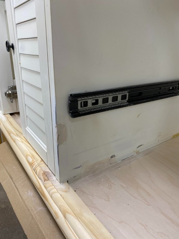

The molding goes into the vanity where the cracked molding / trim was under the cabinet doors and the drawers were at the bottom. You can see the gap in the pic below.
0013 goes here.jpg (135.38 KiB) Viewed 6437 times
When I made the first test fit it was just a bit too tight. It would have been WAY too dangerous to try and run a piece that thin back across the table saw, at least for me. I got out my long plane and planed the back of the trim until it fit. I love the planes, quiet and LOTS less messy than that DANG router. :)
0014 planed to fit.jpg (186.71 KiB) Viewed 6437 times
I planed the back of the trim, tested the fit, planed, and tested, repeated until it worked. I MAY add trim to the front edge and two sides of the new base. Tina doesn't care. Toe molding would work. Not that expensive. Have to go to HD for paint anyway.
0015 in she goes.jpg (139.36 KiB) Viewed 6437 times
There are still a few minor cosmetic repairs to make and then painting to be done. The plumber will reinstall it for me then. It won't be perfect, but I will have saved about $1500.

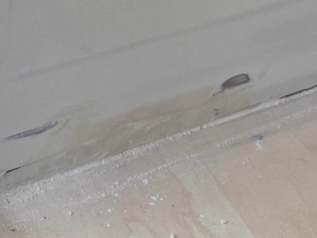

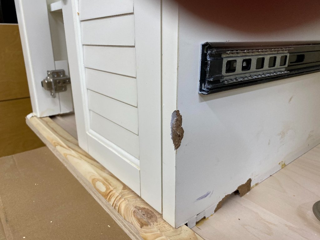

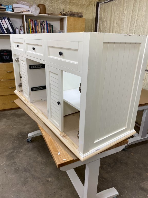

Posted: Sat Jan 09, 2021 2:39 pm
by BrokenolMarine

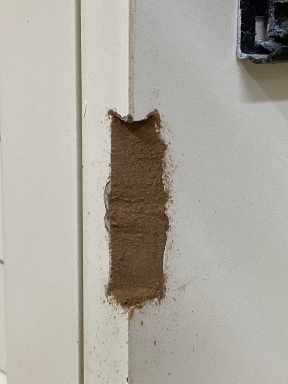

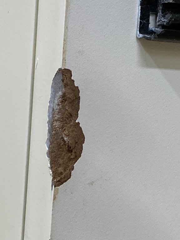

In this first picture you will see what I started with. Note the nasty gouge in the leading edge of the vertical panel and the nasty hole in the bottom edge of the side panel. Miss Tina said not to worry about them, she would paint over them and ignore them, very few people would SEE the master bath anyway and SHE would ignore them until we remodeled the bath. ;) Ah... I tried, I really did. Just not my way.

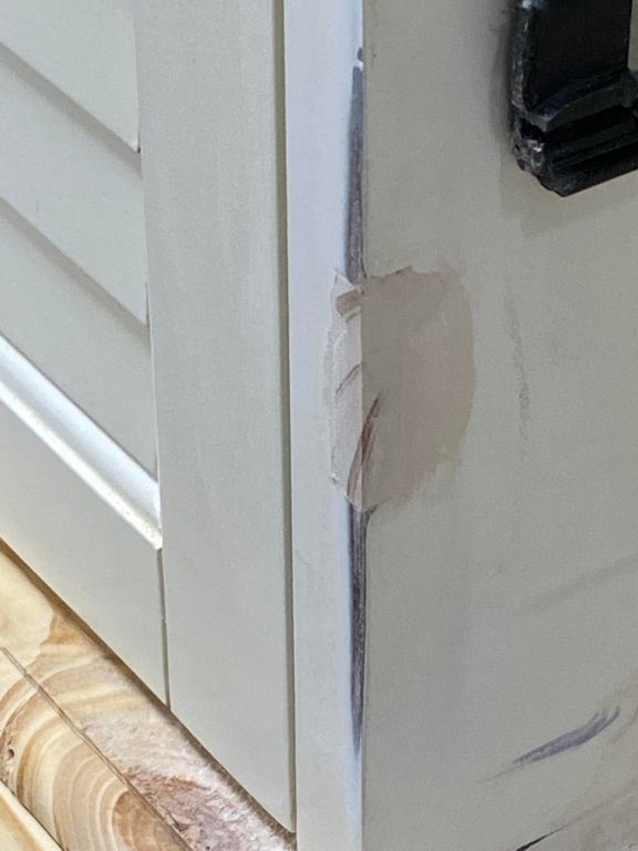

So let's take a close up look at the gouge, and then the coping saw cuts and cleanup work I did with the chisel.

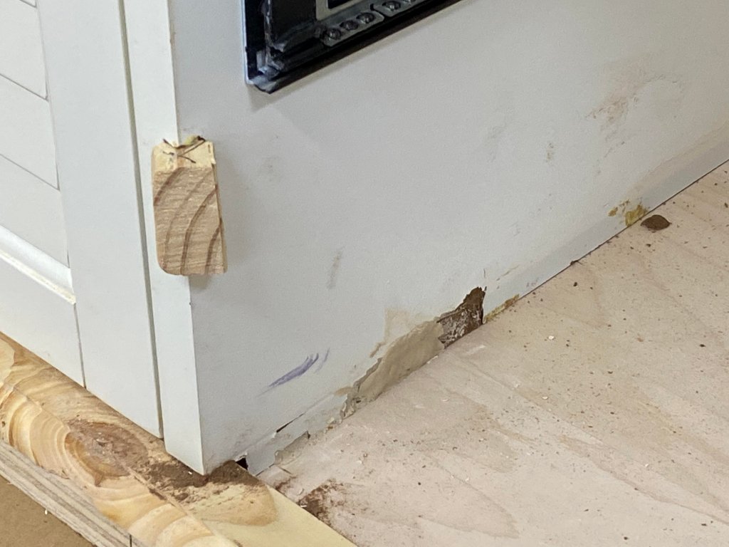

This gave me a place to put the insert cut from pine. I fitted and adjusted, until I got it close, then glued it and left it. I came back later and cut it off flush. Sanded it, then filled it in with wood putty.
The nasty hole in the lower edge, slowly filled with the same putty, then sanded smooth. Will continue to fill and sand until it's flush and smooth and disappears completely. Painted, you won't see it at all.
The overall view is much improved... especially with the addition of the toe molding.
