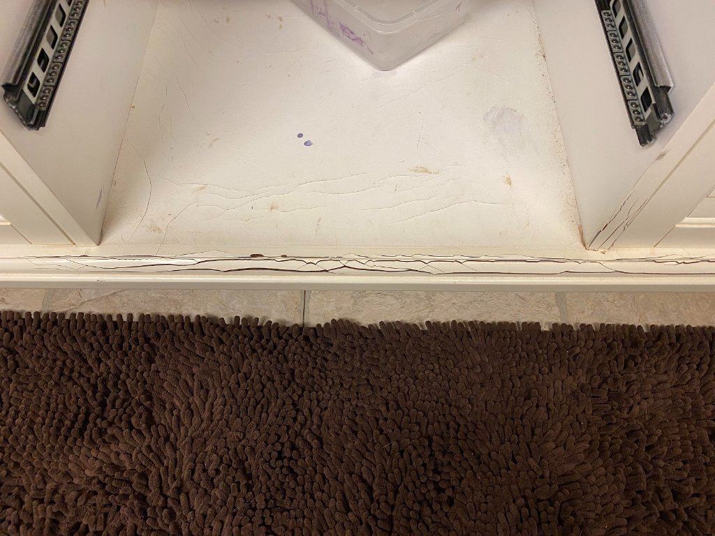

Let's get started on the cool stuff with pictures. We had been turned on to the leak with the crackled paint. It looked like this:
001 cracking paint.jpg (163.2 KiB) Viewed 5655 times

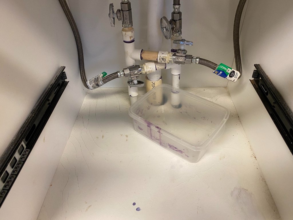

This pic was taken AFTER the drawers were removed. Our attention was first drawn to the paint when about a 6" section first cracked along that lower trim at the front of the vanity. Before this happened, the hot water line at the back of the vanity had been leaking for SOME time. The bottom panel UNDER the drawer stack had already turned to mush and the water was wicking forward and somewhat up.
002 snarl of plumbing.jpg (105.31 KiB) Viewed 5655 times
If you look at the snarl of plumbing the former owner and his dad installed, you'll note that they did NOT add shutoffs below the T's splitting the lines going to the individual sinks, so you can't turn the water off to both sinks at once, NOR can you remove the countertop and sinks, without turning off the water to the entire house. In addition, the crowding of the pipes after gluing, made it impossible to turn off the right hand sink hot water, which was the ONE that was leaking. Not helpful. Had to turn off the hot water to the house unless needed. We put a drip pan under the joint until the plumber could arrive.
Also, the drain line from the sinks going into the OUTGOING line into the floor was NOT glued in, it was just stuck down into the pipe. NOT to code.
Look at the picture below, note the drainpipe from the lefthand sink, flowing to the center T, it has a major crack almost the full length across the top. This is the master bath, and it was NOT exposed to the elements. The crack is centered at the top of the pipe. Our plumber figures they installed it that way since it's a drain line and not under pressure. BUT, also not up to code. :evil:
003 cracked drainline.jpg (96.46 KiB) Viewed 5655 times

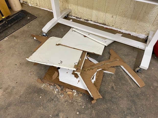

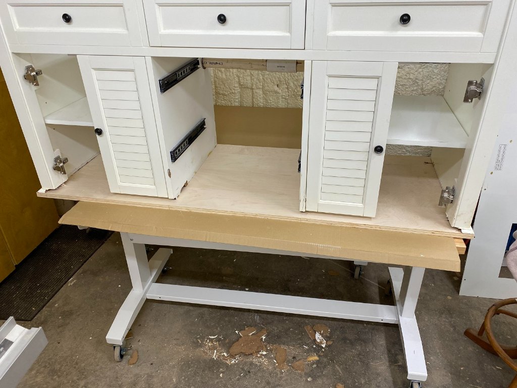

Once we got the Vanity out to the shop, we removed the base, and it came off in pieces. Ah... not reusable. :? Most of the MDF was swollen and mush, but some was still sound, just waterlogged. My plan was to replace the entire base.
004 base removed.jpg (98.16 KiB) Viewed 5655 times

The next step in the process was to clean up the glue and residue from the bottom of the Vanity to have a level and clean base to attach then new bottom to. This process involved a chisel, mallet, pliers for removing the long staples, and patience. A level laid across the base to check the work. After a couple hours work, I could move on to the next step.
05 glue cleaned up.jpg (137.52 KiB) Viewed 5655 times

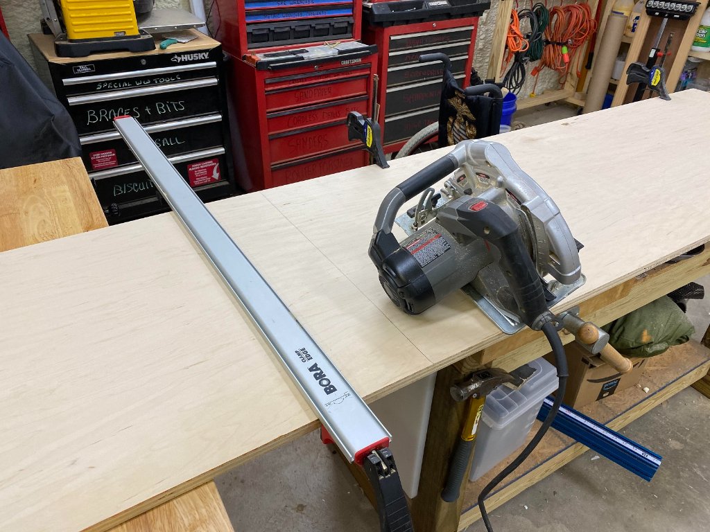

I measured and marked the panel for the bottom of the vanity. I had cheated. I'll admit it. I had Home Depot RIP the plywood sheet on the panel saw when I bought it. I'm not stupid, I knew the width I wanted and had the twelve year old working the lumber yard cut it for me. :P That 3/4" sheet of cabinet grade ply is HEAVY. Cut in half it's LOTS lighter, and I don't have to try and make that RIP cut at home. Too old and tired to deal with it. I used a guide I had ordered from Lee Valley or Woodcraft, can't remember which, I have a three piece set. Makes that cross cut with the skill saw a breeze, the hard part is getting it set up.
006 new bottom cut.jpg (173.12 KiB) Viewed 5655 times

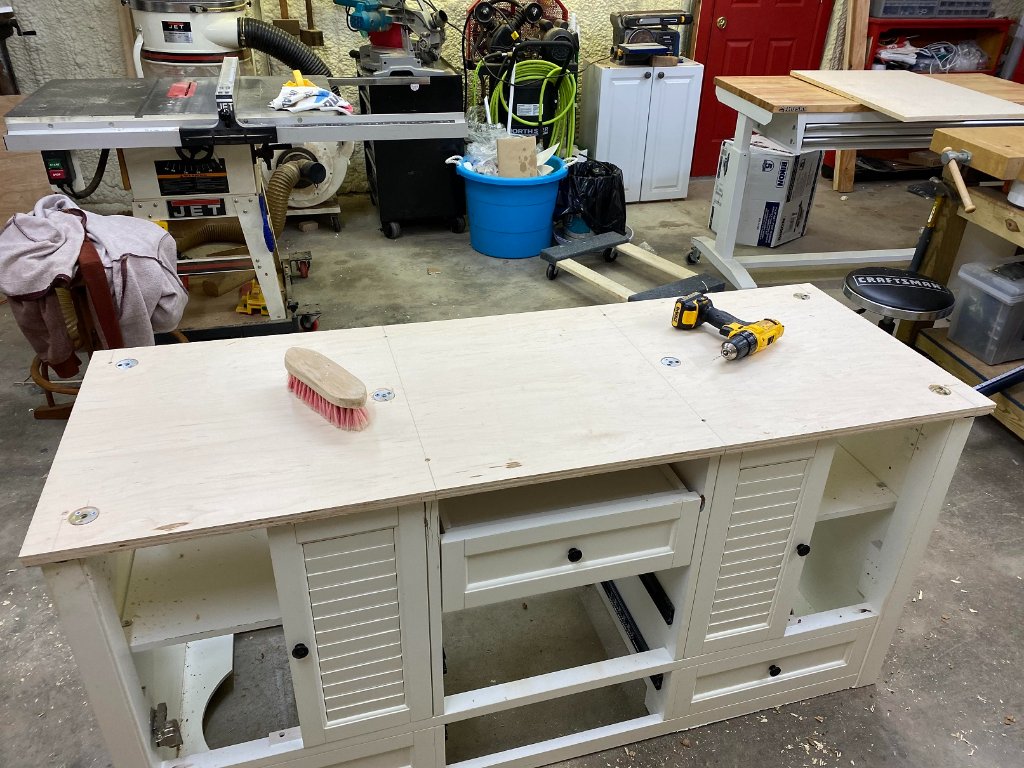

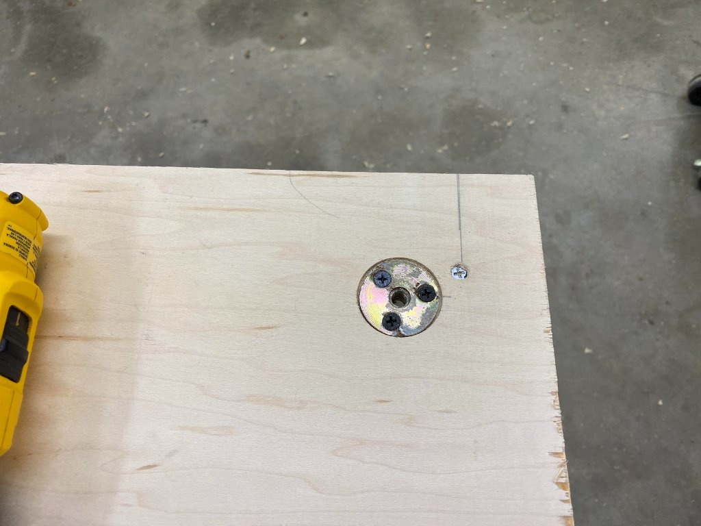

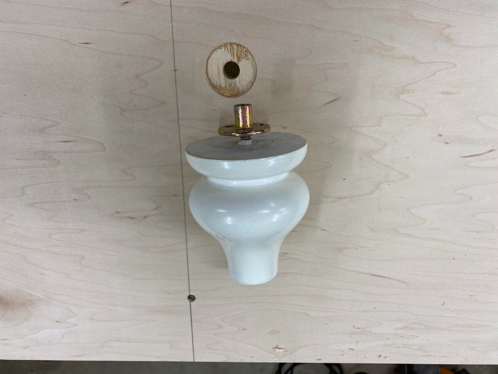

Laid the bottom on the vanity and marked the location of the feet, then drilled the countersinks for the brass threaded bases. Drilled the holes for the threaded portion as well. All that was done with a pair of forstner bits. Then I screwed the six plates in place.
007 countersink feet base.jpg (97.73 KiB) Viewed 5655 times
Here is a close look at the base / foot combo
008 better look.jpg (92.77 KiB) Viewed 5655 times
The base was glued and screwed, carefully marking and measuring the location of each screwhole I drilled before doing so.
009 base glued and screwed.jpg (184.42 KiB) Viewed 5655 times

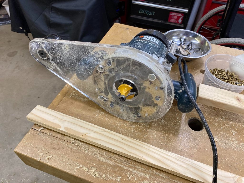

I had planned to make the trim I needed with my molding planes, but after two passes thru the drawer, I couldn't find the profile I needed, so I went thru the box of bits for the router, and there she was. I chucked it in the router, carefully measured the depth needed and set that on the router.
0010 router setup.jpg (199.03 KiB) Viewed 5658 times
I took a piece of 2x4 the right length, with extra, and secured it on the bench, then made a pass across it with the router, then checked the result. The shoulder on the trim wasn't high enough to match, so I reset the depth of the bit to cut a bit deeper and made another pass. Bingo.
0011 routing trim.jpg (219.2 KiB) Viewed 5658 times

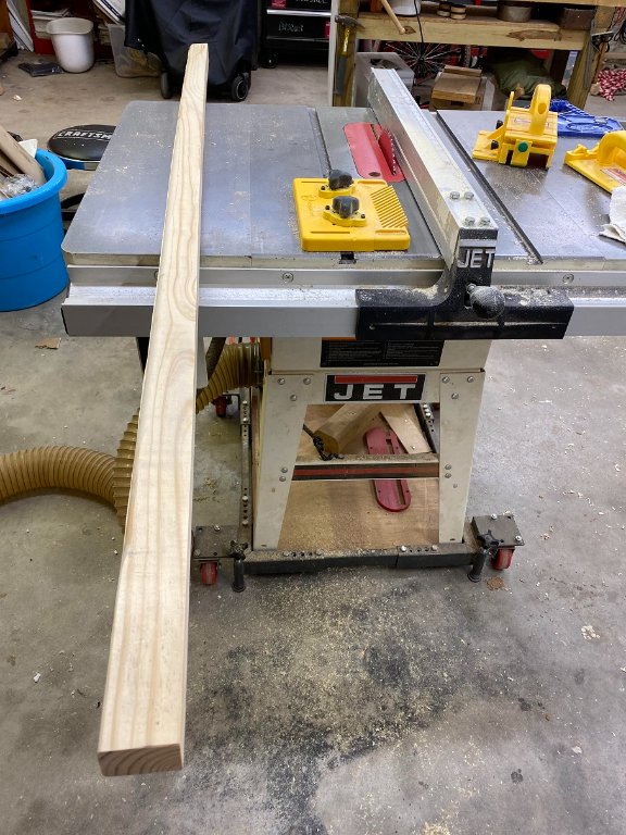

I took the 2x4 to the table saw, and set up the table saw for a rip. Then measured the width I needed for the molding/trim. I made a ripping pass to get that width across the top of the molding. Pucker factor, slip or kickback and I would have to start over. Then, I measured the height of the existing molding. Reset the Table saw and made that second pass. Boom.
0012 ripping off molding.jpg (117.89 KiB) Viewed 5658 times

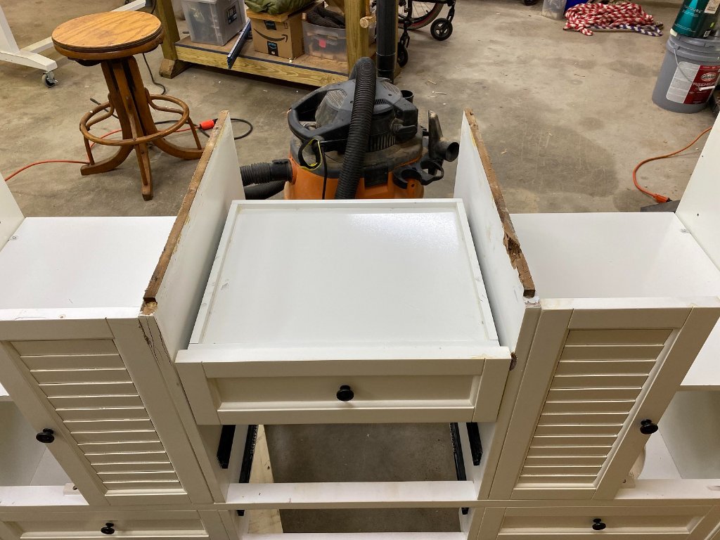

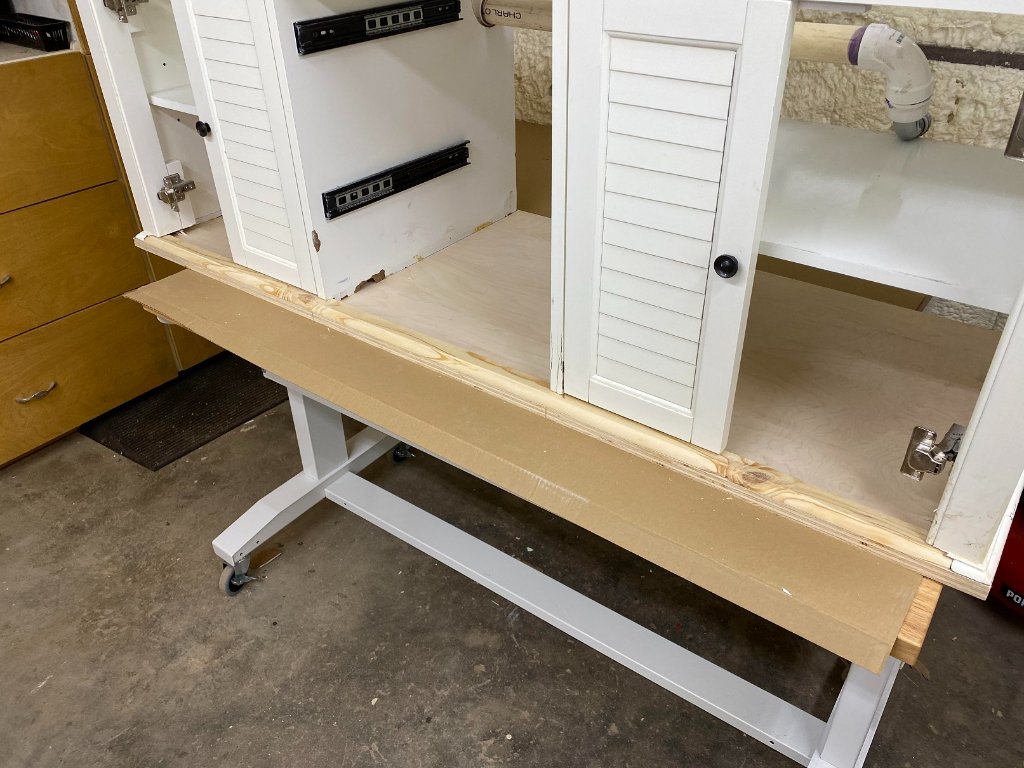

The molding goes into the vanity where the cracked molding / trim was under the cabinet doors and the drawers were at the bottom. You can see the gap in the pic below.
0013 goes here.jpg (135.38 KiB) Viewed 5658 times

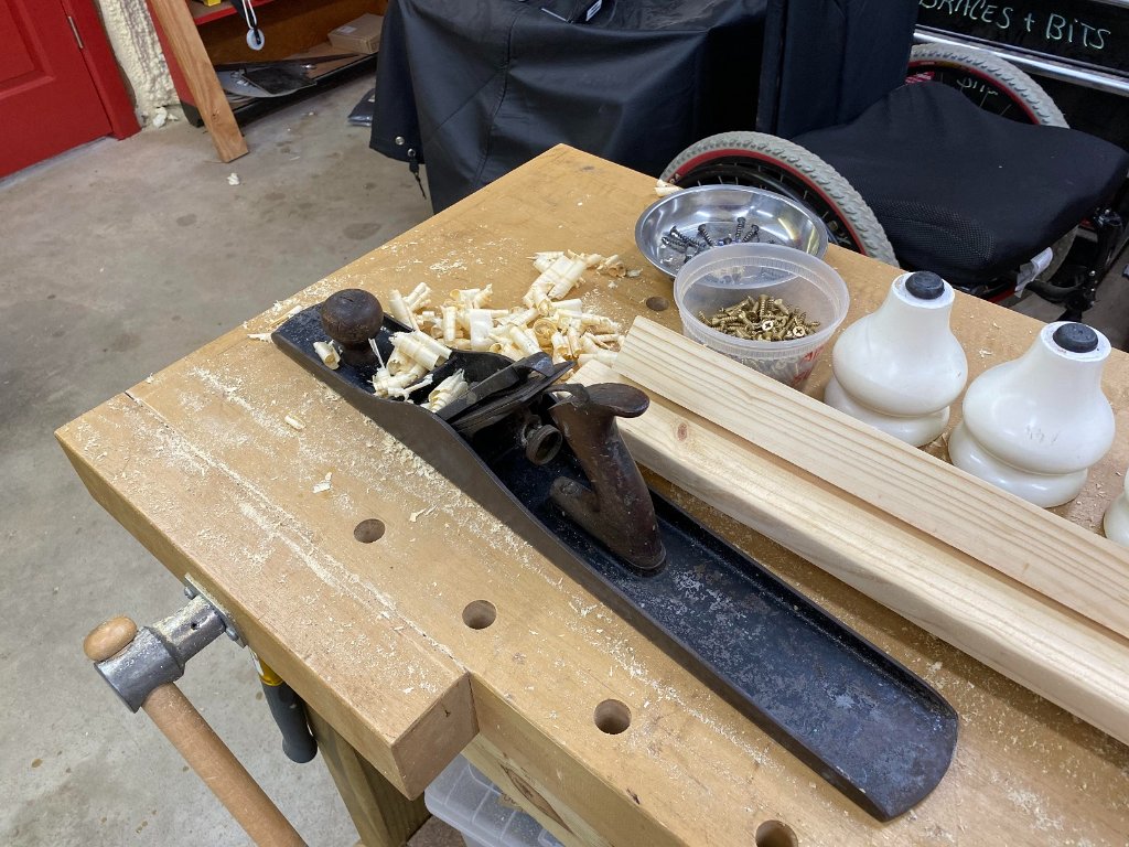

When I made the first test fit it was just a bit too tight. It would have been WAY too dangerous to try and run a piece that thin back across the table saw, at least for me. I got out my long plane and planed the back of the trim until it fit. I love the planes, quiet and LOTS less messy than that DANG router. :)
0014 planed to fit.jpg (186.71 KiB) Viewed 5658 times
I planed the back of the trim, tested the fit, planed, and tested, repeated until it worked. I MAY add trim to the front edge and two sides of the new base. Tina doesn't care. Toe molding would work. Not that expensive. Have to go to HD for paint anyway.
0015 in she goes.jpg (139.36 KiB) Viewed 5658 times
There are still a few minor cosmetic repairs to make and then painting to be done. The plumber will reinstall it for me then. It won't be perfect, but I will have saved about $1500.
I can live with it. :D The missing doors are inside, they are off because it's easier to carry with them off. Gives us handholds. The drawers are out because they are full of crap and we didn't need the weight. The one drawer is installed because I needed the center towers to be properly spaced when I screwed the base on. I'll remove it when we carry this thing anywhere. It's a heavy Sumbeotch. 8-)

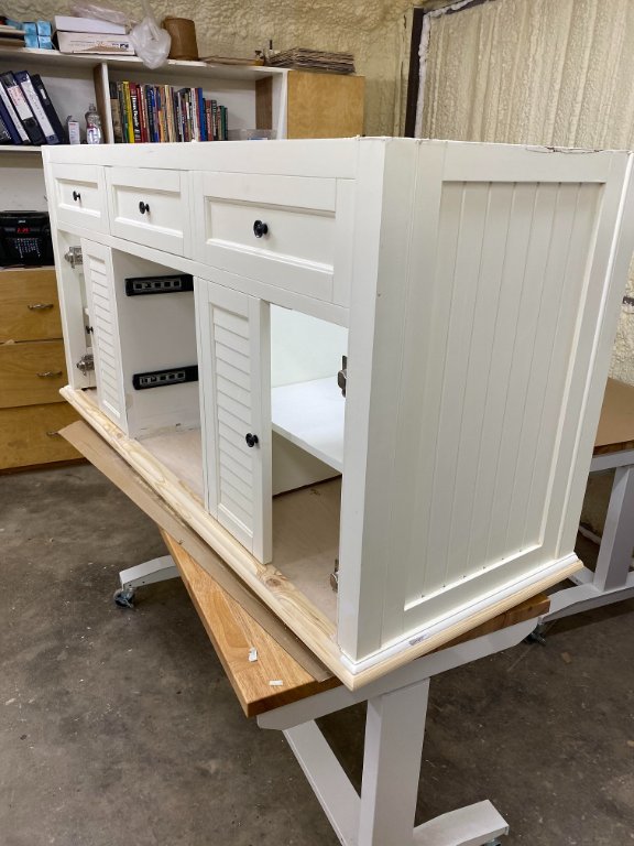

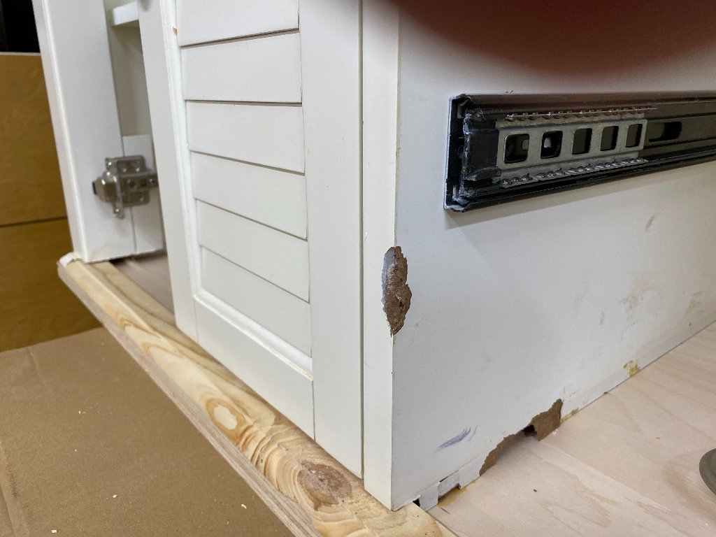

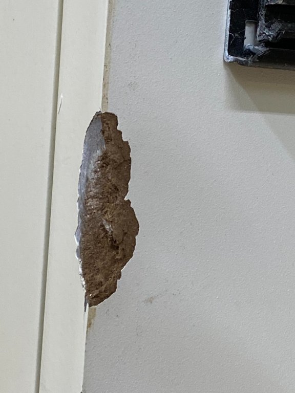

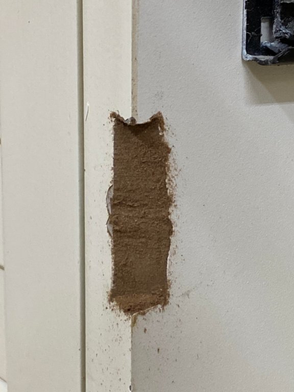

In this first picture you will see what I started with. Note the nasty gouge in the leading edge of the vertical panel and the nasty hole in the bottom edge of the side panel. Miss Tina said not to worry about them, she would paint over them and ignore them, very few people would SEE the master bath anyway and SHE would ignore them until we remodeled the bath. ;) Ah... I tried, I really did. Just not my way.

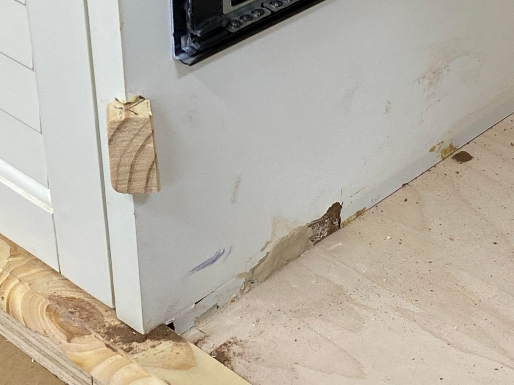

So let's take a close up look at the gouge, and then the coping saw cuts and cleanup work I did with the chisel.

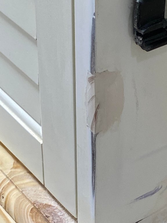

This gave me a place to put the insert cut from pine. I fitted and adjusted, until I got it close, then glued it and left it. I came back later and cut it off flush. Sanded it, then filled it in with wood putty.

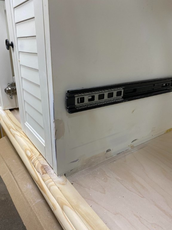

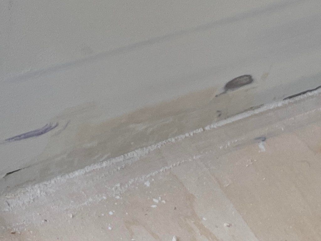

The nasty hole in the lower edge, slowly filled with the same putty, then sanded smooth. Will continue to fill and sand until it's flush and smooth and disappears completely. Painted, you won't see it at all.
The overall view is much improved... especially with the addition of the toe molding.
