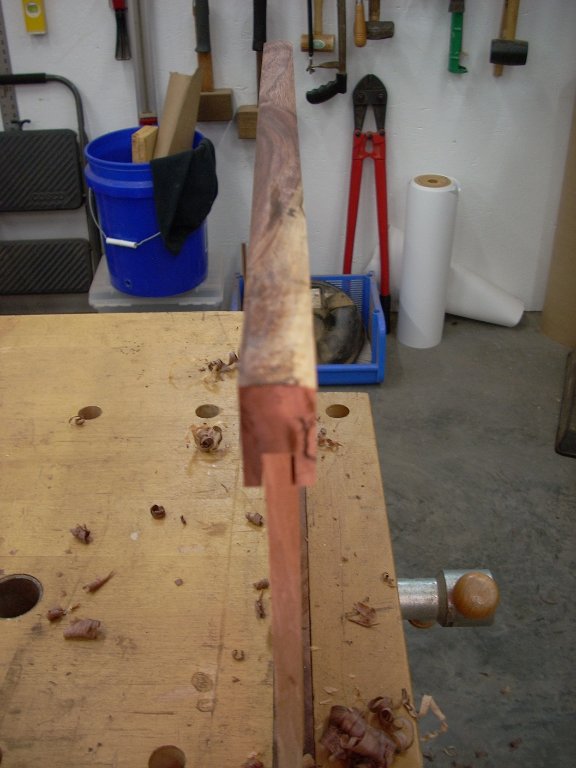

Pics, as promised.

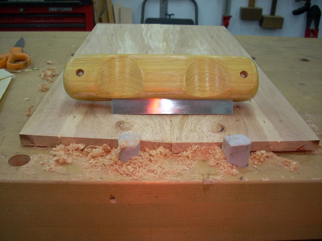

When I worked on the edge panels yesterday, the goal was to soften the sharp edge of the walnut rails. First step, sharpen the blade of the spokeshave. Once that was done, I clamped each panel in the end vice of the workbench and slowly drew the spokeshave centered on the top of the rail and worked the rail to soften the edge.
They started with crisp sharp edges. Something like this:
After some slow steady work with the spokeshave, first shaving only the outside edges, and eventually a full stroke all the way across, they ended up with a nice profile.
I love working with handtools, as I have said before. Whisper quiet, and no sawdust filling the air. Just a pile around the bench when you are done.

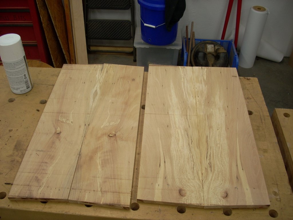

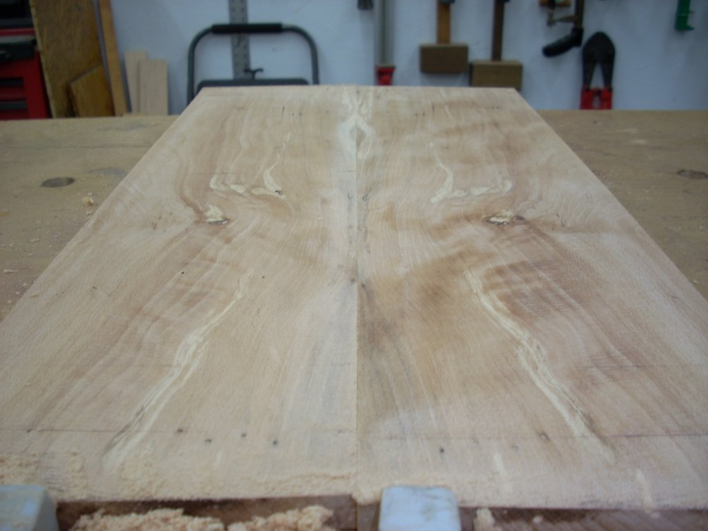

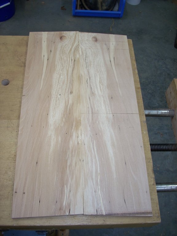

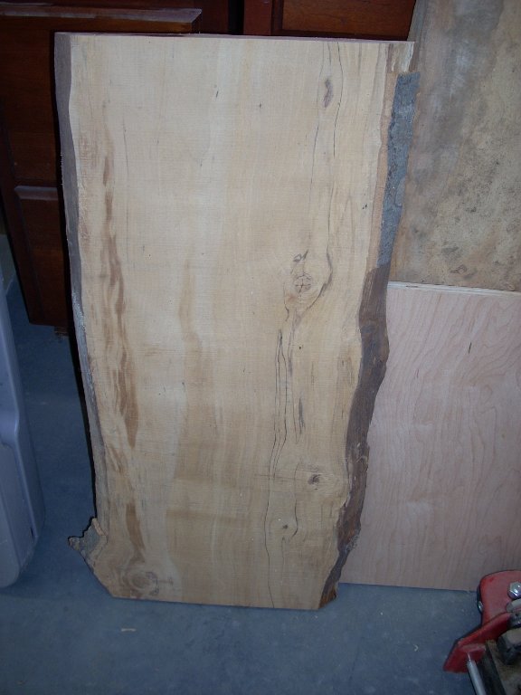

Back in the shop this morning, working on the new "doors" for the chest. I went with the spalted maple this time as I had the slab pieces in the shop. I cut a piece from the slab... 11 inches wide then ripped it down the middle, easier to bookmatch. That bookmatch would give me the two doors I needed.
Here is the slab...
After two days of work, both yesterday afternoon and then again this morning...
Cutting and squaring the original 1" plus thick slab,
Then ripping it down the middle into approximately two 5-1/2 inch pieces
Bookmatching those,
Then planning them to matching thicknesses,
Squaring them up,
Deciding on A and B sides
You get this:
We are FAR from done. Still far more finishing, and the B side needs a lot of work. That will be the underside when you open the wing doors on the top of the chest to access the yarn to change it out or replenish an exhausted supply on a large project. We are getting there. Still need to make a bottom panel and do a bit of SANDING...
... on all the components ...
Here is the slab...
Bookmatching those,
Squaring them up,
You get this:

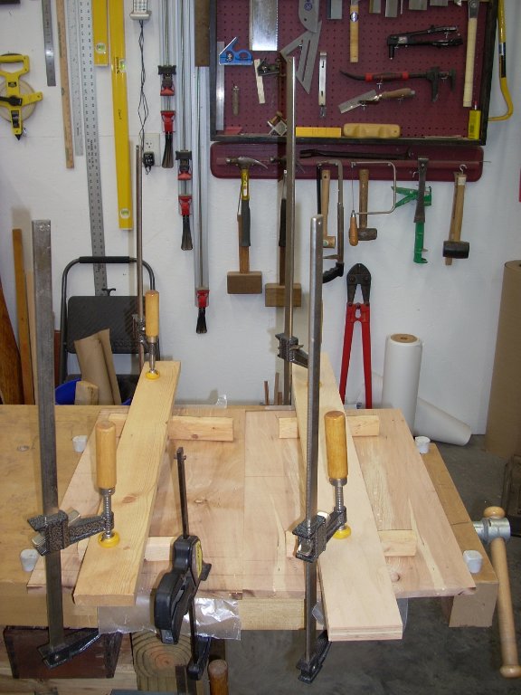

Out this morning to work on Miss T's project again. Last night I put the wing doors under the clamps for glue up.
I let them set up overnight and this morning I pulled them out of the clamps and gave them a look see. "I" thought they looked pretty good.
They will need more work. I have to:
Square the ends, "AFTER" I decide on the width and length.
They will need final sanding to knock out the planer marks, and I need to decide on the outer edge shape.
Do I want a straight edge, or a scalloped edge for style?

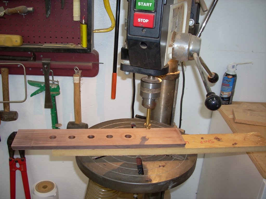

I measured the center, and worked three each direction, marked them with a punch and drilled almost all the way thru with a forstner bit. The tip of the bit JUST tweaking thru.

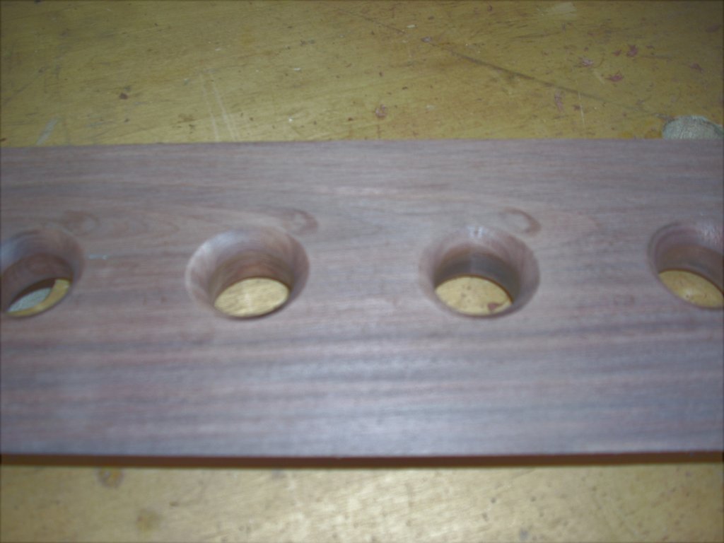

Then I flipped 'er over and finished the trip. That way I had clean, crisp holes without tear out.
Once all six holes were done, I got a 1/4 inch roundover bit, and fired up a small router. I haven't used one in about two years, but for some things... there is no substitute. I needed the edges rounded top and bottom so the yarn won't drag. I will polish the rounded edges with strips of 400 grit sandpaper, just to be safe, but it would "probably" be fine as is. Probably isn't good enough when the project is for the boss.
MORE sanding needed on other components as well, but we are getting close to the end. Still need to make the bottom and the legs. (I need to decide what I WANT for the legs.) Sheesh.

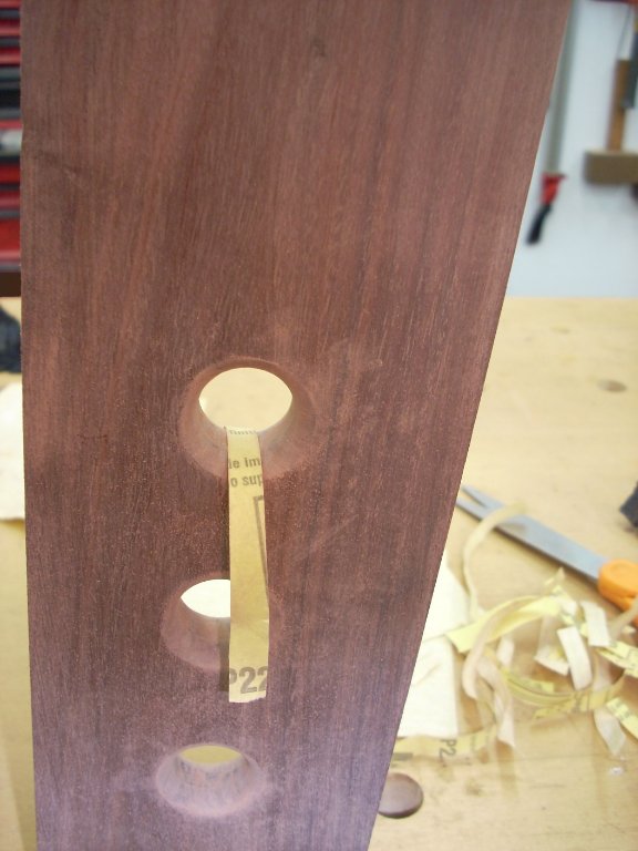

Some time in the shop today, spent sanding on the top rail. Mainly focused on the holes for the yarn. I cut strips from 220 grit sandpaper and hand sanded the holes to make them glass smooth. No catching on the yarn.
Gotta keep the boss happy.

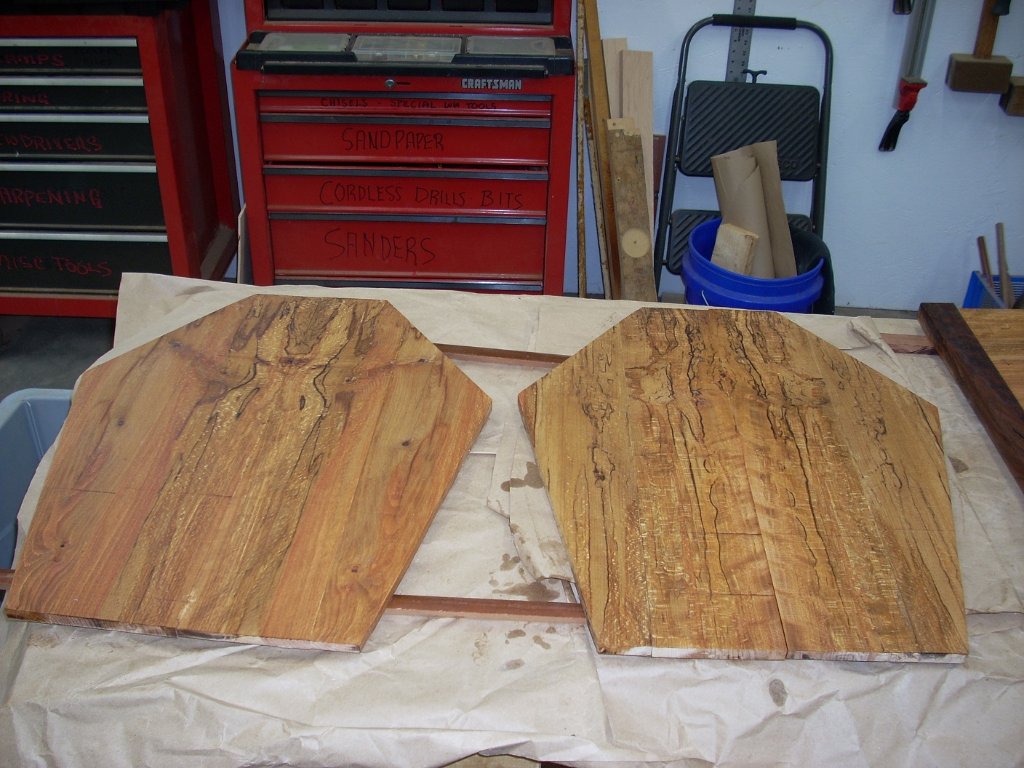

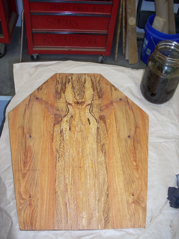

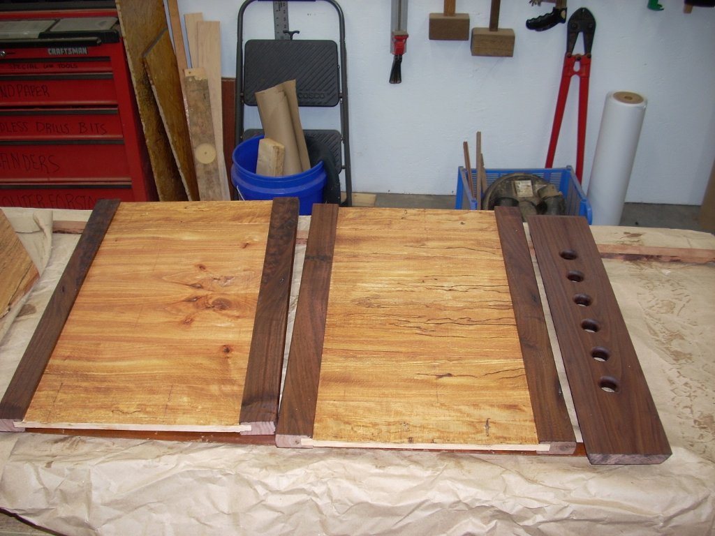

The Best Part of working in woodwork, is when the stain or oil finish is applied and the grain pops... and the best way to avoid disappointment is to wipe it with denatured alcohol or mineral spirits to remove the dust. At the same time, the wiping action darkens the wood grain and will highlight glue spots or any sanding errors giving you a chance to correct those before applying stains or finish.
I did that last night and then left the pieces until this morning, then got ready to be Wow'd.
The stain chosen wasn't by chance. I had saved scraps from the project and tested both the walnut and the maple with Cherry, Natural, Medium Walnut, and Golden Oak Watco Oils. Miss T liked the Golden Oak the best... unfortunately, I only had a small amount of that stain left. Lowes and Home Depot only carry the Medium and Dark Walnut and the Natural. NO Golden Oak. Woodcraft and Amazon carry Golden Oak, but Woodcraft is 90 minutes away, but with the drive would cost double the price of Lowes. I ended up testing a 50/50 blend of Medium Walnut and Natural Watco Danish Oil and it was perfect as far as the Ms. was concerned.
Here is the End Panel Process.
Panel Comparison stained and not.
The Stained Panel
Then both ends stained.
The side panel comparison
Side panel close up
Both Sides and the top rail stained.
You will note some of the areas NOT stained, ends mostly. These are areas that will be glued later. The Danish Oil will prevent good glue up, so I didn't stain those areas. I learned this the hard way in previous projects.
I will let these panels cure, then put the basket together. Still to come will be cutting then staining the wing doors after they are test fitted. I need to make the bottom panel, attach the turned legs and make and attach the feet. Getting there.

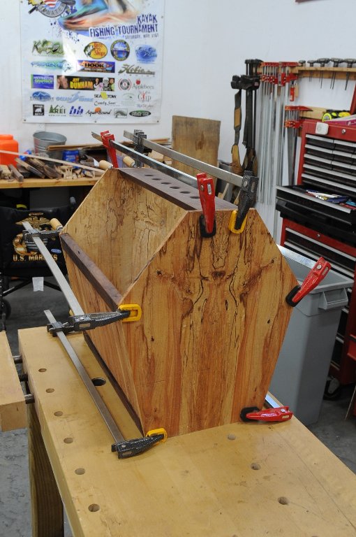

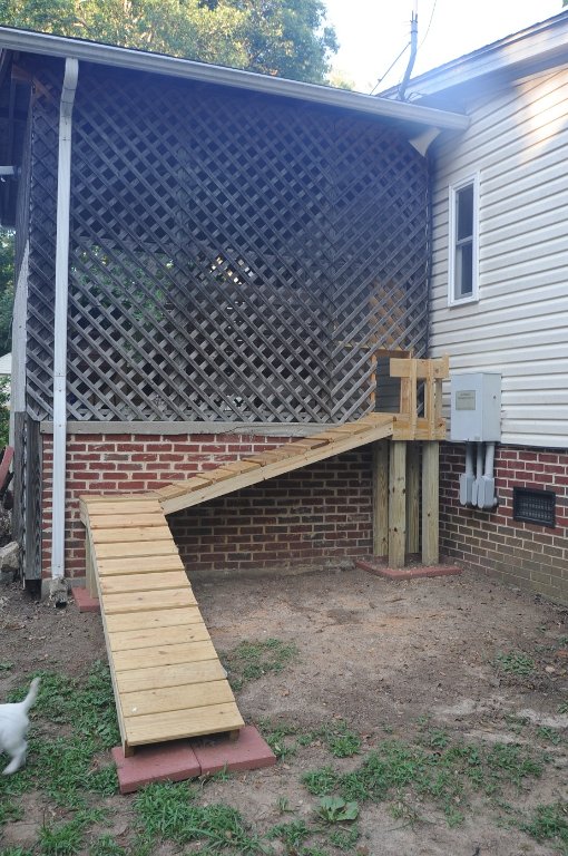

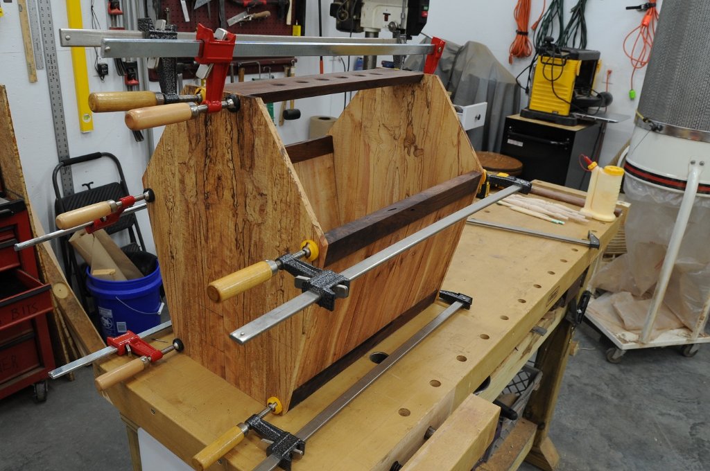

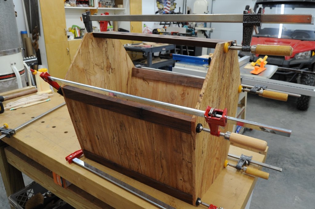

Wow... it's been a while. I know I have been away from the sewing chest... but the dogs have demanded a lot of time. We have been working on a play area for the dang pups, and training, training, training.
Anyone with new pups in the house knows how that goes.
Miss T ordered new fencing, electric netting actually. The goal was to keep the dogs in and other dogs out. Then we wanted to be able to give the access to the back yard and the side porch, but it's four feet high. Another ramp was needed. That took some design. At first she (The Boss) wanted a straight ramp. Turned out to be too steep, as I predicted. I had designed a two stage ramp with a turn... but (The boss) deemed it too complicated.
Took the straight ramp apart and used the pieces as part of the new ramp. Perfect. In the pic below you can see the results of four day's work. First Miss T leveled the area with the blade on the tractor, then we "really" leveled the area where the two small "decks" would be with the level and patio stones. I cut some thin 2x4 dividers to alternate with deck boards to reduce the chance of the dogs sliding on the wet or iced ramps in inclement weather and we got the angled sections done. The dogs love the ramp.
The dog ramp and fence up, the boathouse repairs done and a day of rest here and there, I was able to get into the shop today, and ... the upper assembly was glued up. I clamped the components together to test the fit, marked them carefully, then drilled small 5/32 holes in the end panels. We then clamped them back together, and drilled matching holes in the side panels and the top rail. Disassembled once more, glued the side panels and the top rail and using small nails as guides, reassembled and clamped, and removed the nails before they got glued into place. I will leave it to set overnight, then use a forstner bit to countersink and set a screw in each of the holes and then put a plug cut from scrap spalted maple in the holes.
Once that is done, I'll install the internal braces for the end panels, measure and cut the wing doors from the prepared spalted maple panels, then begin working on the bottom braces, the legs, and the feet. We are close to the end. You can see what the finished product will look like. Sorta.
