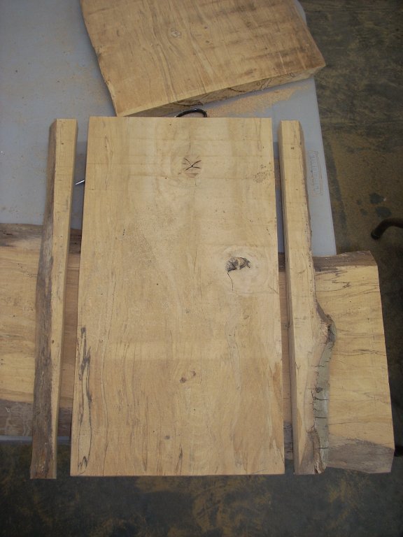

Had been thinking about the base and the top. Bottom and top. I had drawn the sketch and had ideas but I don't start work on something until I firm the rough ideas up. :?
I had intended for the base to be part of the sides and then a trim piece across the front, but that seemed like cheating, so... I gave it more thought. I think while driving back and forth to the VA, the Grocery, the dump. We have a long drive everywhere, plenty of time to think. :lol:
So, I decided to cut the front and sides out of the maple and the back cross piece from the extra ply, and then have a square ply for the upper part of the cabinet to rest on inlaid on the base with the cabinet securely fastened, with a couple screws. So, the first step in the process would be to cut a piece off the slab from which to cut three 2" tall pieces, one of which would be 18" wide and the other two would have to be about 11" wide to reach the back. I won't cut them to length until the cabinet is assembled sometime next week.
(I ordered dowel centering rigging pins, and some short assembly dowels from woodcraft, which I will pick up Tuesday night when I go in for my Plane Tuning class. It's 90 minutes EACH way to woodcraft, not gonna make that drive until then. :) ) I will use the dowels in assembling sections of the cabinet, so it can wait. ;)
The slab was cut and then the two live edges cut off on the band saw.

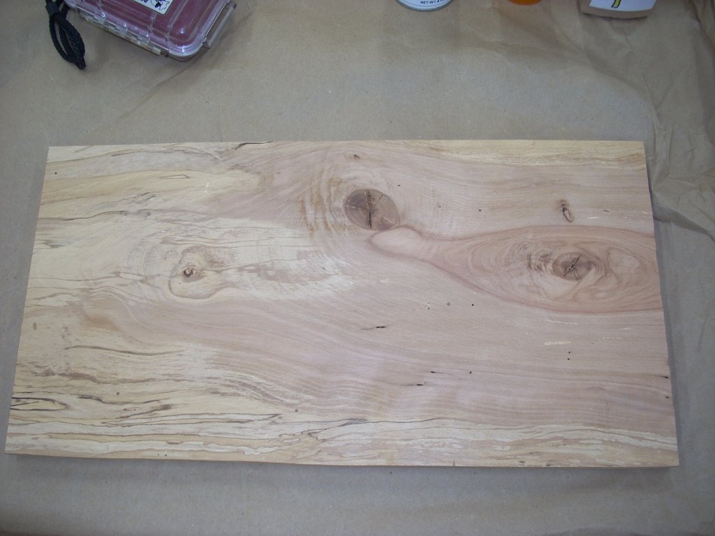

Once that was done, I ran it thru the planer and got it nice and smooth. The grain on this piece is really popping.
16 base slab planed.jpg (138.16 KiB) Viewed 4702 times

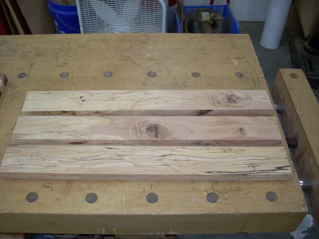

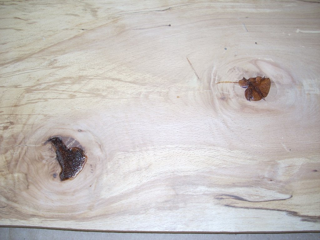

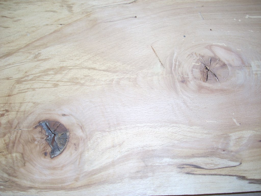

Inspecting the planed piece did reveal a couple knot holes that needed attention.
17 holes to repair.jpg (159.61 KiB) Viewed 4702 times

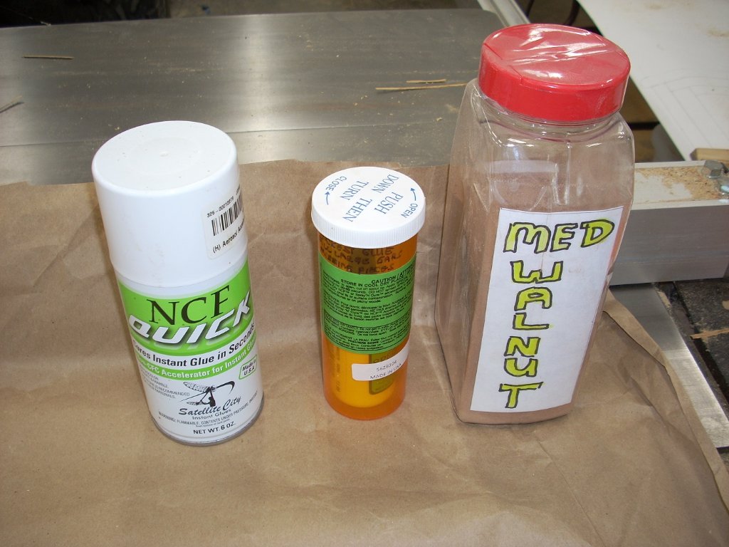

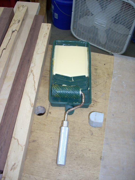

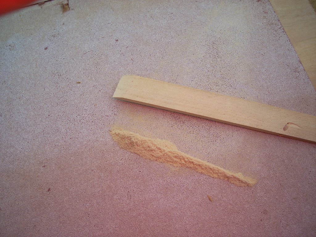

I can repair/stabilize those using a favorite technique I have used for years, using sawdust saved from previous projects, CA glue and spray activator. I also use a square of painter's tape on the back that is not shown in the pic here.
18 goodies to repair with.jpg (162.11 KiB) Viewed 4702 times
Fill the hole with some sawdust, chosen to match or accent, your choice. Then a layer of CA glue, spritz of activator. (without that, you wait several hours between steps.) Repeat the steps until you have built the hole up proud. Let the repair cure until you are sure it's solid then sand it flush. The CA glue won't stain, but it will appear as smooth as glass, and the knot won't fall out later. I usually let them cure overnight and sand smooth the next day.
19 to dry overnight.jpg (178.68 KiB) Viewed 4702 times

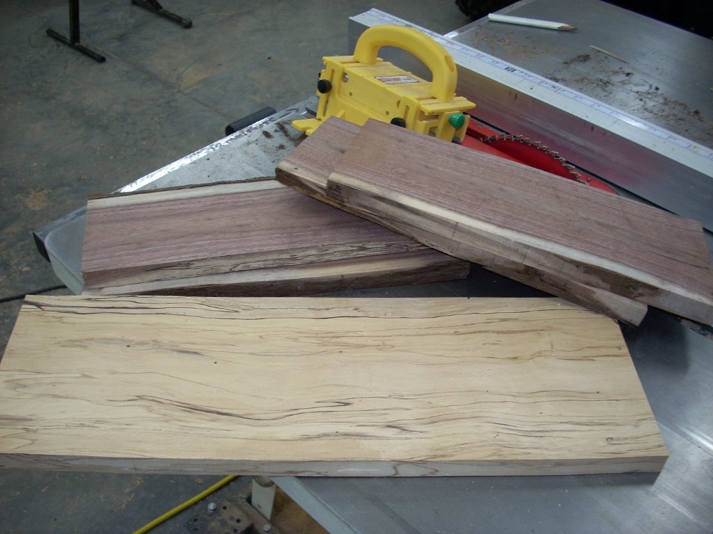

I am going to attempt a cutting board top made with Spalted Maple and Black Walnut, so I cut another slab and trimmed it, then planed that smooth, then several sections of Black Walnut from my stash. (Thanks JStraw for the help.)
20 slabs for top.jpg (159.56 KiB) Viewed 4702 times
Once they were all planed, I ran them across the table saw cutting them at 7/8" widths.
21 run over tablesaw.jpg (145.16 KiB) Viewed 4702 times
I was approaching my limit for this session, so I shut it all down. Tomorrow I will lay out the cutting board top, get it exactly the way I want it and then glue it up. Once it dries overnight I will trim it to size and that will be one step closer to the end game. I have some work to do on the base pieces after they are cut, I am going to use the antique molding planes to shape the edges. :P Yup, can't just do simple.

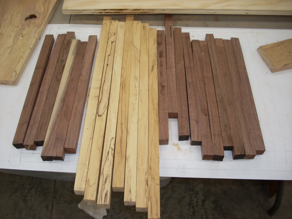

Whew! Lot's done today. I kept wanting to get out in the shop last night and get busy laying out the cutting board, if for no other reason than to see how it would look. :D I resisted, as I didn't want to exceed my limit yesterday. I came out this morning after a light breakfast and got started. I laid out the cutting board kit, and started looking at the various grain patterns, and trying to decide what went where... the wood would tell me. ;) No, really. 8-)
22 Cutting board kit.jpg (145.16 KiB) Viewed 4672 times

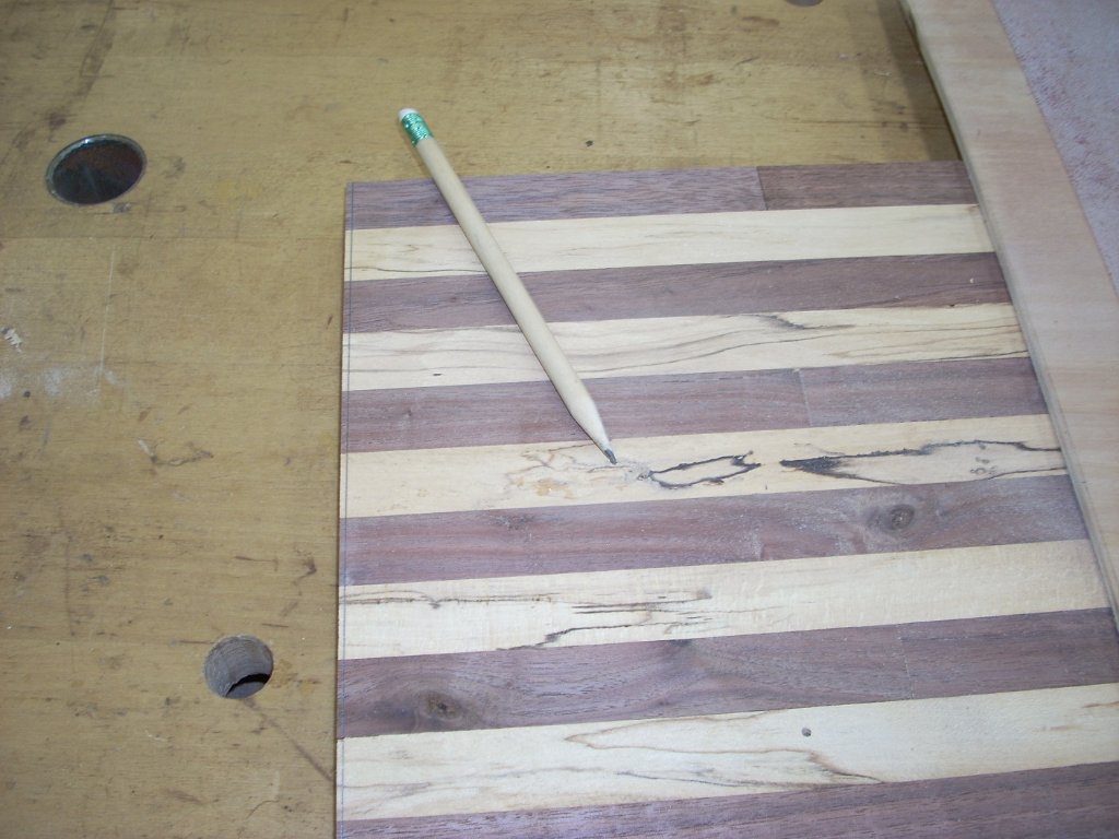

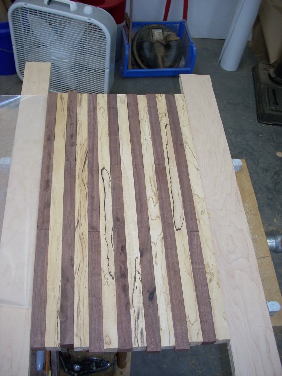

The maple was easy, it was full length, the walnut was a pain. I had to square off both ends, then for every pair, one had to be trimmed to length. The length wasn't critical, as the board coming out of the clamps later will be about 1-1/2 to 2" too long, but... it needs to be close to make clamping easier. after about an hour spent fitting and trimming, the layout was done. I had a test pattern and Miss T gave it a "Nice" of approval. :P
23 test pattern.jpg (116.26 KiB) Viewed 4672 times

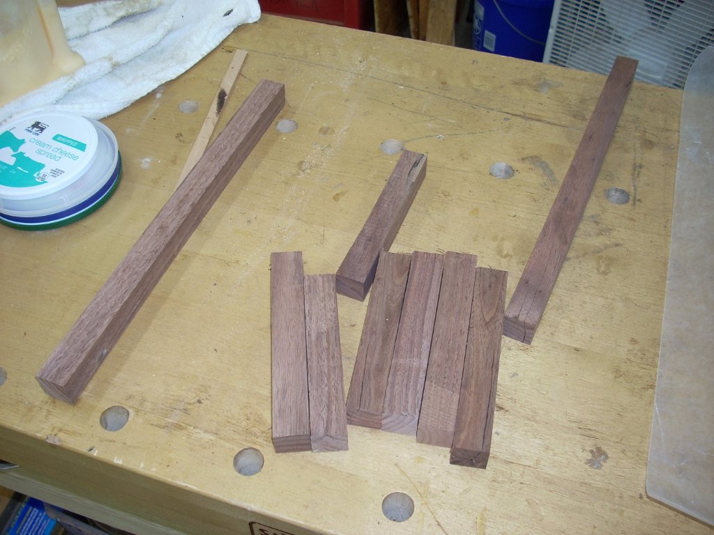

There were just a few leftovers after the pattern test. Too bad I am not a pen maker, the cutoffs are the perfect size for turning walnut pen bodies. Oh well, I'll find a use for these eventually, if not on this project, on a box project or something down the road.
24 leftovers.jpg (170.35 KiB) Viewed 4672 times

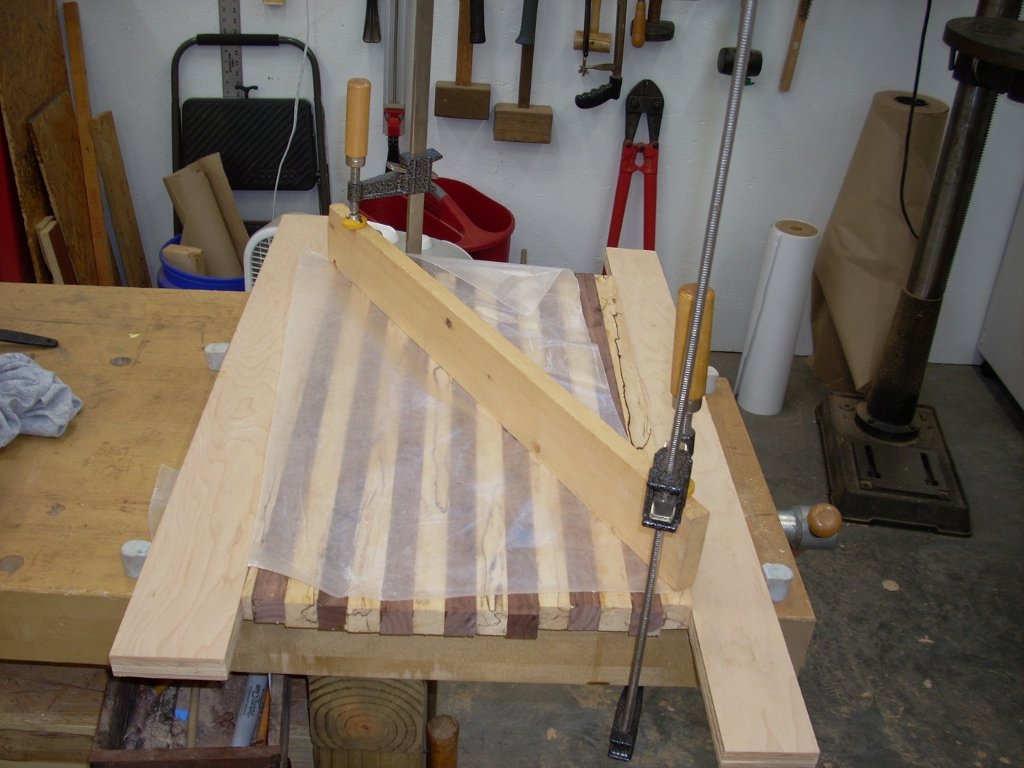

I took everything out of the bench dogs, moved it aside in ORDER, then redid the wax paper underneath. Got ready for the glue up. I set up the glue, got the water bottle and rags handy, and prepared to work... ;)
25 ready to glue up.jpg (119.73 KiB) Viewed 4672 times

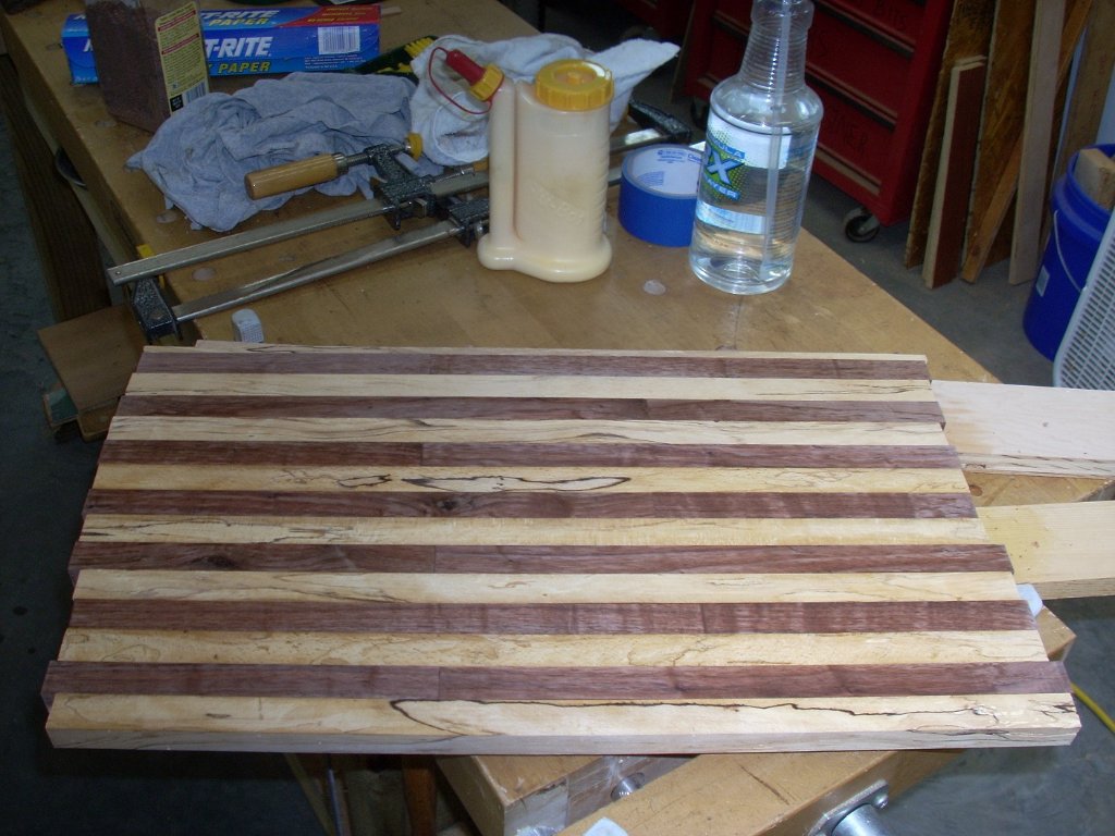

After about an hour, the Cutting board was in the clamps and ready to rest.
26 an hour's work.jpg (155.82 KiB) Viewed 4672 times

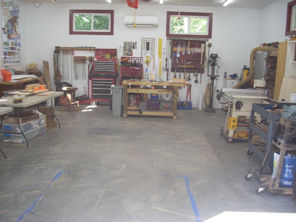

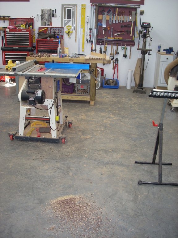

Before going in, I decided the shop needed a mid-project cleanup. I was a bit tired of all the sawdust and the tools and supplies laid out. I put away all the tools, rolled the equipment to one side and prepared to sweep.
27 Mid Project Cleanup.jpg (138.41 KiB) Viewed 4672 times
A good half hour of attention, not detail cleaning, just put away and a decent sweep, made a big difference.
28 a little better look.jpg (164.12 KiB) Viewed 4672 times

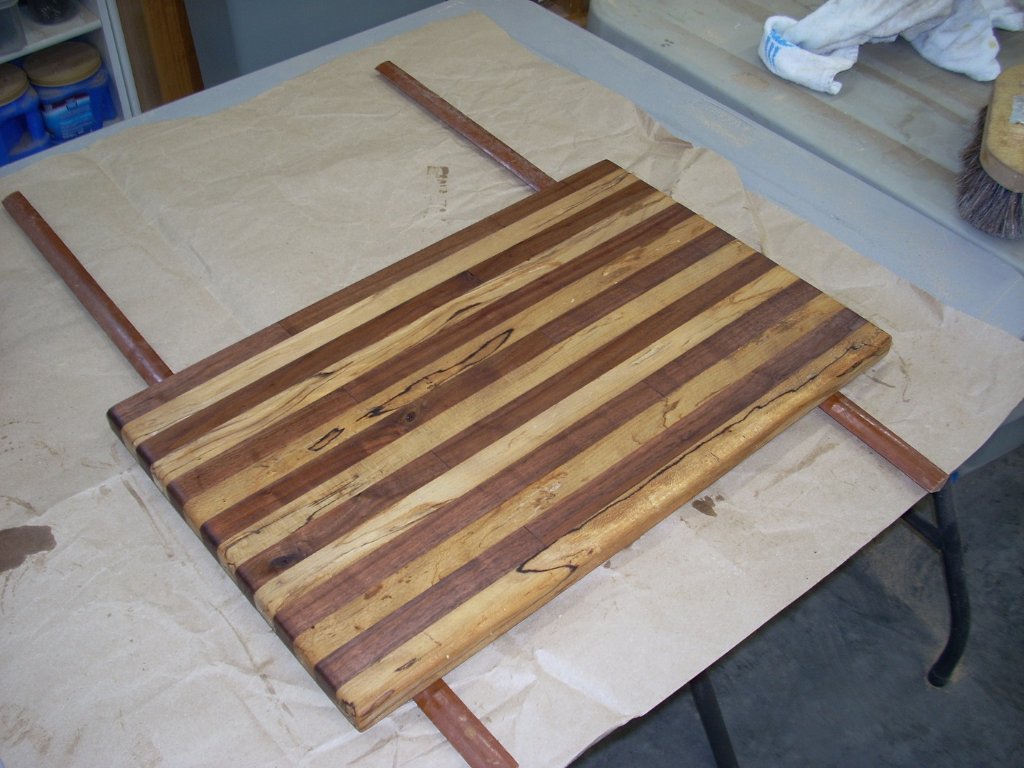

I came back out this evening and turned some attention to the cutting board again, now out of the clamps. I used a cabinet scraper to remove glue bleed out, then ran the panel thru the planer on both sides. It's still over wide, but that won't be adjusted until the cabinet is assembled. You do get a good idea of what it will look like though... Miss T likes it so far.
29 out of the clamps.jpg (179.46 KiB) Viewed 4672 times
Still plenty to do.

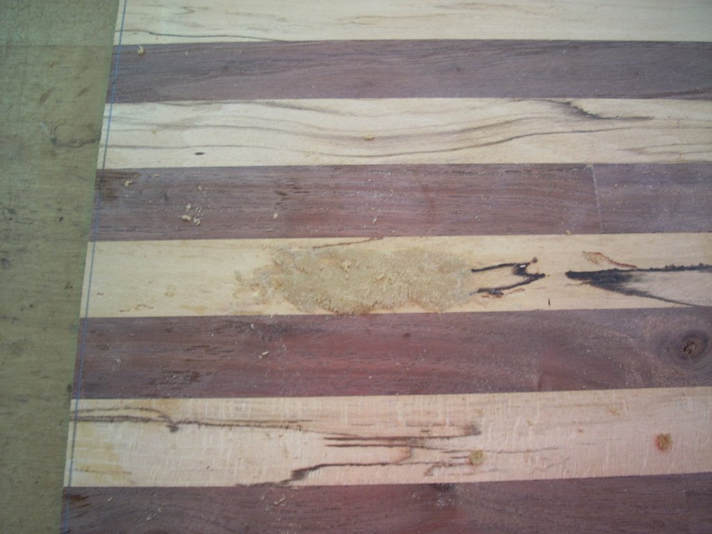

So, back out in the shop this morning, I marked the edges of the Cutting board top, then trimmed them off. Then looked at the gouge in the finished side that the last few passes on the planer had revealed. Bugs cause the spalting, that nice pattern in the wood, but they can also leave hollows. :evil: I doubt you can see the gouge in the picture, but it's as much as a quarter inch deep, and it's an inch and a half wide. Since Tina won't be using it as a cutting board, I could leave it, but it's not my style. :?
30 gouge.jpg (154.32 KiB) Viewed 5771 times
I got busy fixing up some maple paste to repair the gouge. First step was to take up a piece of maple cutoff. (Always save your cuttoffs.) Then sand away the cutoff on a piece of sandpaper glued to a luane panel just for flattening box bottoms. Sand, brush the dust up, sand brush the dust up.
31 maple sawdust.jpg (252.96 KiB) Viewed 5771 times
Drop in a couple drops of the watco oil I'll use to stain the cutting board, since it won't be used, and is just for looks. Mix, then add glue and mix until you have custom wood putty. Then fill the gap and let dry.
32 with paste.jpg (147.08 KiB) Viewed 5771 times
