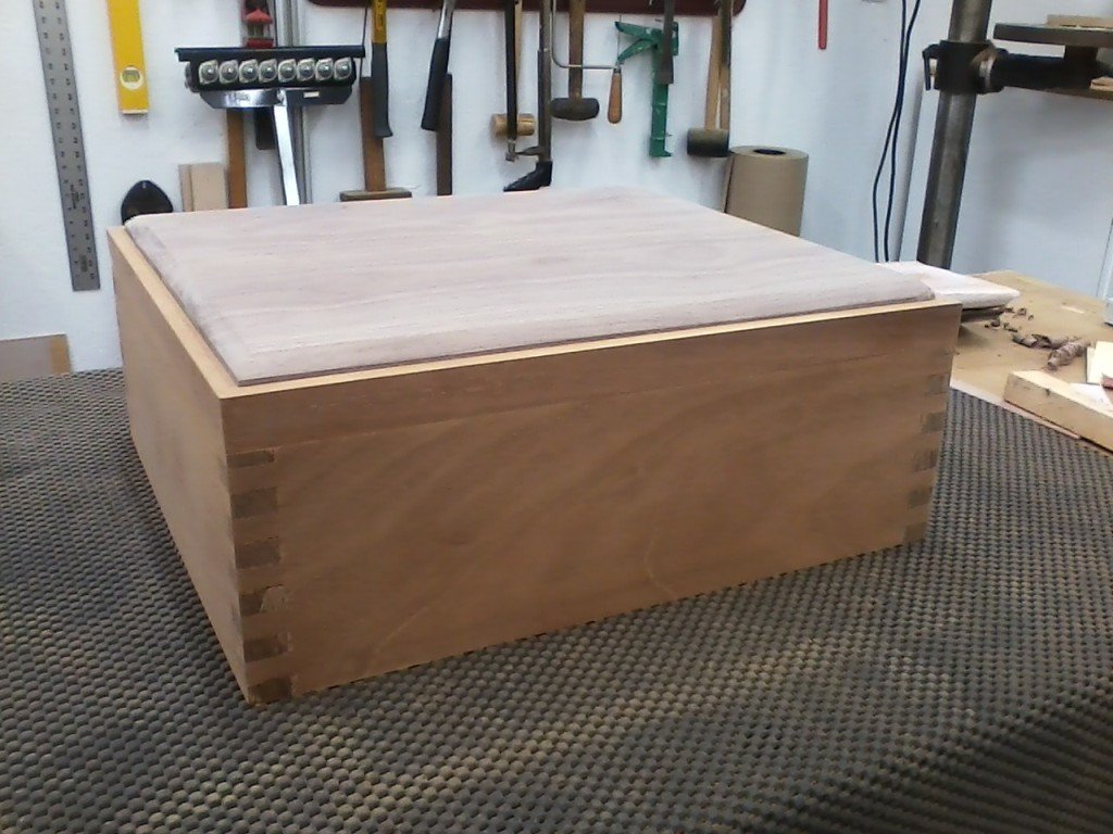

So far, I have gotten to the point where I am about ready to apply some stain, then prepare to inlet the hinges and line it with spanish cedar. Cutting the slots for the hinges is a high pucker factor... :shock: One slip, and I have to start over from the beginning. So far, the Bottom is Mahogany, and the top is Mahogany and Black Walnut.
sean's humidor in progress comp.jpg (144.75 KiB) Viewed 5296 times
I want this to turn out well, and am hoping for the best. I was going to cut the slots this afternoon, but chickened out. So much work has gone into the humidor to this point... I am a bit nervous. :? I'll set up and cut some practice slots in scrap tomorrow, then make the passes on the humidor. After that, it should be smooth sailing.

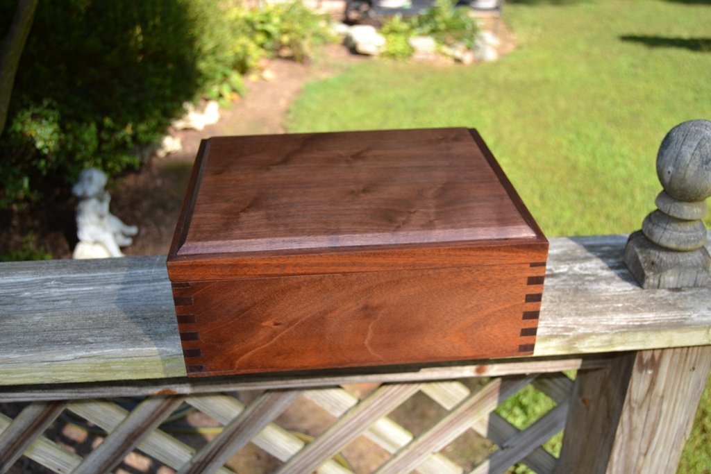

The outside of the box was finished in a Mahogany Stain, then waxed and buffed three times for a nice sheen, but not glossy. If it dulls, My guy can rewax and buff. Right back to that soft glow.
done 1.jpg (155.11 KiB) Viewed 5187 times
He really liked the walnut insert in the top and the contrasting pins of the finger jointed sides.

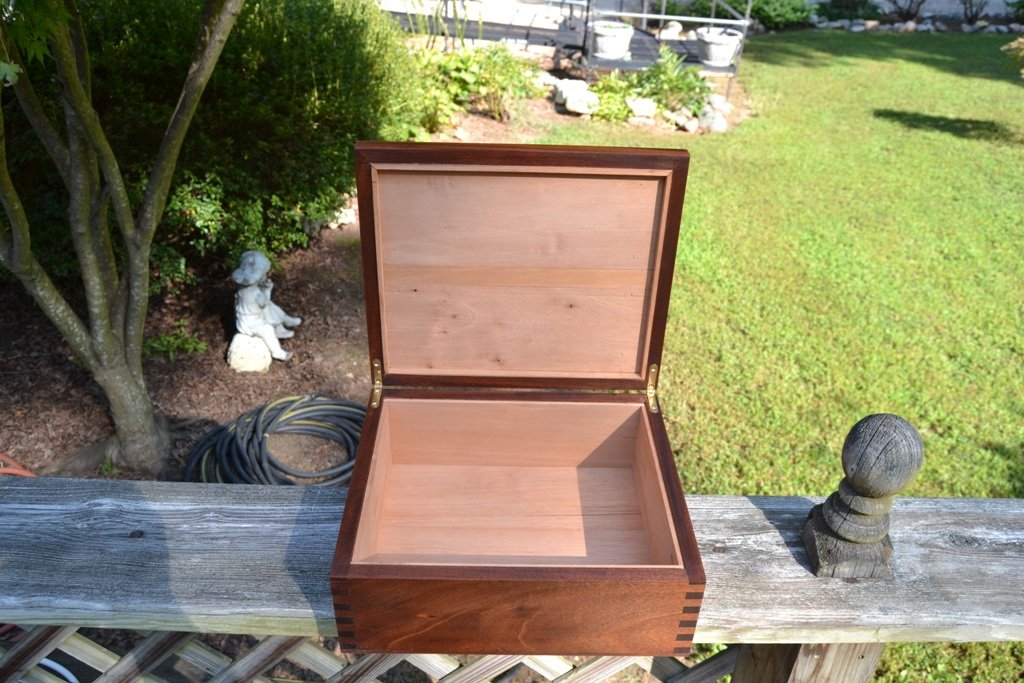

The interior is all Spanish Cedar and there is a 1/16 inch lip that hangs down and locks into the lower portion to seal the interior. The Spanish Cedar gives off a vapor, (supposedly) that kills any little bugs that might be introduced by a bad cigar. It also kills any larvae. If the vapors fade, my guy can pull the four side panels, lightly sand the sides of the panels and then reinsert them. They are only press fitted.

Those hinges gave me fits. Took me three days to cut the mortises and then get them adjusted just right. I didn't glue the screws as I normally would with any box hinges as they are the way you'd adjust the lid to lay flat across the top. With the box needing to maintain 70% humidity with the cigars, there may be changes in the fit. He can adjust the angle of the lid by minutely adjusting the hinge screws.
