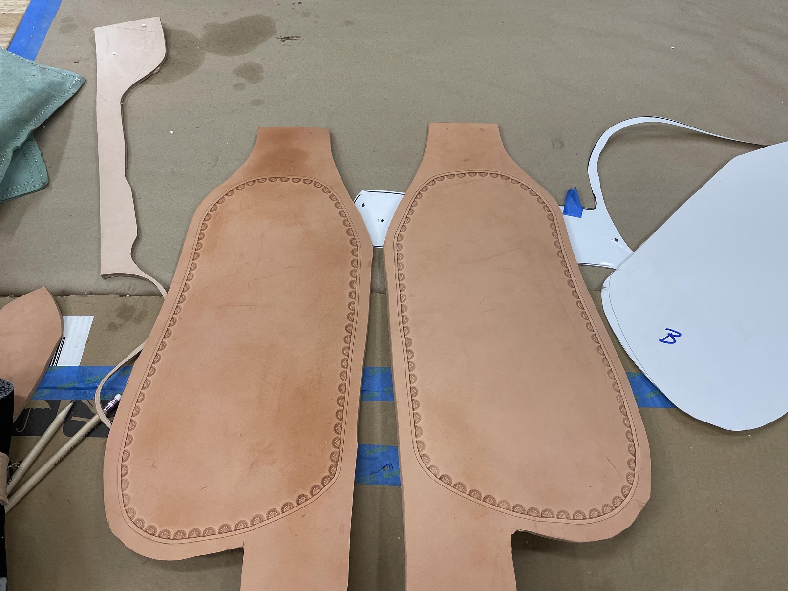

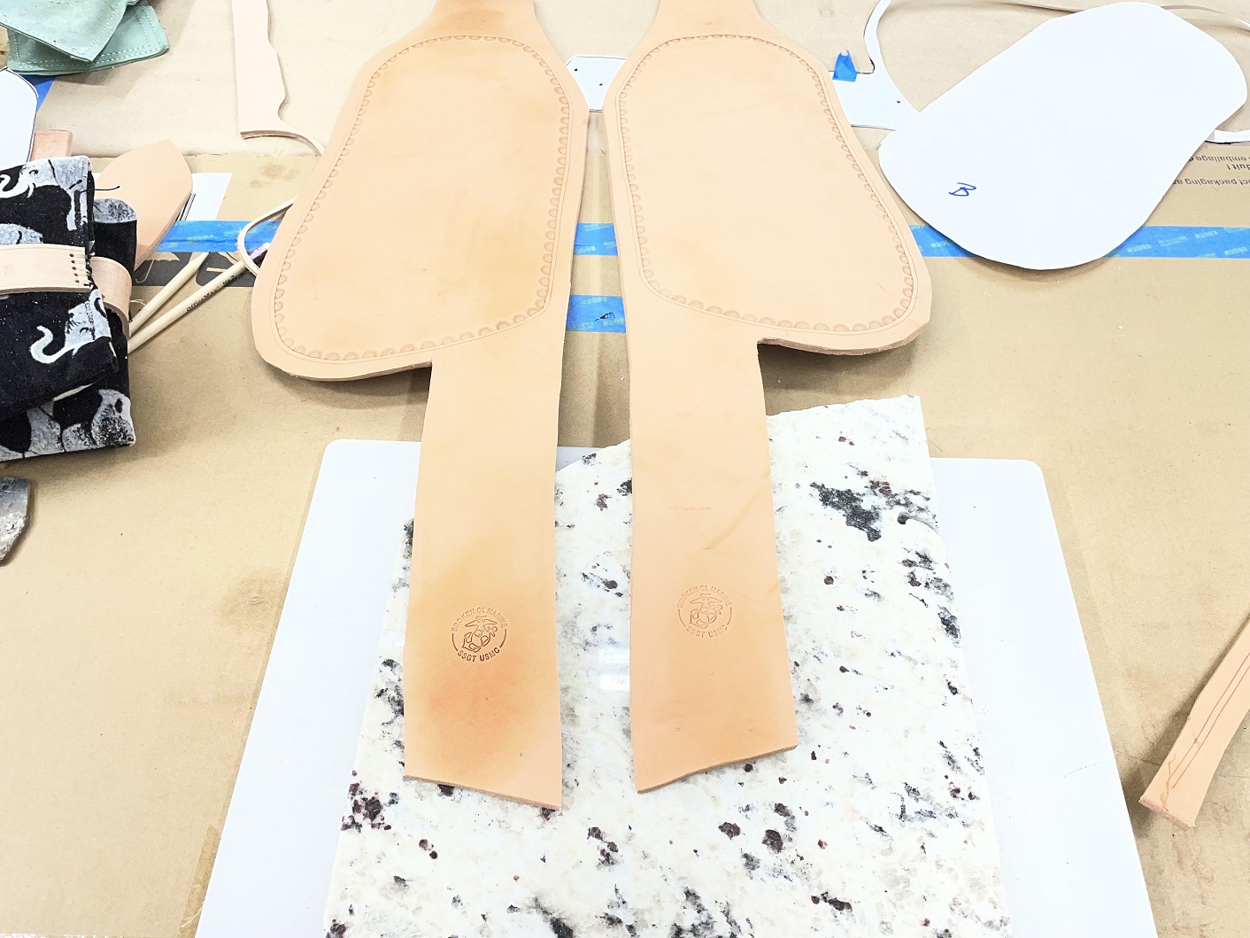

The second afternoon session got the tooling completed. Slow and Steady, with careful strikes to avoid misses that could cause skids with the tool, or bounces that could cause double strikes and mess up the entire line. I went around the inside of the double border with the half floral punch as the gal asked. Then I set my Maker's Mark, once on each fender. You can see the maker's mark at the bottom of the two fenders in the first pic below.
29 tooling done.jpg (373.28 KiB) Viewed 96 times
A closer look at the tooling in this pic. I haven't added any stain or color yet, but will before I burnish the edges of the components. I have been waiting for reference pictures of the saddle itself from my daughter.

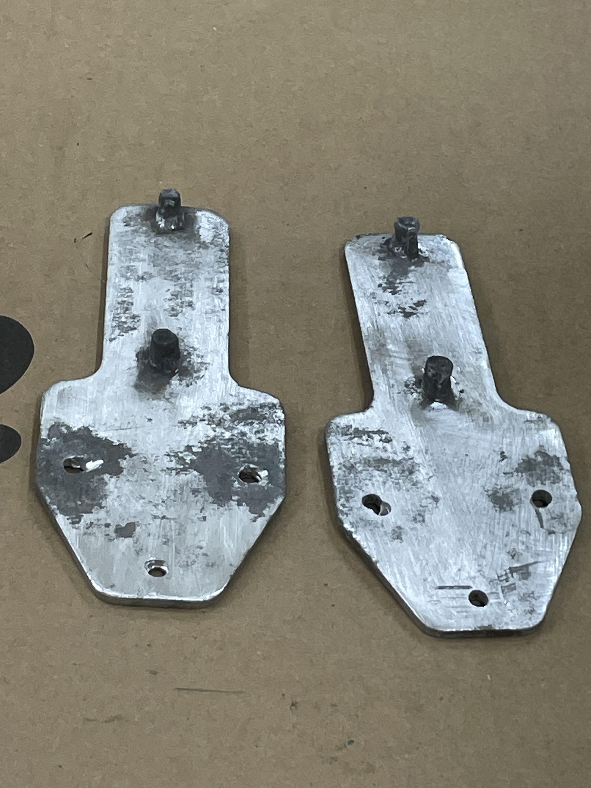

Before I called the afternoon's session done, I cleaned up the glue, rust, and accumulated dirt on the Blevins. The metal piece that locks into the holes on the stirrup strap. I had asked if the owner wanted to order new or re-use these, got no reply, so these will be riveted back in place. I can't get much cleaner than this due to pitting and stains... but they aren't seen when the saddle is in use, so she may not really care.

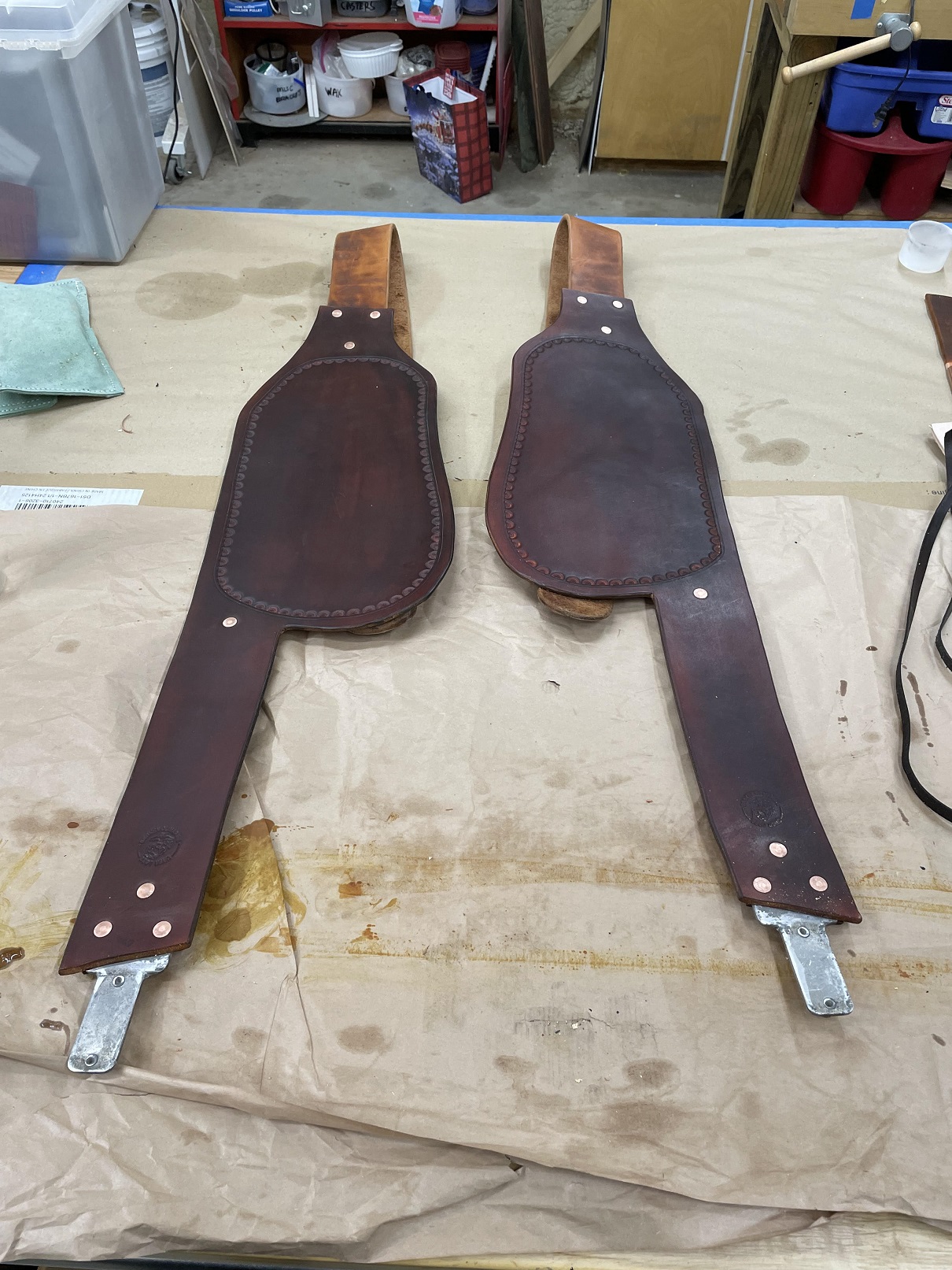

More Mink Oil, longer rivets and burrs, and additional Light Brown Dye. Good to go. I got out and treated the leather, dyed it with two coats of light brown dye, massaged it with Mink Oil to protect it, and then began, after a practice run at using the rivets and burrs, began the assembly. Slow and steady.
The Saddle Assemblies turned out pretty nice.
Back View:
32 Done back.jpg (593.84 KiB) Viewed 16 times
Front View:
33 done front.jpg (606.77 KiB) Viewed 16 times

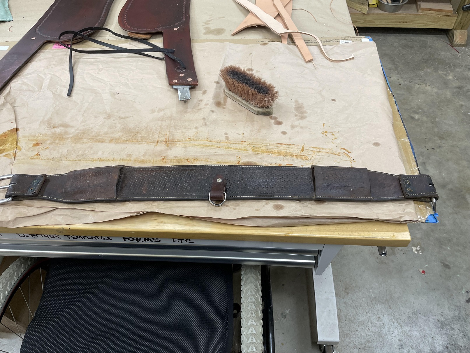

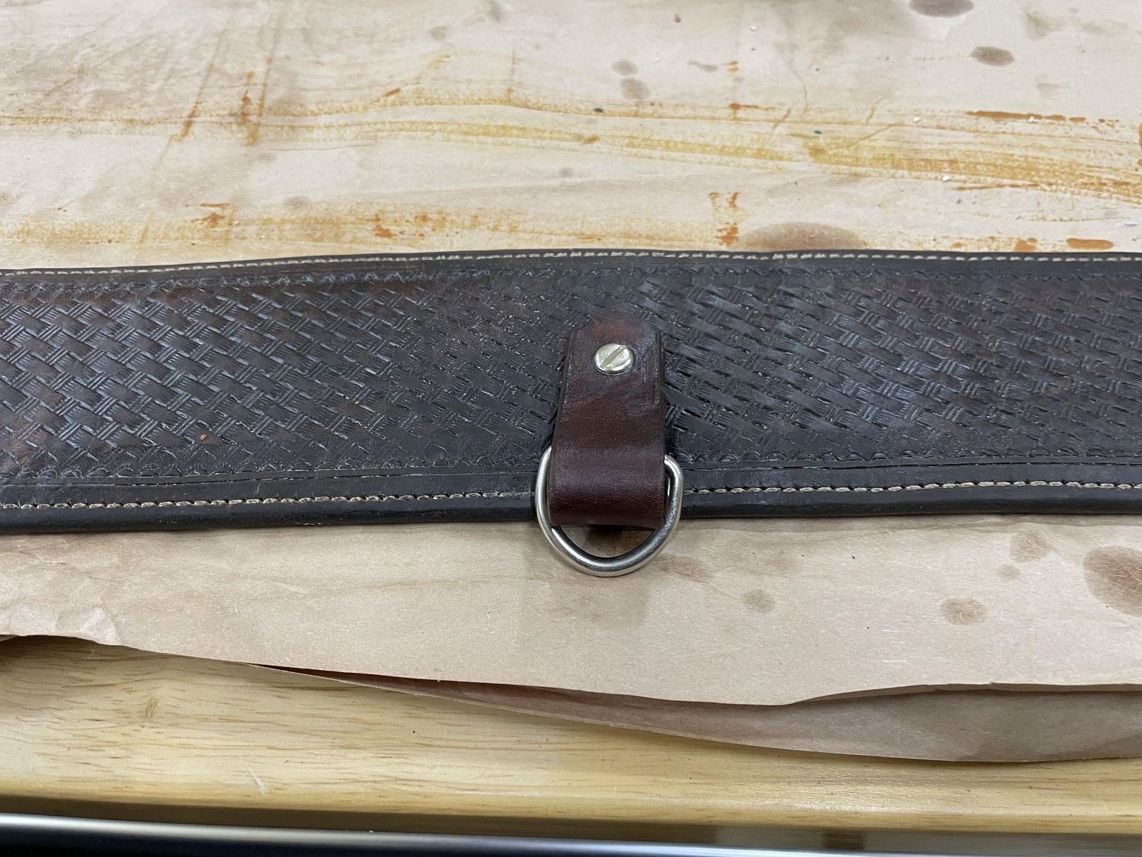

You may remember Miss T had to cut the stitching so I could remove the Rivet on the Belly Band to attempt to repair that broken loop that held the D-Ring. She discovered the two layers had been glued together. I proposed a repair that would work and the daughter's friend approved it.
Cut Stitches:
34 belly band laces.jpg (637.35 KiB) Viewed 16 times
Here is a long view of the Belly Band, which had been caked with sweat, oil, dirt and grime. I washed it with a toothbrush, saddle soap, and cleaned it up. I used a chicago screw and made a new loop. I put a dab of glue IN the chicago screw to keep it from backing out.
I repaired the stitching using saddle stitching and heavy waxed thread. Unless you were looking for it, you won't find it.
35 belly band washed and repaired.jpg (664.75 KiB) Viewed 16 times
A close up view of the new loop and d-ring. In this picture the belly band has not had the Mink Oil treatment. The owner needs to clean the tack every now and then and treat the gear with some preservative, it will last longer.
