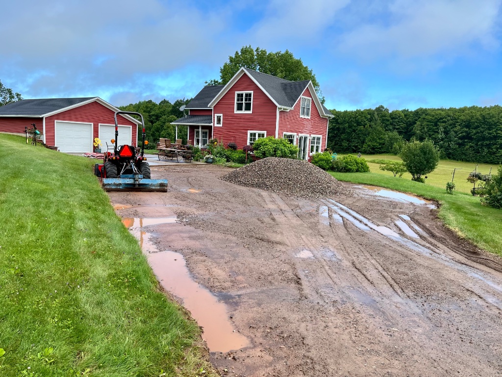

Post by Sir Henry » Fri Jul 15, 2022 11:53 am
I received 16 yards this morning in the pouring rain. We received about an inch and a half in an hour. The truck was right at 73K pounds. It had five axles counting the steer.
This will be the first of three loads.

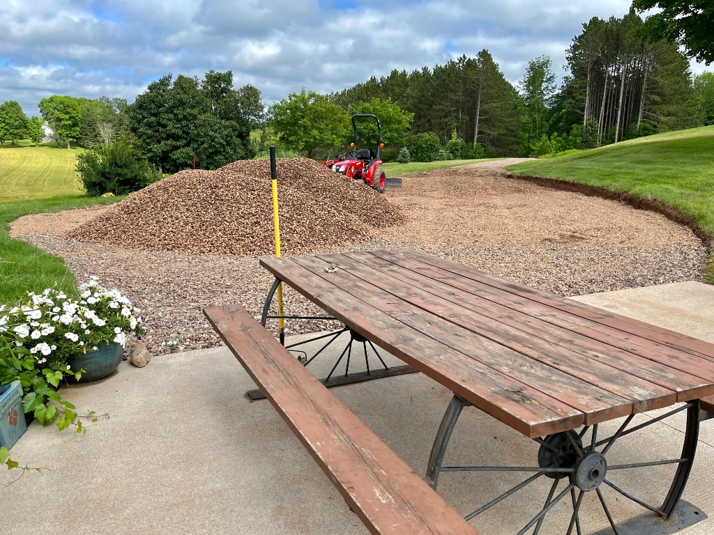

Post by Sir Henry » Fri Jul 15, 2022 7:04 pm
The third load.
I’m sure glad I bought the tractor. That hand raking is hard work.

Post by markiver54 » Fri Jul 15, 2022 7:20 pm
Hand raking gravel will break your back! Glad you got that tractor Gene! Should make relatively quick work of it. ☺

Post by Hatchdog » Fri Jul 15, 2022 8:00 pm
Yep, dump the bucket as you back up then back drag that dump with the bottom of the bucket. You’ll be done in no time.

Post by Sir Henry » Fri Jul 15, 2022 9:26 pm
That gets me halfway done. Then I have to backup and use the rear plow. I make several passes then lower it an inch and several more passes and keep repeating the process till it’s level.

My tractor is a tad small for this project. When I’m done with it, the berm and the backyard campground it will be the perfect size.

Post by Steve51 » Sat Jul 16, 2022 9:22 pm
I can see a "land plane" for a compact tractor in your future. They are great for maintaining gravel drives and filling potholes. Most are reasonably priced.
I really like the unique legs on your picnic table.

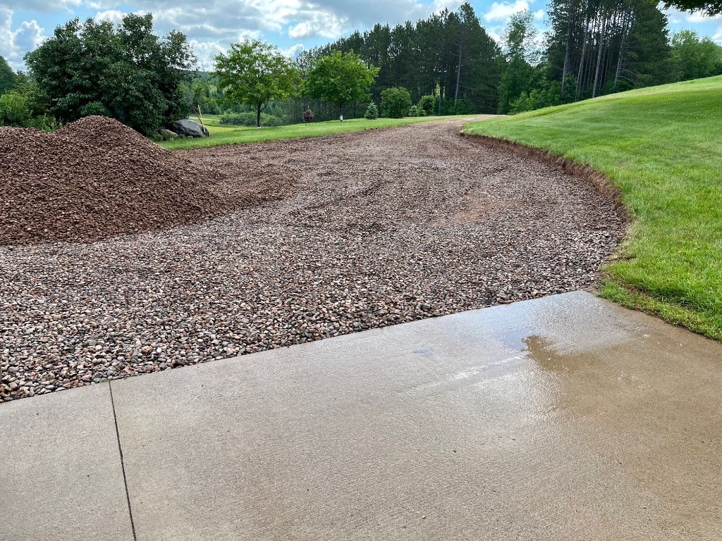

Post by Sir Henry » Sun Jul 17, 2022 11:41 am
I spread out most of my gravel. I need to finish removing dirt/clay in the backyard for my camping area before I can spread the remaining gravel there.
I don’t have the standing water on the concrete like I did and the gravel area seems to be draining too.

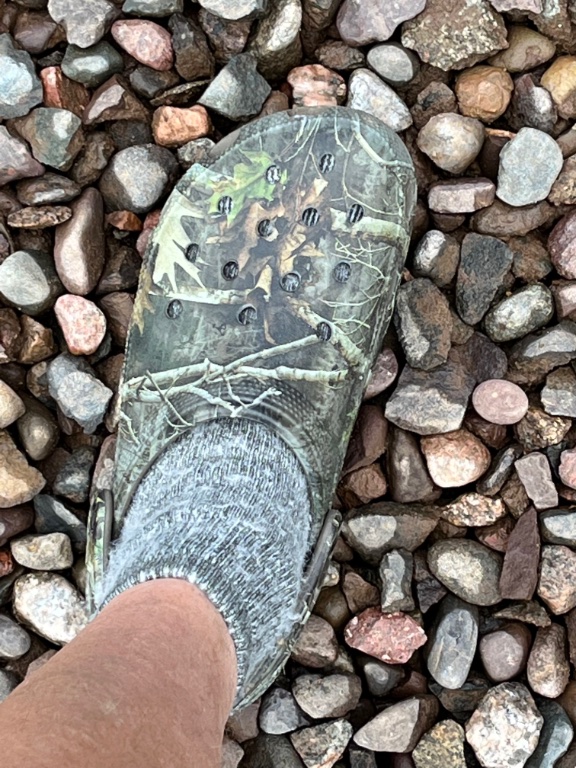

I wanted 5/8 minus however all they had was 1”. It will move around more till it’s run over a hundred times.

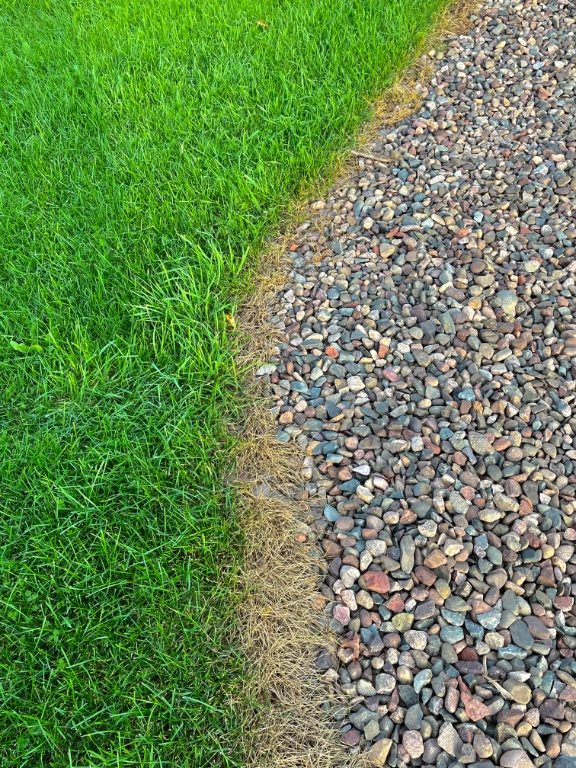

Post by Sir Henry » Mon Aug 29, 2022 7:44 pm
My turn around is complete and I sprayed a DMZ between the grass and gravel so I don’t hit gravel with the mower.

Good thinking
