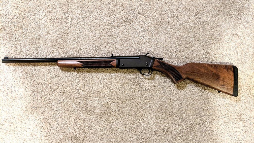

Had been wanting one of these for a while, but all the local haunts that carry Henry were out of stock. Working out of town for a few days, and had some time to kill yesterday evening. Spied a small gun shop while driving, in & figured it'd be as good a place as any to hang out for a bit. Saw the rifle on the rack as soon as I walked in, immediately thought "please be a .357"... and it was! As you can see, it's a looker for sure.
Got to shoot it today, and there's a lot to like. Handles great, and I like how it balances shooting offhand. Stock is not only pretty, but comfortable & fits me well. Best I can tell it's all high quality materials, and they're put together very well. Showed some good accuracy potential, though the two things I don't like so much will be a hindrance until addressed.
Those two things are the sights & the trigger, & I'm sure neither is a big surprise to anyone here. Knew all about both of these things before buying, so not going to call them "complaints"... they were expected. That said, they'll have to be dealt with to really bring out the full potential of the rifle (in my hands, anyway).
The trigger is actually pretty crisp, just too heavy at almost 7 lbs. Sights are functional, just not my cup of tea. Tough to get real precise elevation adjustments, & I really do better with a rear sight closer to the eyes.
So that brings me to the request(s) for advice.
First, does anyone know a source other than Grainger for the spring that'll help reduce trigger pull weight? They're out of stock right now... not a huge deal to wait, but figured it wouldn't hurt to ask if there are alternatives.
Second, has anyone added the Skinner rear peep that fits the Henry SS/NEF/HR? Interested in knowing if/how you had to address the front sight after adding the Skinner rear sight.

That is one sharp-looking .357 SS! Glad you found it...sometimes those small gun shops come through.
Only one thing. You said the stock was "pretty." Nope, it carries absolutely beautiful wood and grains on the stock and forearm. I'd say this Henry is a "keep-the-eyes-on-looker." After shooting it, I'd suggest that a special wall hanging would be a good place to keep it.
Hope the Skinner iron peep will work out okay. That is a quality sight, and will also look great on your rifle.

Welcome to the forum, Wolfman - congrats on a nice looking 357Mag Single-shot - one of the nicest guns for the money that can be had, IMO.
We have Henry singles in 44Mag and 45-70 and added the Grainger springs to both - best mod on the planet for a Henry single - it dropped the trigger pull to around 3.5 lbs on both rifles and makes them much easier to cock.. The Grainger springs come in a pack of ten, so I have a few extras - send me a PM with your address and I'll send you one - no charge - it would just sit around and collect dust here.
We also have a Skinner peep on the way that we will try on one of our singles, but it isn't the same one you are looking at - it's the Skinner "Low-Pro II" which is actually designed for the Browning SA-22. It's a peep sight that can replace the original sight in the dovetail slot - we're curious to see if it works in a Henry single - if not, well, we have a Browning SA-22 that it will go in...

Thanks for the warm welcome!
Supposed I did undersell the looks just a bit
, that stock really is a beauty. Henry must have a good source of walnut; haven't seen one of the single shots, either in person or in photos, that was fitted with a homely piece of wood.
That's a generous offer tractortad, will send you my address shortly. Hope that in the future I can return the favor in some fashion!
Just checked out the Low-Pro II... sure looks like it's about the same height range as the factory sight. If so, ought to be plug & play with the factory front. The Skinner rear sight looks pretty low too, but will of course sit in a higher plane being on the thick portion of the barrel. Imagine it'd just about have to be paired with a higher front. May give the Skinner folks a call tomorrow & see if they have a recommendation. Scoping isn't completely out of the question, but would really rather keep the weight, balance, and handling characteristics of the rifle as-is.

Welcome from the TV Oregon. You got one with really good looking grain in the wood!

That truly is a beautiful piece of wood. Remarkable for a standard grade gun, in fact.
If you want to preserve the balance, weight and handling, give some consideration to a red dot. This is one of the advantages of a red dot on a single sot or lever gun.

Welcome Wolfman...beautiful rifle. Continue to enjoy a great forum!

Welcome Wolfman. I have one of the 357 Single Shots also. The wood on yours is definitely nicer than mine is. Generous offer by Tad there and you will like the results. I have a Burris 2 x 7 x32 on mine so I cant help you with youre choice of sights. But I do like my 357 and I have shot about 300 rounds thru it so far.

Replaced the factory springs with the Grainger spring tractortad was so kind to send. Went from a five pull average just under seven pounds to a five pull average just under four pounds, & feels worlds better. Still very crisp, with no creep or gritty feeling. Will get out to the range in the next couple days to check on the firing pin strikes.
