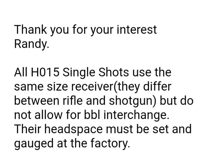

I sent an email to them a short while ago asking about the receiver strength and if the differed between pistol and rifle.
Here is their response.
