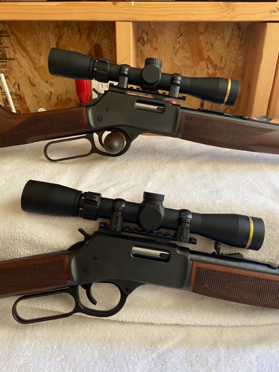

This is a Henry SS with a 3-9x40 Nikon. I used Warne “Low” rings. Allows acceptable cheek weld, clearance to keep and fold the rear sight, also clearance for the hammer with the aid of a hammer extension. If the power knob on the scope is to large then medium rings will be necessary. Also a SS with a 4.5-14x42 Burris and UTG “Low Pro Max Strength” rings. Couldn’t use the Warne rings here as the mediums were to low and the high to high. The hammer does not strike the scope. I did cut off the extra base material. The hammer extension is a must have. I am a lefty so don’t get confused. Merry Christmas.
- 1DE83003-DBFA-471F-AACF-047D22D8723B.jpeg (195.88 KiB) Viewed 6298 times
- AE268ED7-AC31-4D7E-AD69-2C3552828F65.jpeg (115.6 KiB) Viewed 6298 times
- 55382B4C-ABF0-4AA9-8B33-1FC66B1DDA6C.jpeg (134.46 KiB) Viewed 6298 times
- 85FBE64F-223F-4E77-887E-AA5FE68478DC.jpeg (320.42 KiB) Viewed 6298 times
- 0257C398-14C3-4E1A-A794-4F8BDD1EACA1.jpeg (171.05 KiB) Viewed 6298 times
- 0B64C081-86A9-4BDA-BF77-F79752DEEF0D.jpeg (201.52 KiB) Viewed 6298 times
Last edited by Bear-of-Grayling on Tue Dec 22, 2020 8:53 am, edited 1 time in total.

That’s great that your single shot has the folding rear sight. The Big Boy’s have the ladder rear that does not fold so some have to remove the sight to mount a scope. Nice to have a scope that size mounted so low, your set up looks great. Thanks for the pics.

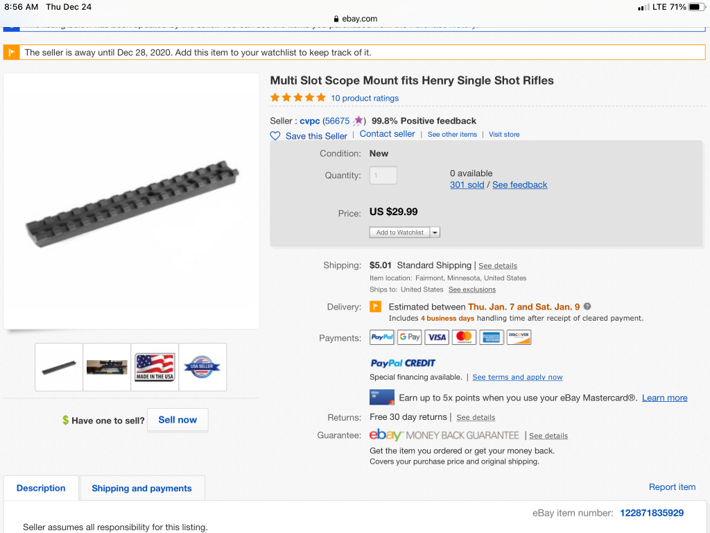

Hello everyone. Back again for an extra FYI. If the scope was damaged/failed on a hunt or one wanted to use the open sights, the base I used (in the pics a few posts back) is too tall for the usage of the factory sights. Below is the base I used on both my Henry SS. It is not as in the picture. That’s a generic picture. It was a cantilever style and I removed the excess material. So a take-off ring is rather pointless with this base as the base would have to be removed to use the open sights. Might help someone. Thanks
- F24E5902-8582-4C66-95D4-5D79C7CDF6A4.png (302 KiB) Viewed 3874 times
