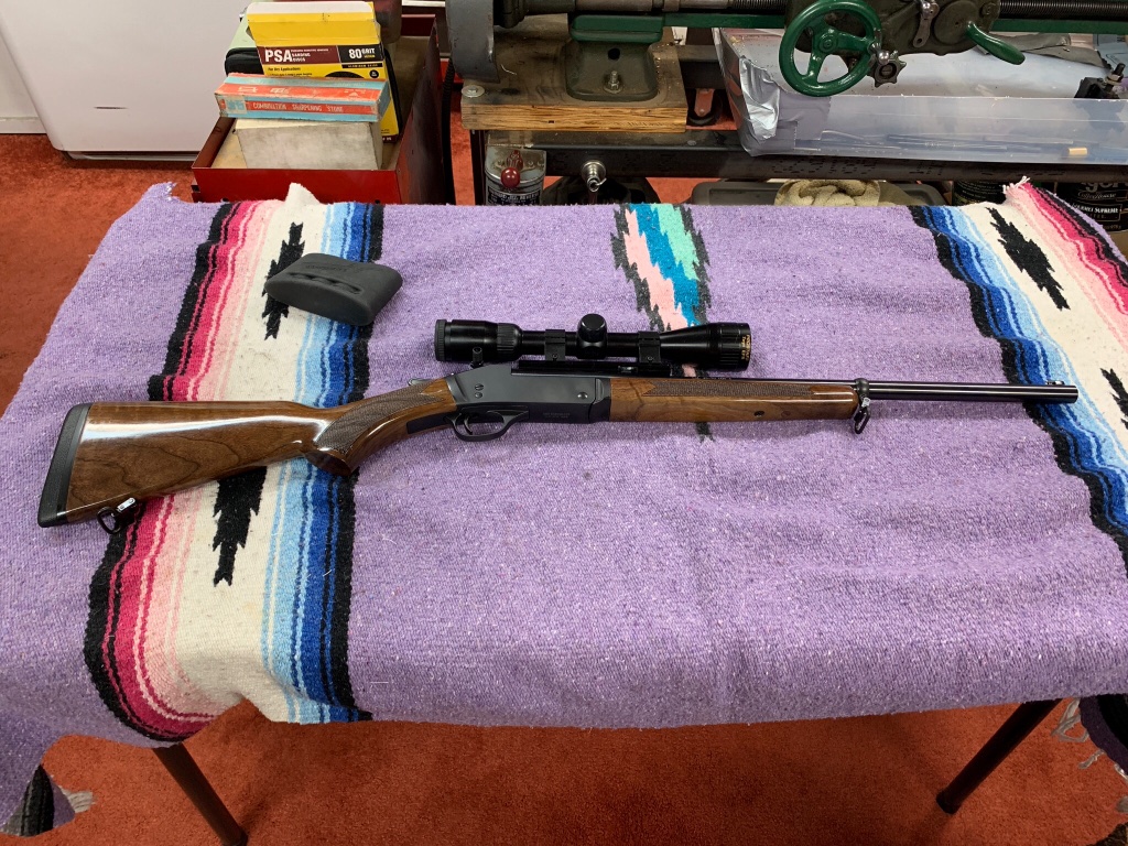

OK finally got it out to the range happy with the way it shoot. But it does have a small problem. As I am a little guy 6 foot five 250 pounds length of pull 16.5 inches organs are slightly small so I use a recoil pad slip on to add the length it I’m used to it so it works. But my rifle did come missing a screw Henry’s sent me one overnight. When I went to them about the new problem they told me to read drill the sling mount in the front but if I break the forearm I would have to buy a new one. Really no help so I fixed it myself I know longer have the sling mount chewing on my fingers. Love this rifle. And I hope spellcheck doesn’t change it to raNg time.

Ouch on that last picture? Filling the hole and adding a tube clamp - good solution.

Ouch! Your modification looks like it worked out OK, though. As I think about it, some single shots do come with a barrel band as original equipment, Ruger #1-A, for example. So not only did you solve the swivel stud bite problem, you made an upgrade ;) . I'll leave mine alone, though, since I'm short :) .

well tried everything paper patched ,bullet set forward ,black powder, 39.4 grains of imr 4198 shot best. so i went ahead and reamed it to 45-90. 85 to 90 grains of black powder, 29.0 to 39.0 of 5744 500 grain fnlead ,the imr 4198 hits harder than eaither black or5744. 40 rounds of 45-90 in the h015 and 50 rounds of imr4198 in my marlin 1895gbl all to day shoulder feels fine. in the stock there is a hole it,s near 4 inch deep .866 wide 2.8 long i put a small bag that i made in there and filled it with # 9 shot . with scope it came out to 10.2 pounds.a real joy to shoot.will post photos tomarrow. thank you all for your coments.

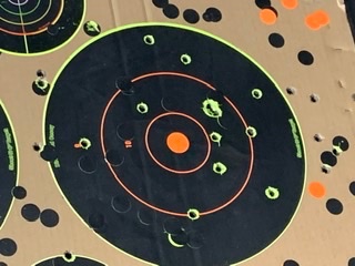

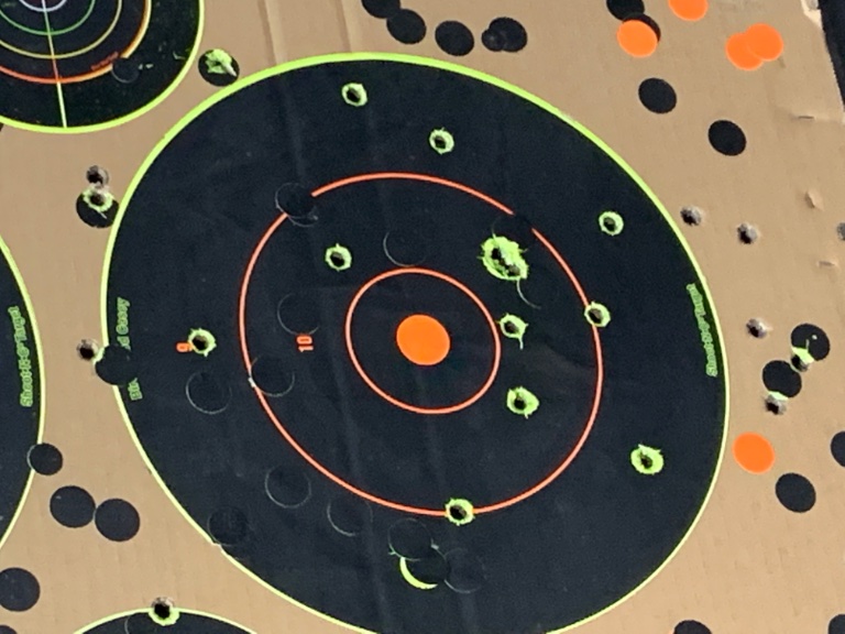

Here is one target sun in the eyes blood sugar low shakes. Ok just bad shooting on my part.shoulder feels fine today so I will get her sighted one this week.Image this is at 100yds

Good to see your targets. Keep at it you'll get it dialed in.

sighting in our CCH 45-70 to fire full power hunting loads wasn't fun .... I've been wondering about the recoil from firing a 45-70 single shot from a bench .... it appears you have a handle on doing so
