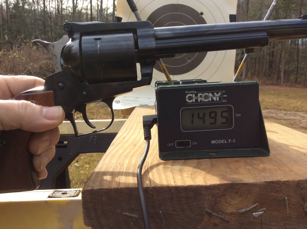

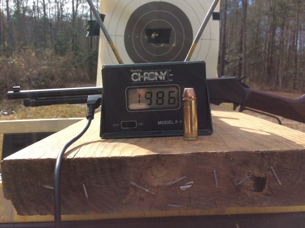

I then ran my loads across the chrony and was VERY happy to see 1948-1986 FPS out of mine. Just for grins I shoot a few thru my Ruger
SBH with 7.5 barrel and got 1520's and a nice booming report too! :lol:

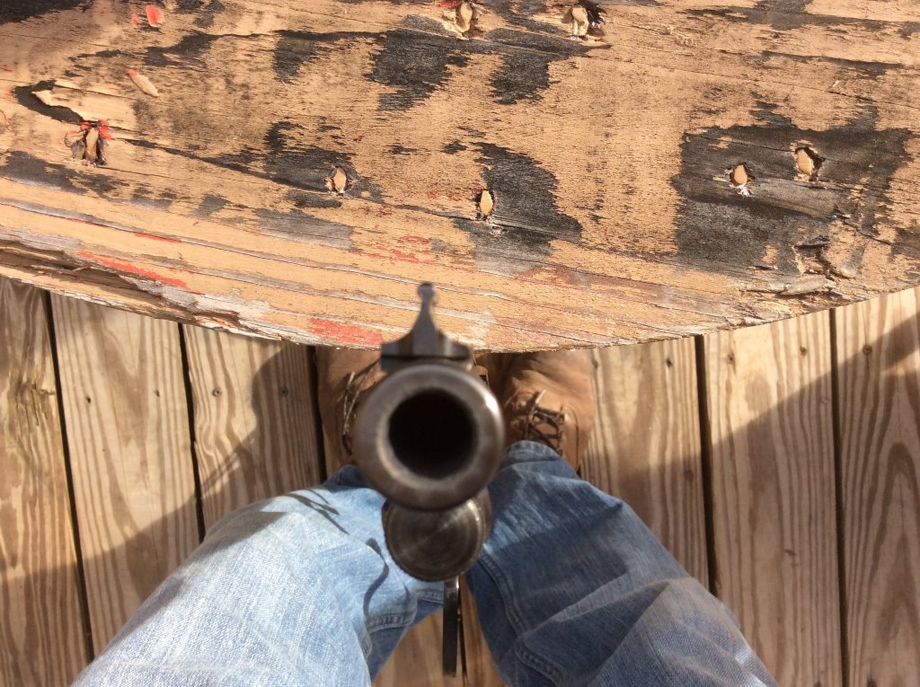

I then noticed my shots going to the left from 50 yds. and thought that was a bit off. Then I notice the front sight of my Henry is way off to the right but as you look at the muzzle it is off left.
So I corrected that and got much more centered. Looked to me maybe my loads a bit tighter in group than the Underwood Ammo but that could be just me. Anyway very happy with my load results and will load up some more. These should work very well for small critter loads and self defense load in a revolver or rifle. For large 4 legged beast stick with 240-250 gr. loadings.
Henry BBS Carbine 44 mag sight off to right..jpg (222.04 KiB) Viewed 2869 times
44 mag 180 gr load with 2400 powder out of SBH.jpg (131.22 KiB) Viewed 2865 times
shot out of Henry BBS carbine.jpg (131.39 KiB) Viewed 2867 times

Don't know how the front sight move and don't remember rifle getting dropped.
To move it back without my punch with me I placed on the work bench in my range shed and placed a small piece of wood under barrel.
Then took a spent .44 case and taped up the case head. Insert a 3/8ths bolt into the case and tapped on it with hammer.
Moved the sight blade over slightly without marring surface.
