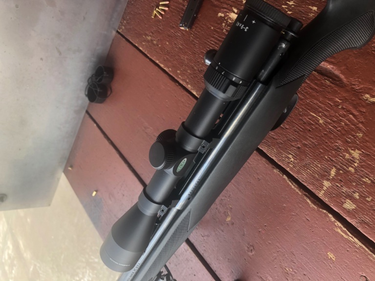

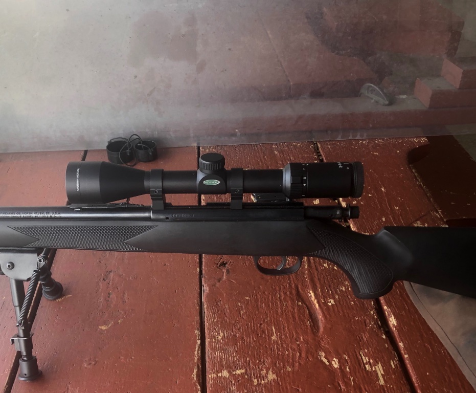

Post by ditto1958 » Sun Dec 22, 2019 12:43 pm
The new Weaver 3-9x40 on my Marlin:
