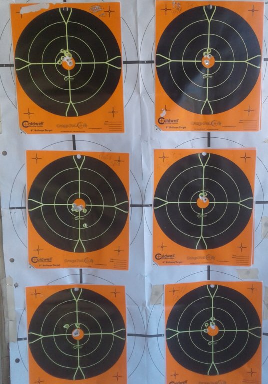

Post by Ojaileveraction » Tue Oct 22, 2019 7:36 pm
Went to the range to test some reloads with my chrono.
Target at 15yrd
Not much distance but first time seeing any groups from this rifle.
The Magnetometer may alter trajectory in addition.
Mid left, Reminton so 86gr 1430 fps average
Top left 86gr MBC coated 9.5 H4891. Got a no data reading so had to reset and put a few thru.
Top right. Same as above average 1410 fp
Mid right same bullet 9.4 h4198 ave, 1390
Bottom left 86gr MBC 3.5 Trailboss 1100 ave
Bottom right 3.4 TB 1050 ave

doesn't look too bad to me but I know nothing about a 25-20 .... where do you go from here ... :?:

The Trailboss loads loads would fine for plinking or closer in small game hunting.
The H4198 is just what I want for PC Silhouette. A five inch drop between 50 and 100 meters. With plenty left to knock down a 1/2 size Ram.

Do you really think there is a 5" drop between 50 & 100?

That mid right target looks good to me. I like the new addition to the avatar to Ojail
Well 4 inches anyway. It is possible to get above 2000 fps at the expense of the brass. Something I'd do if hunting, but again, being in Cali, I'd need a nonlead bullet.
Next I 'll have to shoot some distance and see what it looks like at 50 meters.
I was in a groove with that group.
Definitely have try out that load at 50 meters.

Yes, can see that. Good job.

Raining here today, so I loaded up 10 of the 9.4 H 4198 loads with a 85 gr cast.
Stepped out on the back porch and went to swinging the 6" gong, 8 out of ten.
It's roughly 50yds to the gongs.
