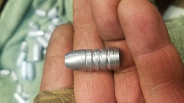

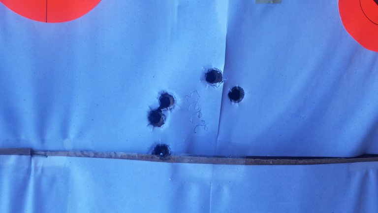

Had it a couple months now and have gotten some 1.5 inch 4 shot groups at 100yrds with iron sights with jacketed rounds . But im a cast bullet type guy and the barrel was a little to rough , and a couple tight spots so cast bullets would foul out pretty quick and i would start getting flyers .
So i hand lapped the barrel and mounted a scope just for some test runs today . Pretty satisfied with the result , pretty stout load .... 434gr Flat nose over 46grs of H322 seemed to group the best today . Ended up with a little over 2"
5 shot group@110yrds after 40rds and no fouling issue . Hopefully get it tightened up a little more , but honestly its hard to keep it on the sand bags with that load lol I'll work up some lighter loads to see if i can get some better accuracy out of it , but these here are my Brown Bear loads ....... I shot my 6"Γ—8" 3/4 inch thick steel cutting edge , hung by 3/8 chain at 100yrds and blew it clean off the chain ....... should've got pictures of that lol the welds on the chain pulled apart and it strecthed out the links πŸ€”πŸ€”

Both really , for the large bears we have large bore cast bullets are king of penetration and stopping power . I can adjust hardness of lead , i can shoot thousands of rounds of lead and not wear my barrels down . I like big fat meplats for hunting , there are a lot of jacketed bullets that separate from the lead and loose penetration in my opinion and i dont what a bullet that explodes damaging lots of meat . I seen videos of 45-70 FTX bullets that shot deer and bullets broke apart ..... i didn't like that , but they are accurate with my testing . I just don't trust them on a potential charging 1,200lb bear lol
But im sure there are plenty of jacketed bullets that would get the job done , but cast bullets are pretty much the go too up here for stopping power and penetration.
