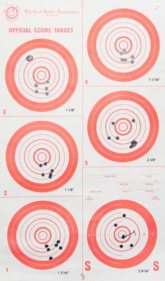

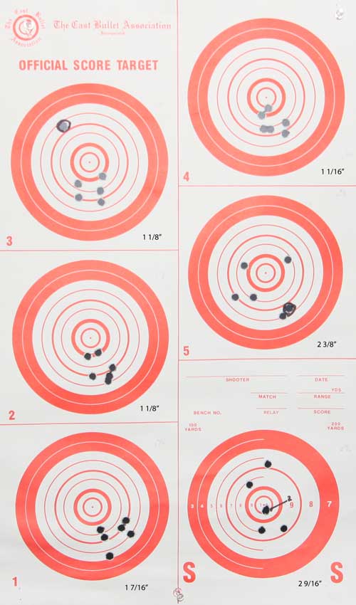

Here's the target I shot yesterday with the steel Henry .38/.357. Took the opportunity to also chronograph the loads. Interesting as the results below will show.
This is the 2nd test using Alliant Bullseye and the Ideal 358411 bullet and shot at 50 yds.
Target# 1; Powder chg.- 4.0 grs.; M.V. - 1101 fps; Std. Dev. - 8.050; Ex. Spread - 20 fps
Target# 2; Powder chg.- 4.2 grs.; M.V. - 1129 fps; Std. Dev. - 7.626; Ex. Spread - 23 fps
Target# 3; Powder chg.- 4.4 grs.; M.V. - 1172 fps; Std. Dev. - 4.176; Ex. Spread - 13 fps
Target# 4; Powder chg.- 4.6 grs.; M.V. - 1199 fps; Std. Dev. - 3.464; Ex. Spread - 9 fps
Target# 5; Powder chg.- 4.8 grs.; M.V. - 1228 fps; Std. Dev. - 6.968; Ex. Spread - 19 fps
Target# 6; Powder chg.- 5.0 grs.; M.V. - 1268 fps; Std. Dev. - 6.818; Ex. Spread - 15 fps
The round circled on target #3 is the first round in the group. I have no idea why it's there. The one circled in #5 is too.
As you can see the S.D. & E.S. get smaller till target 5 & 6. As it turned out I picked up a little Leading and suspect it started at 5 & 6. Groups get noticeably larger too. So looks like that's about the limit for Bullseye in my gun.
Time for another powder and a better bullet.
did I leave anything out? Right now don't expect the data layout you see above. took about a 1/2 hour to get to look that good.

Thanks for the kind words. Sometimes I wonder if I'm making any progress.
