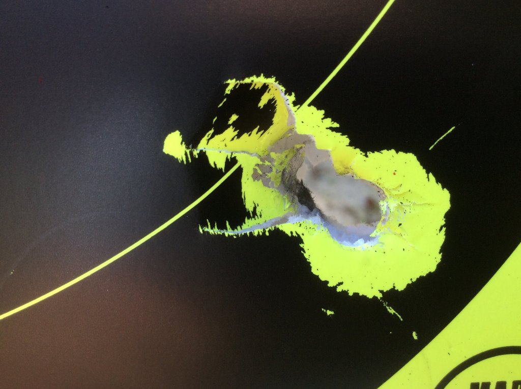

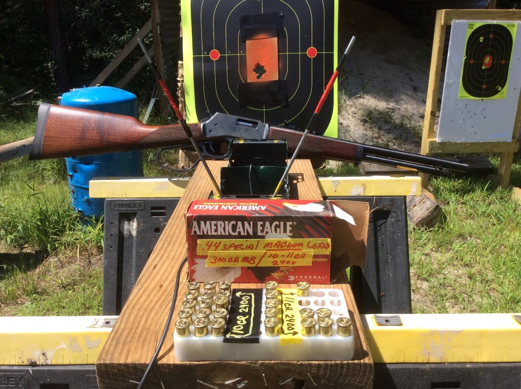

Got down to my range this morning to see how my .44 Mag BBS Carbine would handle these mild 300 gr loads in .44 Special case.
This idea was so I could try my MB 300 gr. bullets using the 44 Special brass for a shorter than 1.700 COL. which would feed thru the Henry.
The 10 gr. 2400 loads clocked out at 927 to 945 FPS in the Henry where the 11 gr. of 2400 powder loads were in the 1160-1230 range.
However the Henry seemed to like the slower 10 gr. load being the one that delivered a nice group from 40 yds.
The 11 gr. load was for some reason all over the place with a possible key hole from looking at one impact hole.
Both loads were on target when testing for FPS over the chrony thru my Ruger 7.5 SBH.
Another strange happening was when shooting the 11 gr. loads thru my SBH revolver I would always get a error reading on my chrono but when shooting other loads including the 300 gr. with 10 gr. of 2400 I would get a reading.
The 11 gr. loads looked to be in same target area with no key hole but would no register a speed.
Anyway what did this all prove??
Well if I wanted a real easy shooting 300 gr. bullet load that would feed thru the Henry,using this particular MB bullet, 10 gr. of Alliant
2400 powder might be one!

Nice, what did your oal end up being?
- fortyshooter
- Ranch Foreman
- Posts: 7089
- Location: Va.
Re: Testing the 300 gr. 44 special loads.......
The OAL was 1.575 using the factory bullet crimp groove. I made 29 of them total since that was all the empty .44 Special brass I had
at the time. I had wanted to shoot a few thru my S&W M69 5 shot 44 mag revolver but ran out.
The .44 Mag case loaded with these 300 gr. bullets measures 1.700-1.705 and come close to the end of the cylinder in the M69.
Might load up some more.

The 10 gr. of 2400 powder 927-945 FPS loads seem to shoot fine. It was the 11 gr. load at over 1100 FPS that had some grouping and possible key hole issues.
