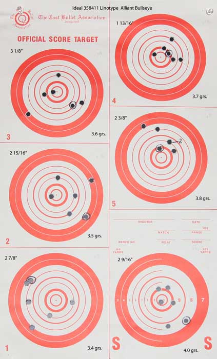

Finally had a chance to get out shooting yesterday between rainy days.
As you can see by the target, not so good. Since I was going to try using a little heavier bullet (155 gr.), to eventually use at 100 yds., I thought I'd see what I could do using Bullseye since I've probably got enuf to last the rest of my life.
Wasn't sure where to start so got out the Lyman #4 Cast Bullet handbook and an old copy of the Speer #11 I had laying around. MAN!! Talk about a difference in handbooks. The Speer recommended going from 3.5 grs. to 4.0 grs. The Lyman manual started at 6.2 grs. and went up to 6.9 grs. Not wanting to stick my neck out to far considering I don't know anything about Lever guns I thot I better go with the Speer chart.
Doesn't look like much in the way of groups, so think I'll go up another gr. next week.
Pete

not bad at all for an initial group .... in fact, I've seen bunches of groups, after a good bit of fine tuning, that weren't that good .... you didn't say but the holes appear to be from 38/357's .... it will be interesting to see how upping the grains affects the grouping

What is target diameter? And what distance (yards) did you have targets set up at?
Yes, and as JEBar asked, what caliber? All would be good to know, because they tell a larger story.

Pete wrote:Finally had a chance to get out shooting yesterday between rainy days.
Pete

Sorry. Did forget some the vital info. The target is the one used in the Cast Bullet Assoc. matches. The 10 ring is 3/4" with the dot at 1/16". If you look at #6 you can see the same target is used at 100 & 200 yds. I just use this target since I can shoot all my test rounds on one target and when I post the target no one can I "cherry picked" the best one for "show & tell".
For testing I used the Henry .38/.357 (picture in an earlier post). I shot these at 50 yds. After I go thru a few powders I'll pick the best of each and go back to 100 yds. where I'll probably use the ASSRA 100 yd. target.
As mentioned I'll start going higher with powder charges going up .2 gr.per load, till something tells me I better quit.
