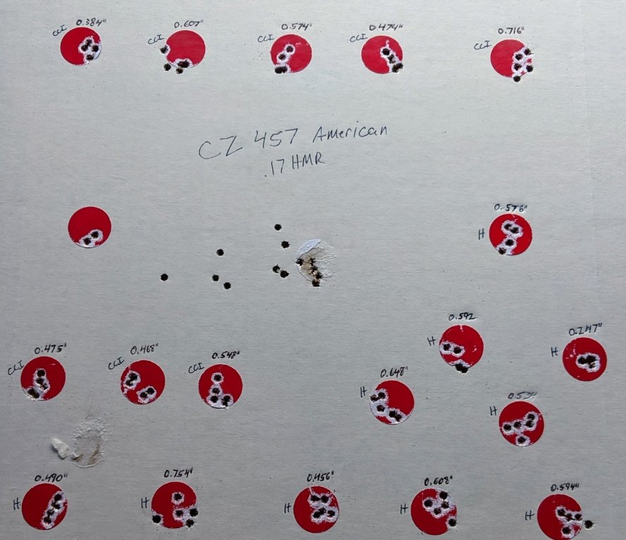

Picked up a new CZ 457 American in .17 HMR, gave her a good cleaning & hit the range yesterday. Have a lot of experience with CZ rimfires (452 & 455), but this is my first .17 HMR & first 457. Took three boxes of ammunition, though I wish I had read up on .17 ammo a bit before purchasing. Turns out the Winchester I bought is widely regarded as junk, and the only five rounds I shot support that premise- roughly 4" spread at 50 yards, and all five cases split at the neck. No idea what to do with the rest of the box, certainly no interest in shooting it. The CCI & Hornady 17 grain V-Max are essentially the same, both made by CCI from the same components. Oh well, at least it might lend insight as to lot variation. All results shown below, good bad & ugly. Mess in the middle is from rough zeroing, & variable POI due to slight scope adjustments between groups to my satisfaction.
As expected, little difference between the Hornady & CCI. Ten 5-shot groups of Hornady averaged 0.550", eight 5-shot groups of CCI averaged 0.531". Can't quite call it a 1moa rifle at 50, but close. Torque on both action screws set at 20 in/lbs, will experiment with that to see if minor improvement can be had. Also want to try the 16 grain lead free ammo, and some flavor of 20 grain.
All in all, fairly happy with the precision & consistency. As with all rimfire, results are beholden to ammunition quality. I suspect with "match grade" ammunition (unfortunately, no such thing in this caliber) it might be a real tack driver.

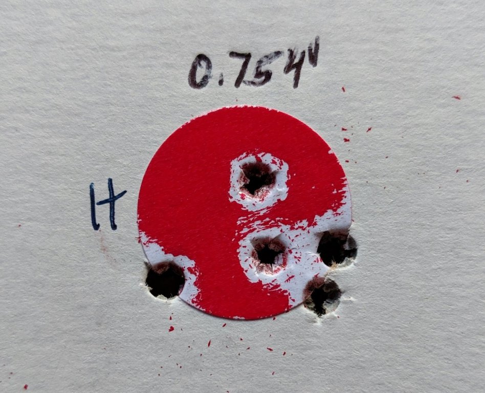

Cherry pickin' time, I'll start with the bad. Though really not all that bad for the worst group of the day (sans Winchester).

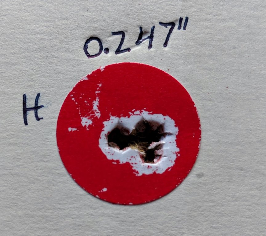

Oh if they could all be like this one...
