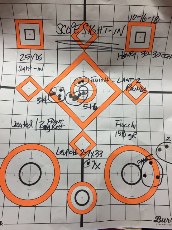

I guess all the usual caveats/excuses/rationalizations apply: brand new rifle, new scope, never fired this caliber before, PLUS I mounted and zeroed in my own scope this time around (I know, not a big deal, but…).
Bottom line is I think it’s getting there, with these two targets representing 50 rounds fired, spread over 6 different brands of 30-30.
The first target was 20 rounds of Fiocchi 150 gr JSP that I used to get the scope zeroed in. So much for my end-of-the-barrel, magnetized bore sighter. Thought I had the scope all adjusted to where the bore sighter said I should be, and ended up low/right (Group 1). Over-compensated (see "3 and 4", but kept adjusting and tweaking, getting closer over the course of 6 ea. 3-shot groups (see "5 and 6"). The last two shots are so marked ("Finish-Last 2 Rounds'), about 1" high, which was my goal.

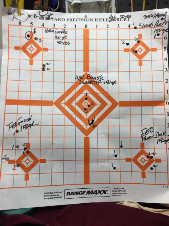

The second target started with the scope set at where Target #1 left off, beginning in the upper-left corner, using 160 gr Hornady LeverRevolution. First shot was so far off it blew off the binder clip that held the target to the cardboard backer. The next 2 weren’t that much better. So much for a zeroed in scope...
The ammo used on Target #2 is marked, and the progression is clockwise, starting at the upper left, moving to upper/right, then to lower/right, then to lower/left, finally ending up with the fifth ammo brand in the middle. All ammo brands were given 2 ea. 3-shot groups. There were lots of little niggles along the way on the scope, but I saved what will likely (?) be my hunting round for last – the Winchester 150 gr SilverTip. Each 3-shot group is marked “1” and “2” for each ammo brand (hope that makes sense).
Once I'd run the gamut, I went back to the upper left to shoot one more 3 shot group of the LeveRevolution (since it only got 1 3-round group to start with) just to see how all the scope fiddling might have affected the results of that original dismal display. Better, but still not stellar.
Overall, I’d say the best group is marked “2” in the lower right (the 2nd 3-shot group), which is the Federal Power Shok, a round that I believe Mags had noted was doing very well in his Brass 30-30 (right, Mags?).
Even with all the reloading after each 3 shot group, marking the target after each group, etc., the barrel still got pretty warm, but I don’t know whether that made things get better or worse (or didn’t matter at all). All in all, lots of variables and tweaking of the scope, but my two “finalists,” based on today are the Win Silvertip and the Federal PowerShok. Seemed like almost every 3-shot group had a flyer, but that’s just operator error, not the rifle or the ammo (believe me!).
Functionally, there were absolutely no mis-feeds or ejection issues. Ejection, in fact, is very consistent and purposeful. It ate and spit out everything, in other words. There were a couple of instances where some wiggling of the mag tube was necessary to get it fully inserted, but I attribute that to me just never having loaded up rounds of a caliber this large via the tube magazine. Quite a bit different than .357!
So, there you go. From un-boxing to scope mounted to zeroed in to determining an ammo (or two) of choice in under 48 hours, and the CCH looks even better with a little oil rubbed into it!

Exactly right to try all the various brands of ammo with a new gun like that. You're getting, there, so keep at it. Another factory 30-30 factory load that has been very good in my Marlins and Winchesters has been the Hornady American Whitetail 150 grain Interlock ammo. Very competitively priced, unlike the Leverevolutioin stuff, and that Interlock bullet has a long track record for good performance.

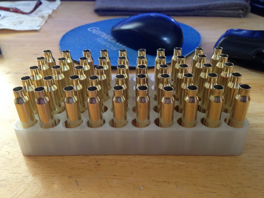

E - just for you - I sized, trimmed & deburred and tumbled 50 .223 cases today!
Re: CCH 30-30 First Outing
That's a beautiful thing! Do you do 30-30s as well? Or 308? Or 357 Mag?
I might change my tune, but I'm drawn to the reloading concept because of rifles, not handguns. And, it takes a lot of reloading to keep a really active handgun enthusiast stocked, I would guess.
There's something more scientific and exploratory about figuring out different configurations for rifles, at least in my head.
Those are some fine looking cases!
