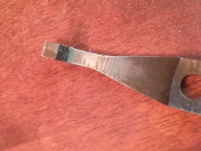

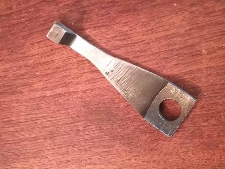

So I did some research... Mosins weren't exacthy made to high standards. Turns out the sears were often left with very rough surfaces. This one was no exception! A little work with a needle file and 600 grit sandpaper went a loooong way to smoothing the trigger and lightening the pull. Below is before and after.
