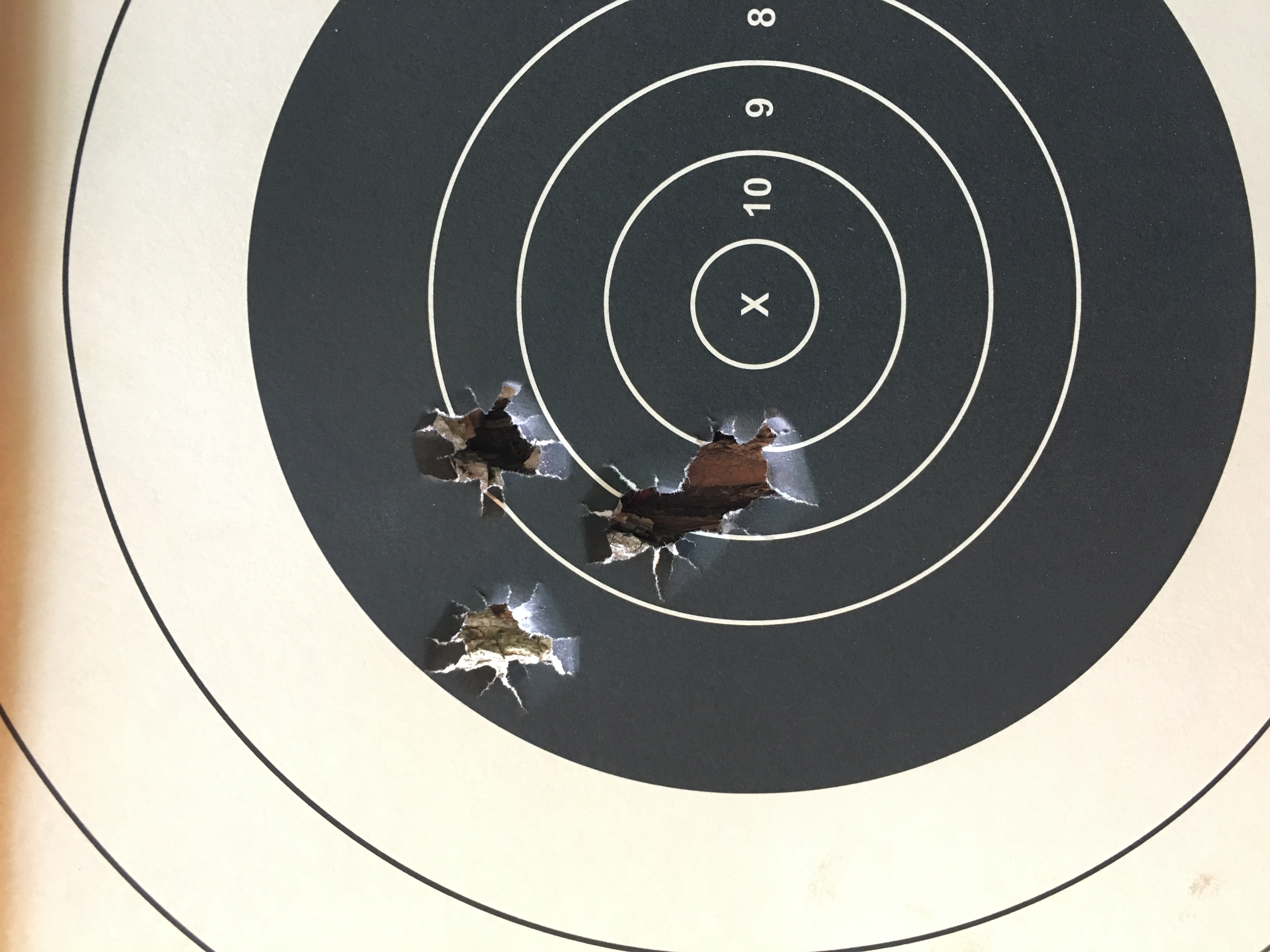

Starting to get my bearings on some loads for this deer season. I haven't done any loading since winter, let alone any shooting.
My son will likely be using my BBS 45 Colt carbine this season. I've got 225 FTX and 240 XTP Mags. Starting with the FTX, for now. HS-6 and H-110 powders. 1.700'' oal. Just barely cycles through the action, but it does. 14 grains of HS-6 gave me a roughly 1.5" group at 100 yds. 27 grains of H-110 was around 2". I was using a lead sled to ensure consistency.
Needless to say, I think I'm off to a good start. Here's the only pic I took. 5 shots there. HS-6 load.

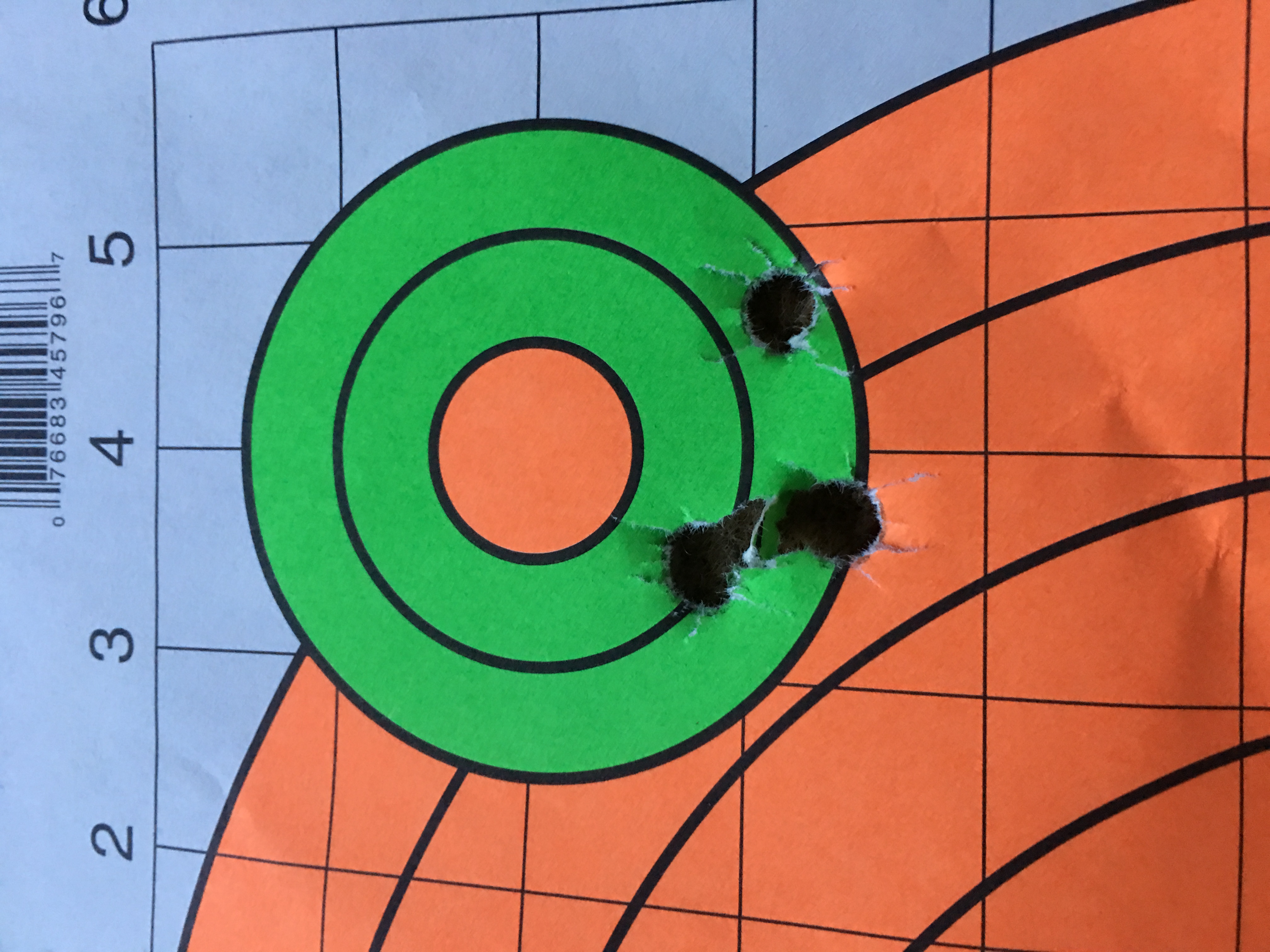

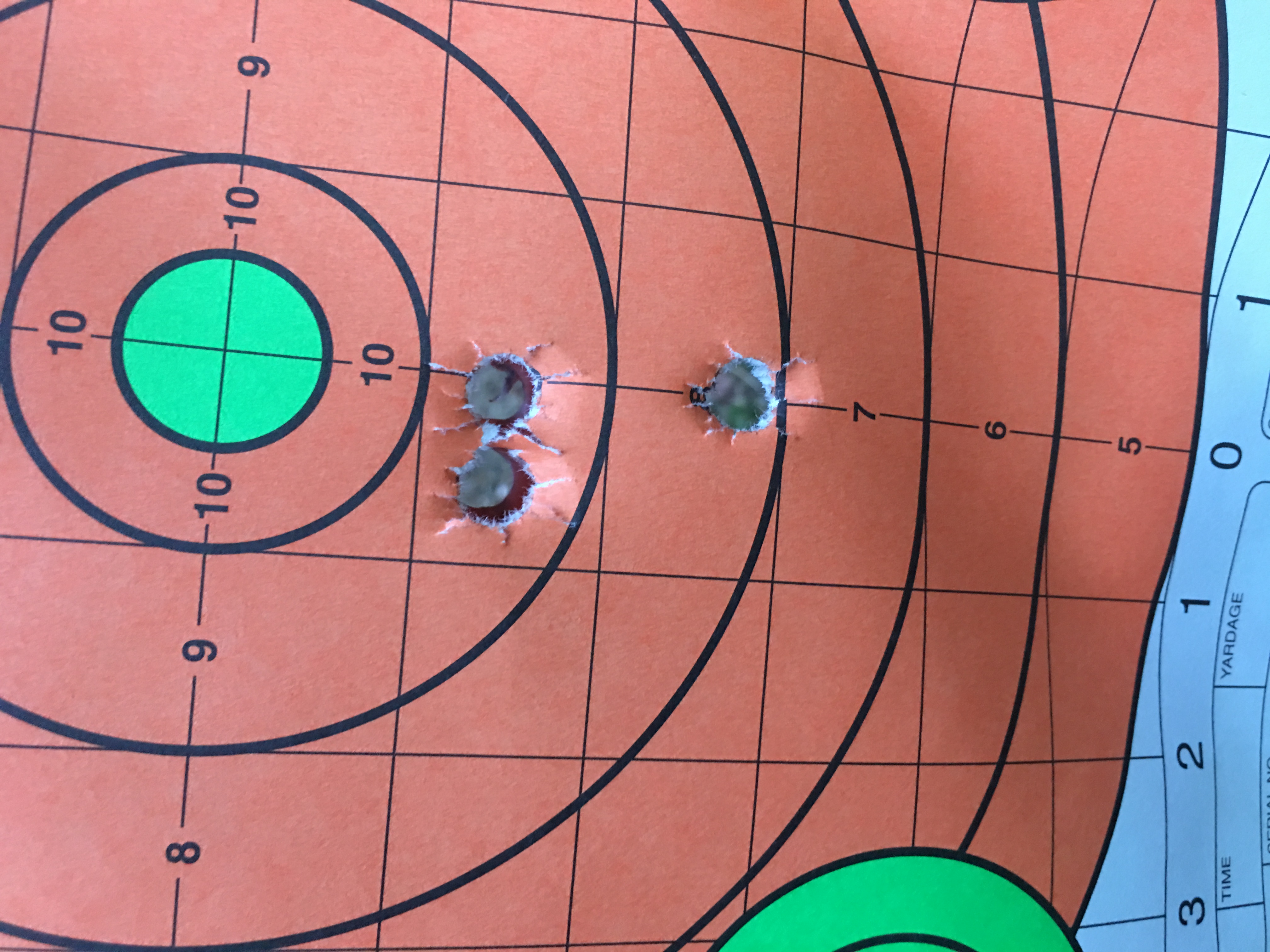

Through it all I came across some interesting conclusions. My gun prefers the 225 FTX with either H110/W296 loaded up real hot or HS-6 loaded mid-high. Below that and the groups opened way up. With the 240 XTP MAG I can get groups in the 2-3" range with either HS-6 or H110. With 12gr of Universal it groups in the 1-1.5" range. All at 100yds. So tomorrow my son and I hope to find a deer for his first youth season hunt.
I also experimented with the 45-70. Using the 400gr Speer, my gun seems happiest with 45gr of RL-7. Pics are of 45-70 on top and 45 Colt bottom.

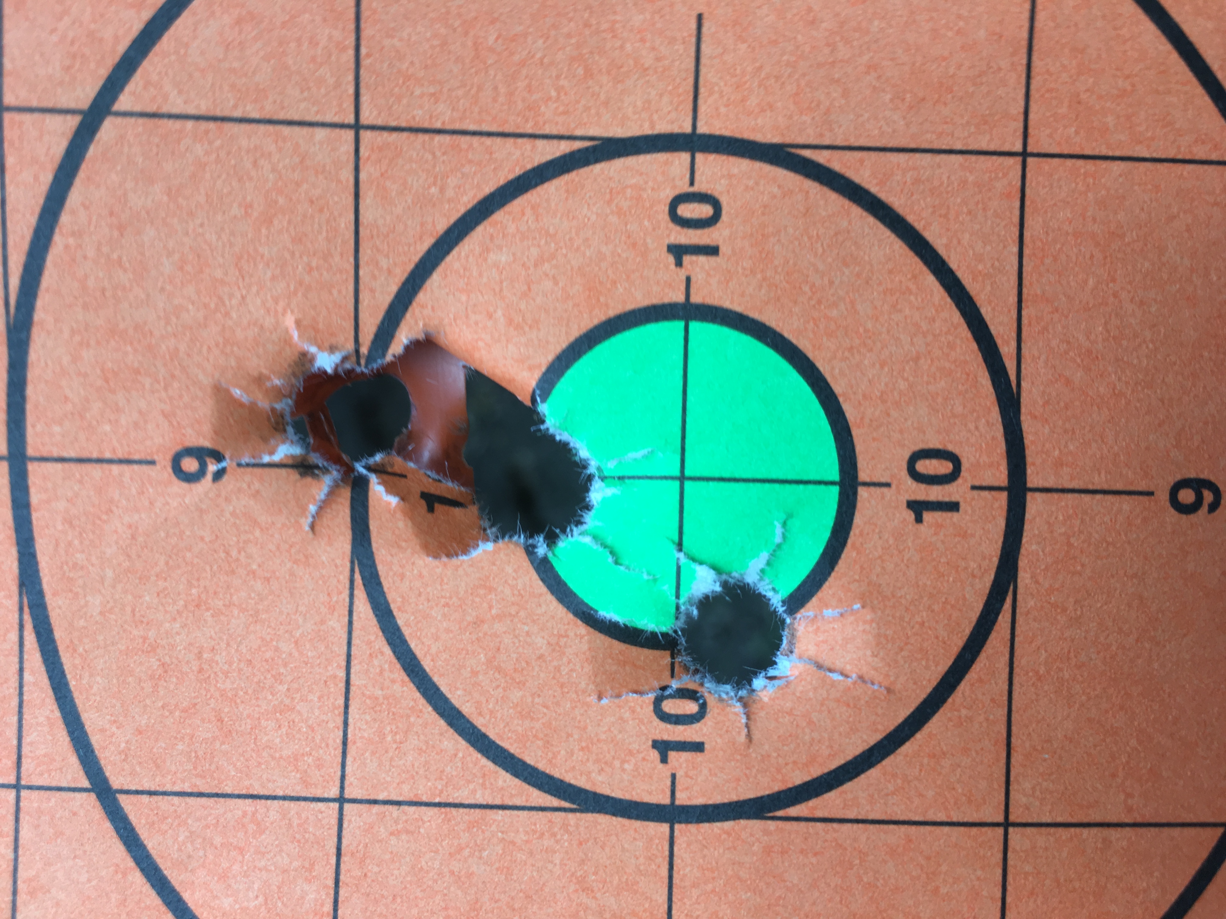

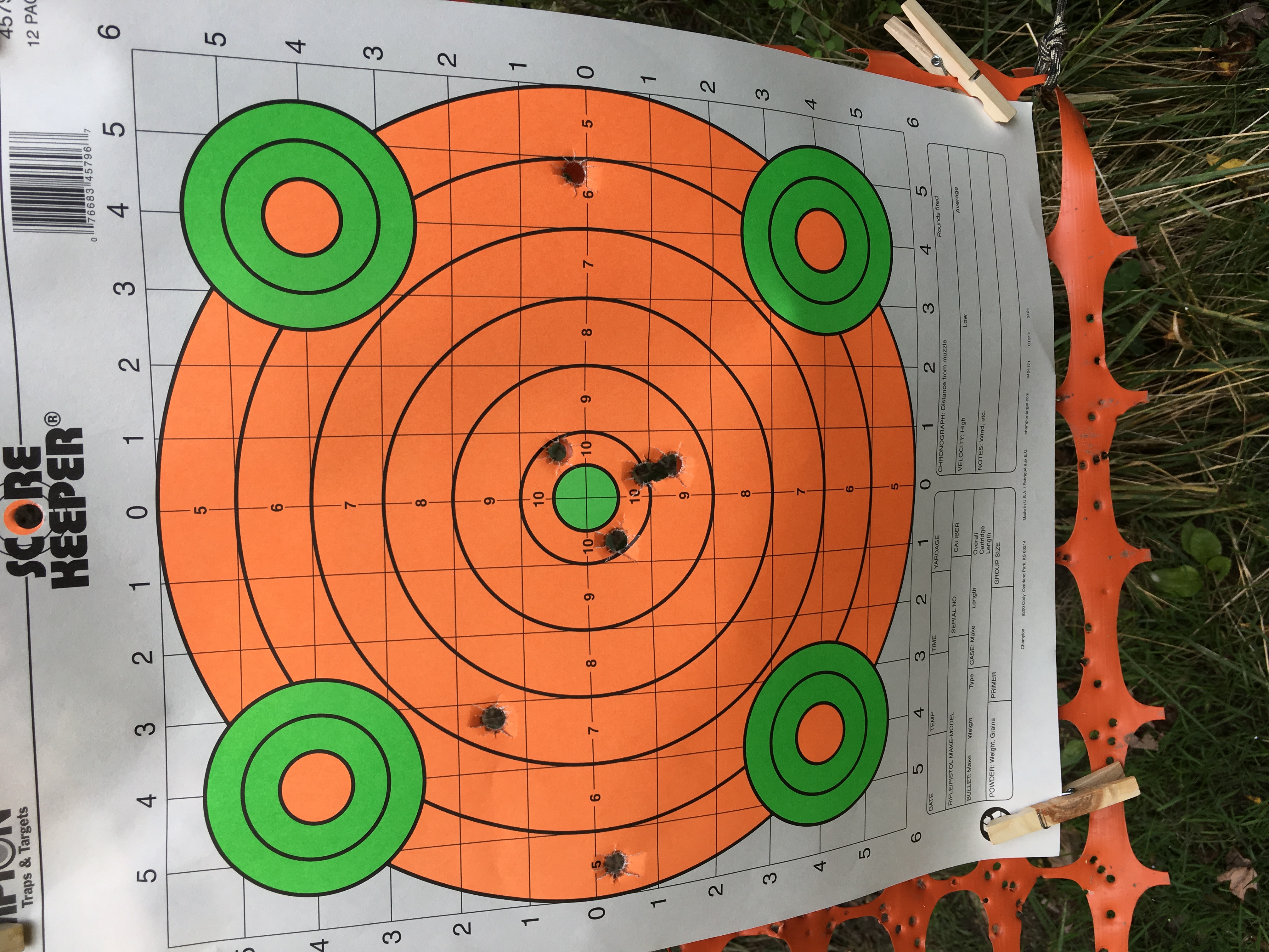

I ended up trying six different loads today. 44, 45 and 46 of RL-7. 56.5,57.5 and 58.5 of Benchmark. Honestly, I don’t know what to make of them. The recoil of the benchmark loads was absurd. I was flinching some I think even with the lead sled.
I ended up getting another nice group from the 45gr RL-7 load(bottom pic) and the 57.5 Benchmark load as well(top pic). This is all at 100yds. The benchmark loads had a POI 12” higher! I missed paper the first shot. Had to try at 50 to see where I was off.
