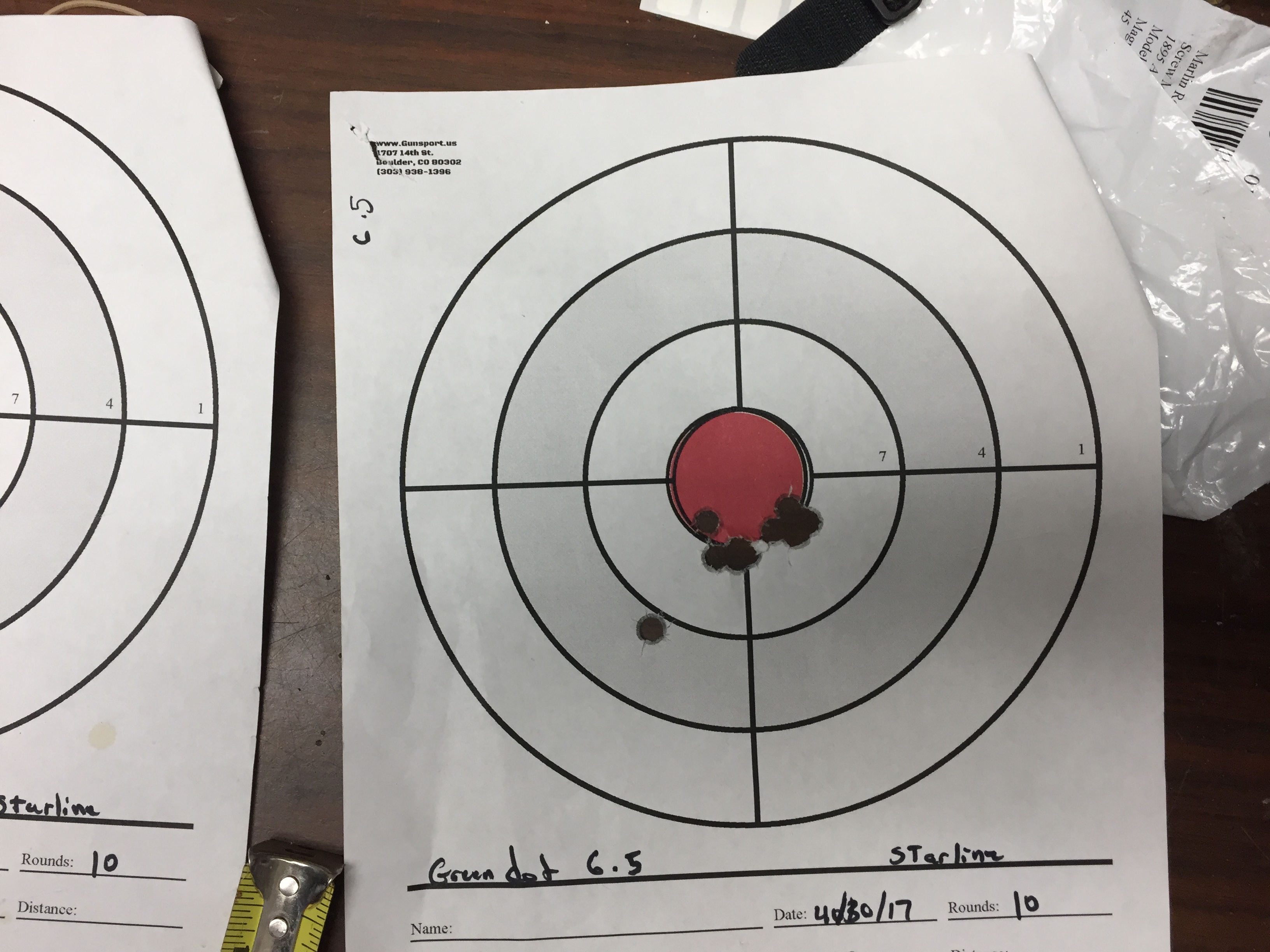

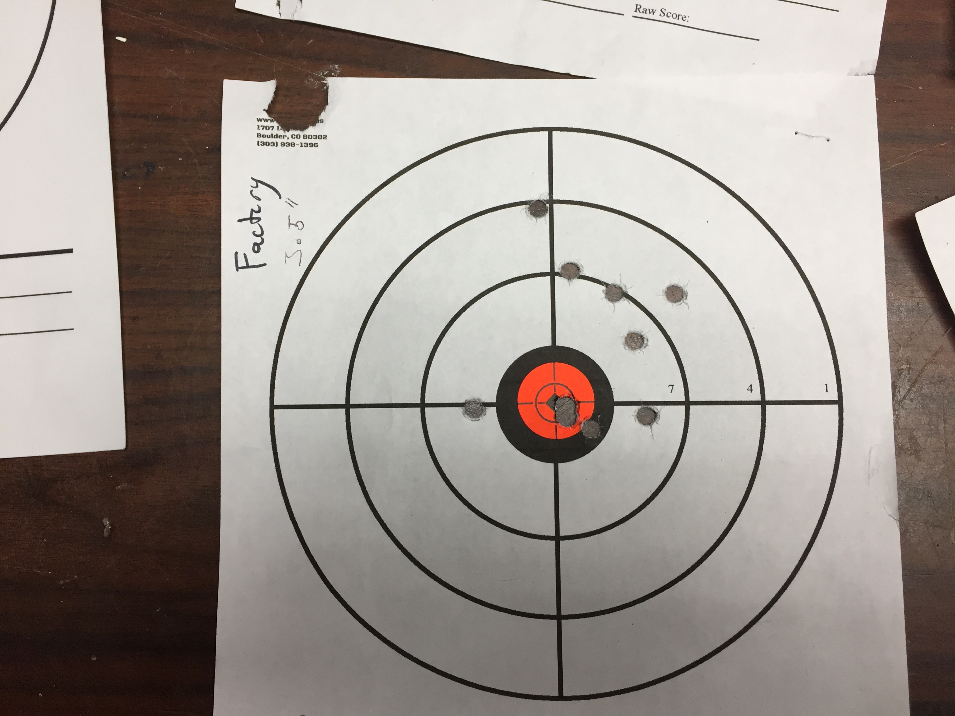

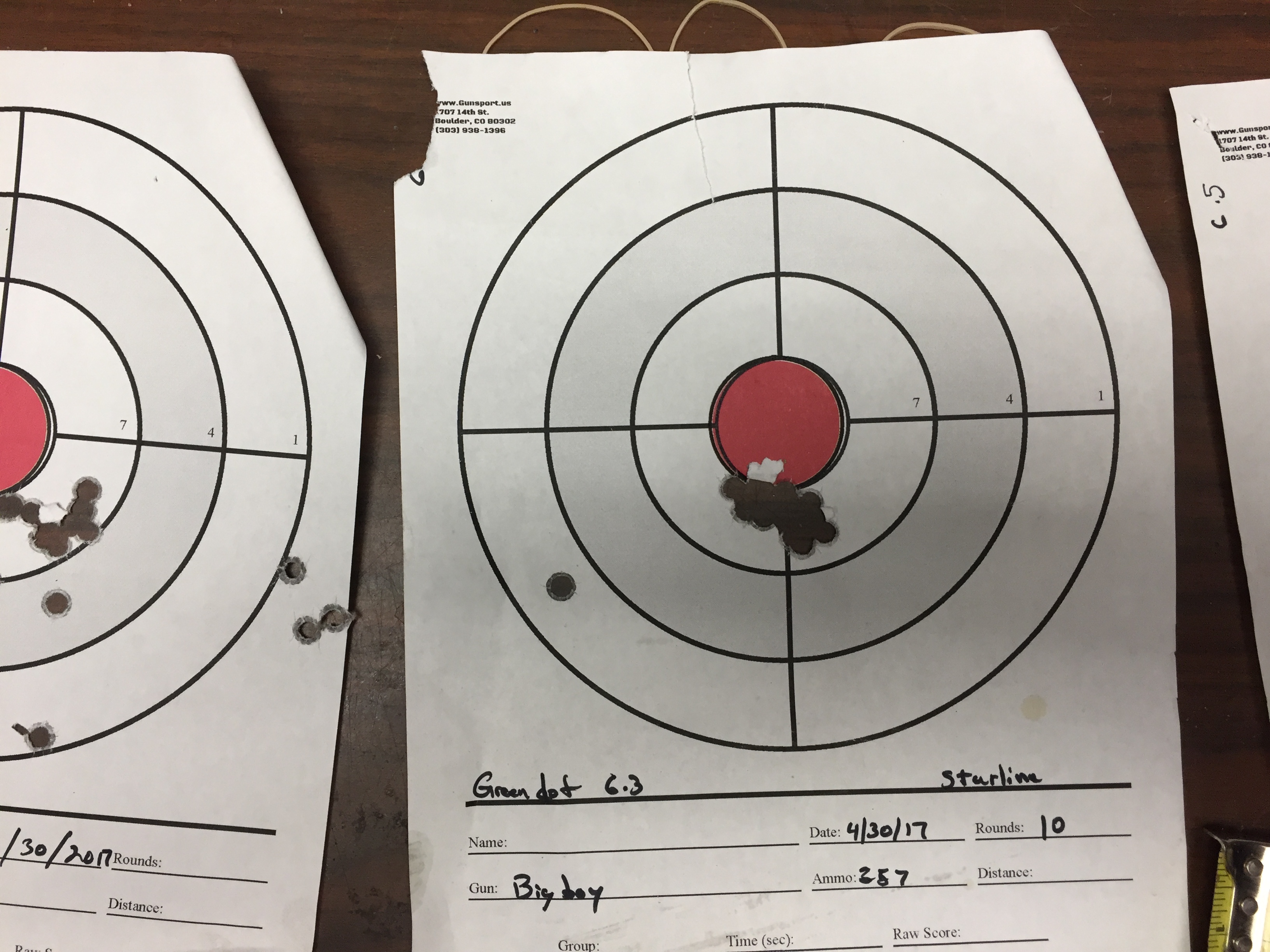

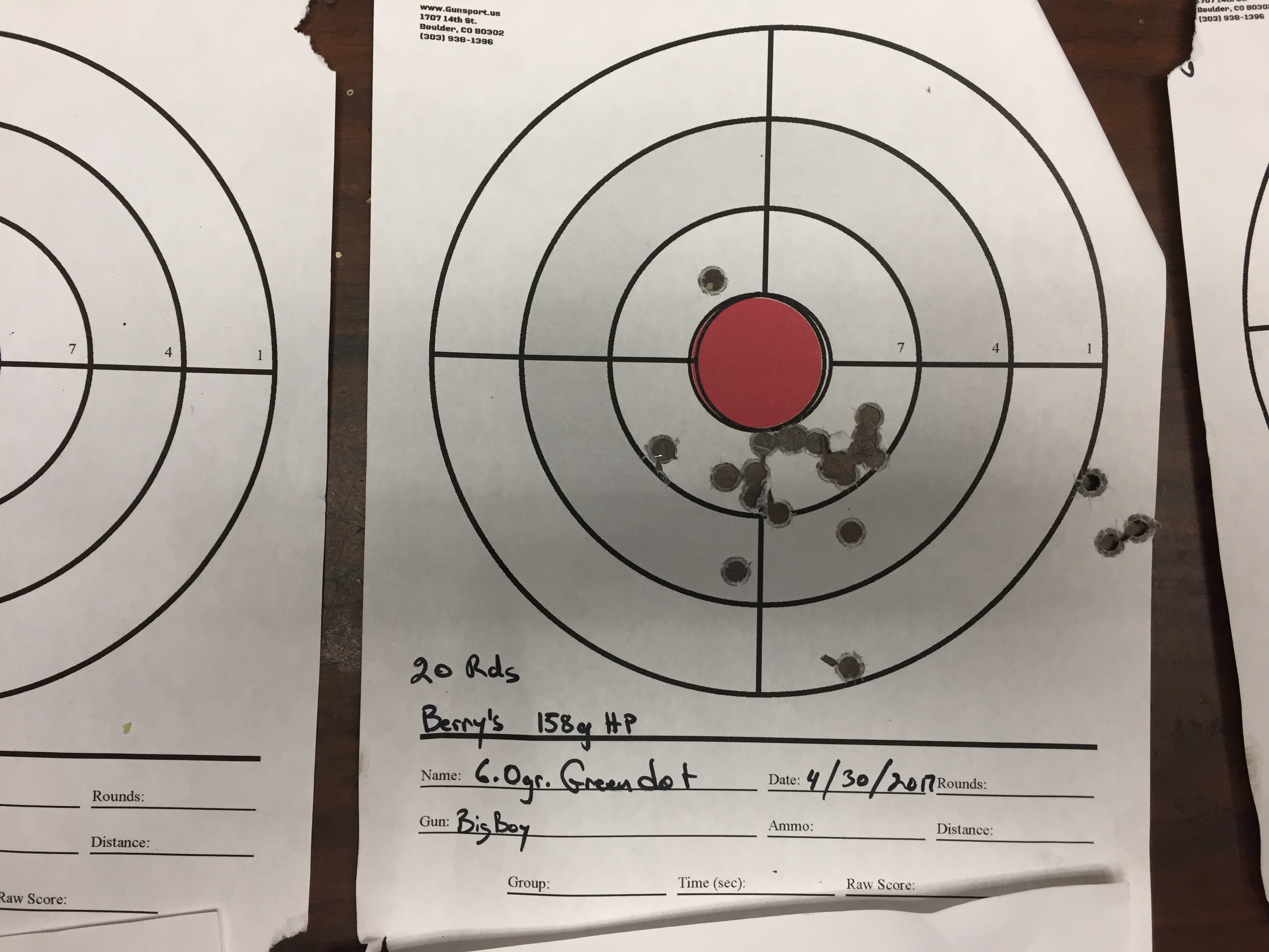

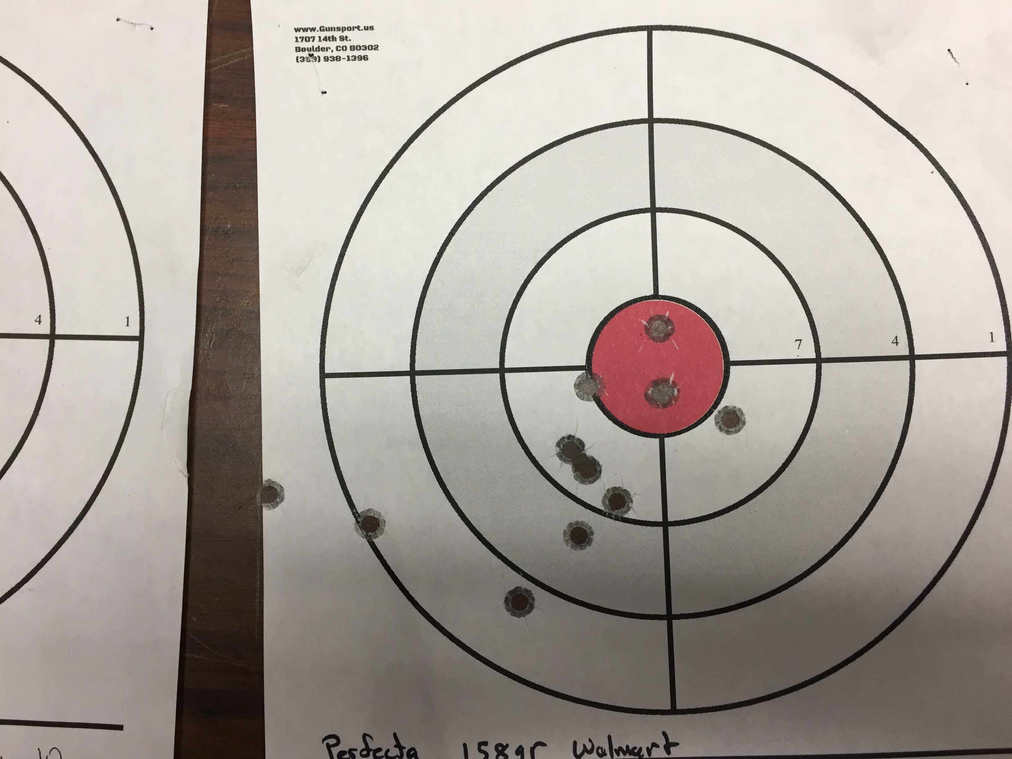

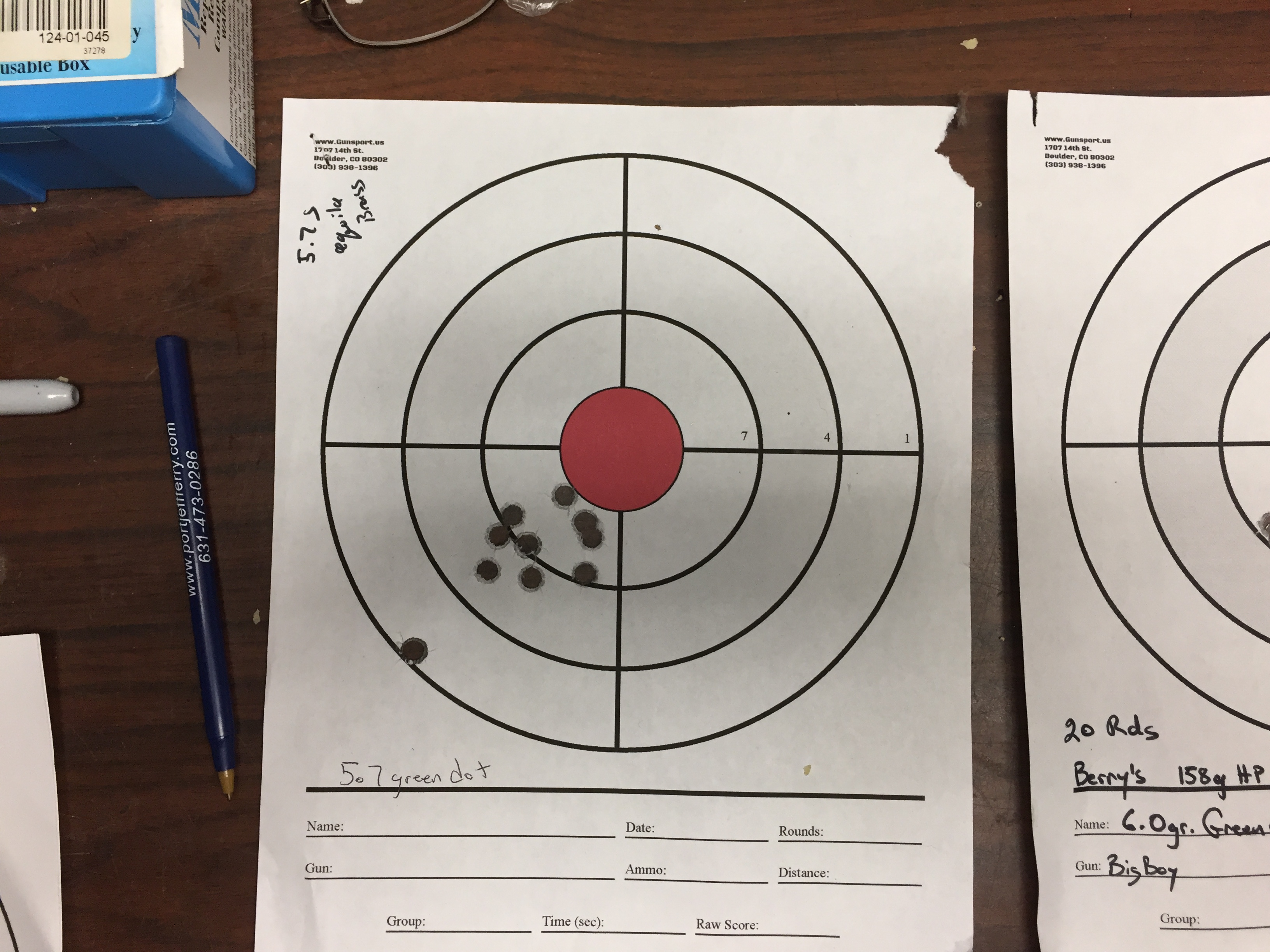

I finally made it to the range and bench tested 357 Big Boy with scope and various ammo. Bench tested at Fifty yards and found in general that hand loading is best by far. First the 38 specials Winchester with 130 grain loads gave pie plate accuracy, I deconstructed some and reloaded with Green Dot and only had a tiny improvement. Next I tried factory ammo from Aguila, Geco, Fiocci and Perfecta. They all grouped as big as six inches or more with GECO having the best group 3 inch. Then came hand loads, I used Green Dot powder, leftover from reloading trap shells,several years old, Winchester small pistol magnum primers because that's all the local Field and Stream store had on the shelf, 158 grain copper plated hollow point Berry's bullets because they were the cheapest and Lee Dies. I used 5.7, 6.0, 6.3 and 6.5 grains of powder

Very nice groups. Looks like the 6.3 or 6.5 gr loads are winners. Did you expect the fliers on those groups or were those an anomaly? I get them with some of my plated 240 gr loads. Maybe it has to do with driving the bullet too slow? But, in your case it should have plenty of velocity.

Fliers are an anomaly, however I was not being picky about casings and weighing each bullet. My next try I will pay more attention to the smaller details. I did not clean the gun between shooting different loads, but cleaning at home did not produce any lead fouling from stripped plating or powder fouling. I also know from experience some guns will have fliers until you find the exact load it likes and that load may not group as small as you like. there are many bullet, powder, primer combos to try and there is a difference between loading for hunting and target and plinking. For me this is just fun.
