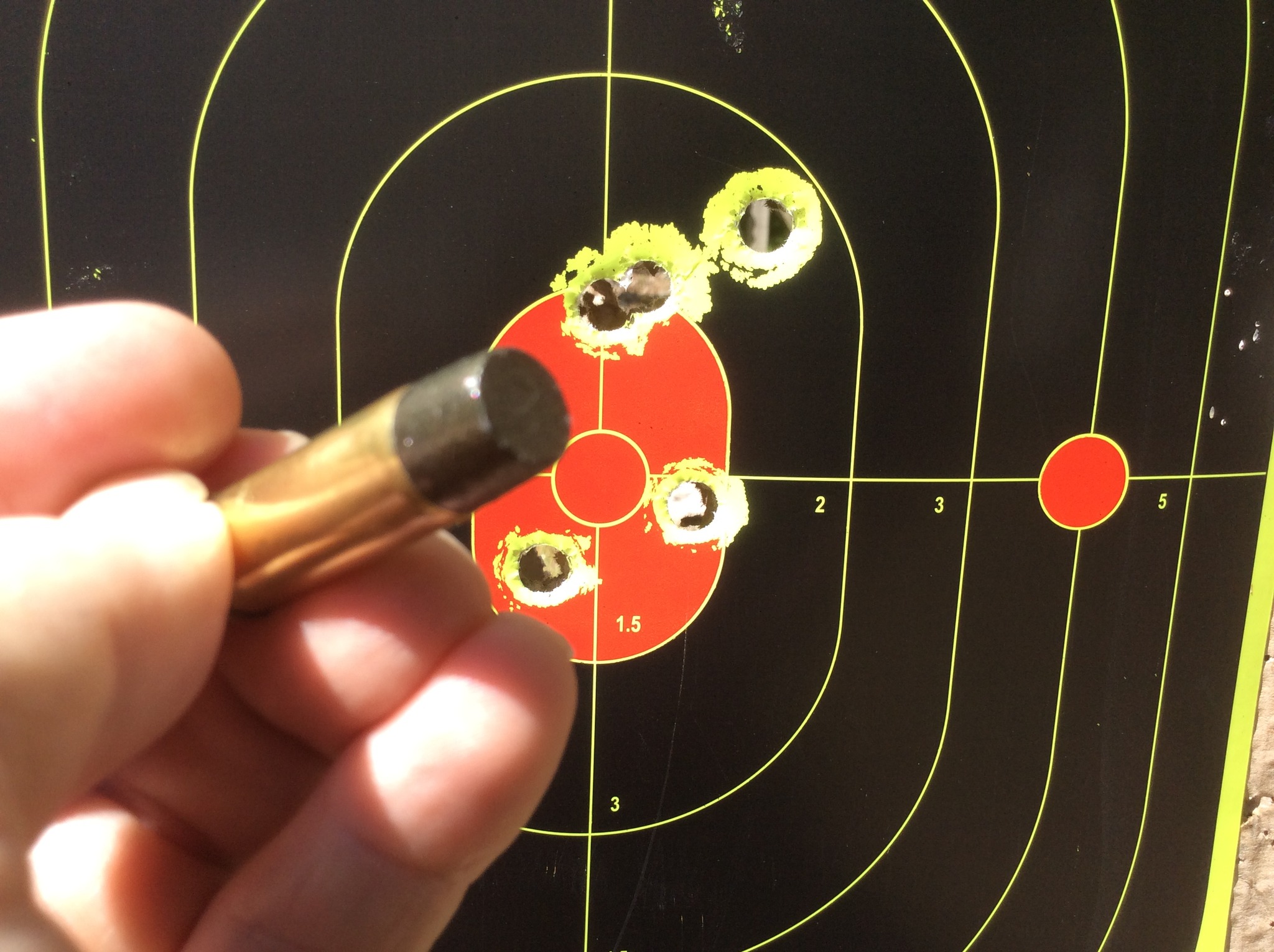

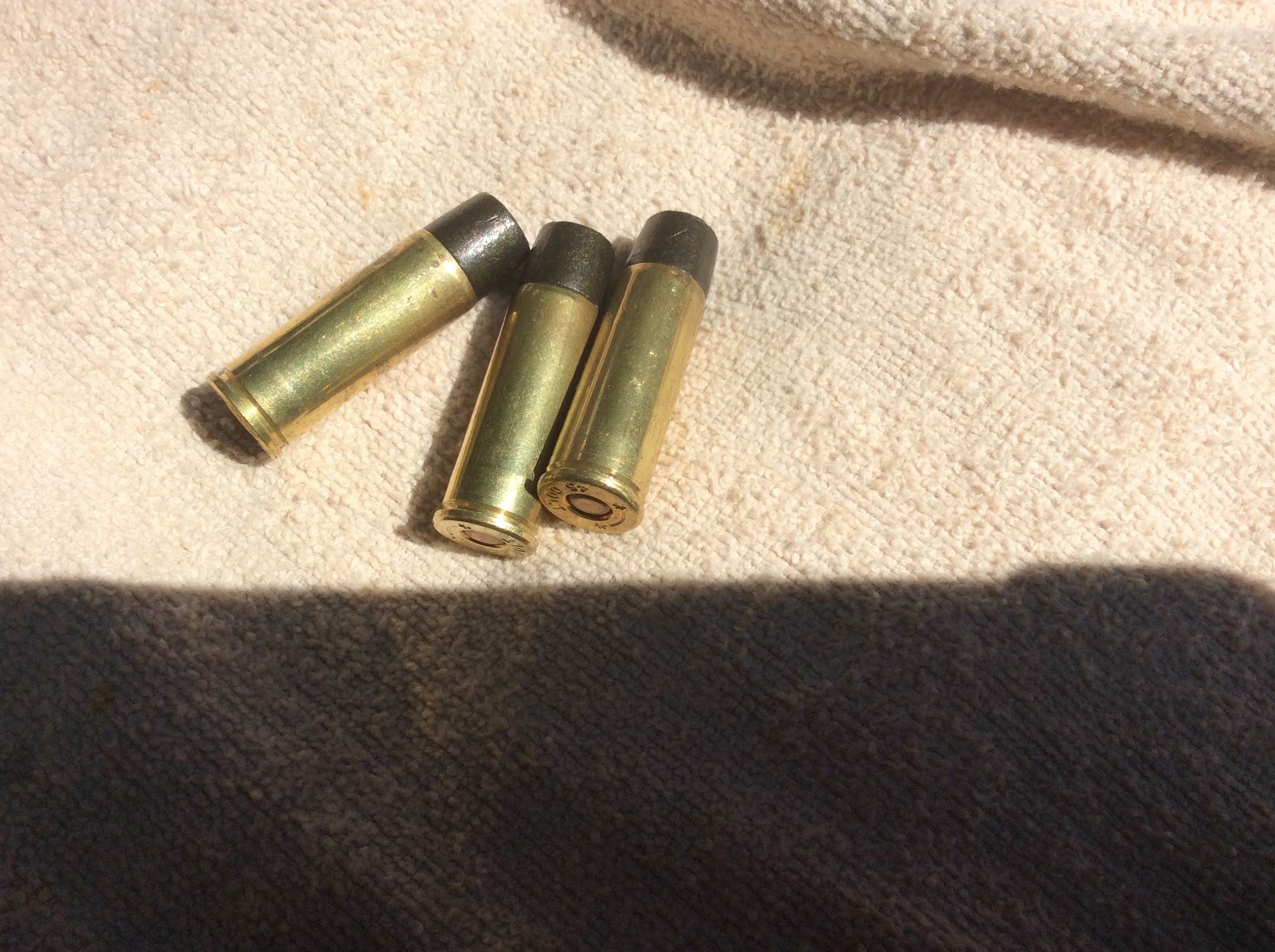

Continuing my load work on the MB 325 Slammer 45 Colt subsonic round for use with suppressor or without. Last try was with Alliant 2400 at 15 and 17 gr. which both proved to be too fast at 1200-1300 FPS. to shoot quietly.
Todays test was with 8 gr. of Unique and it proved to hit my goal at around 1000 FPS with some good accuracy. Video also shows how well it cycled in the Henry carbines.....https://youtu.be/IgPDDnAFA0k

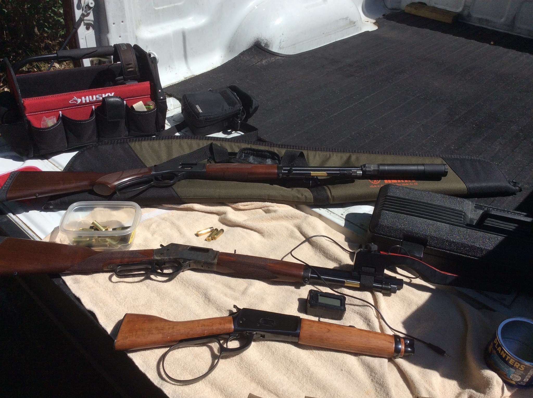

My Henry Carbine front loader was setup with the MagnaSpeed chrony and the X Model had the suppressor and was used on the paper target. The Rossi Ranch Hand brought along to see how well it cycled and shot thru it.
After some work on the Henry front loader it cycled the wide flat nosed Slammers just as well as the Ranch Hand....like hot butter smooth! The X Model will chamber the round but you have to jiggle it a bit and I think some adjustment on the carrier height or angle will fix that.
Looks like a successful heavy Colt load for the Henry rifles plus revolver use as well!
MB 325 Slammer actual 320 -322 gr with 8.0 Unique.jpg (747.39 KiB) Viewed 1312 times
testing 45 Colt 325 gr MB bullet.jpg (802.92 KiB) Viewed 1312 times
45 colt 325 gr with 8.0 unique thru Henry 45X with suppressor 1000 FPS.jpg (531.44 KiB) Viewed 1312 times

On my front loader carbine I just machined back the case stop about .080 and it runs really well with the 1.655 45 Colt as you could see.
Now the 45 X model would take that length without any mod but the lifter tends to want to drop down a bit and cause an issue unless I jiggle the rifle but with a typical 250 gr. 45 Colt load it works fine.
Will have to study that and see what I can do.

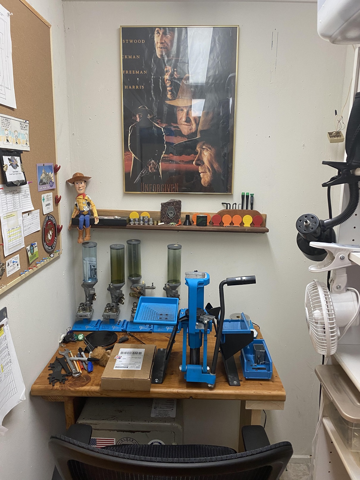

I thought very seriously about buying dies for a couple of additional calibers, pulled up the website and looked and lo and behold, even with the higher prices of ammo these days... for as little as I'd shoot the newer rifle / pistol calibers... with the cost of the setups, I could buy a lot of factory ammo. When I add a caliber I like to have dies, toolhead, powder measure, etc. That way it's all set up and ready and you just pull the pins, and slip in the tool head and perhaps change the deal at the bottom and off you go. Of course you have to check the powder drop, and I do that about every 10 rounds anyway. ;)
new bench comp.jpg (698.29 KiB) Viewed 1132 times
I am set up to load 9mm, .38 wadcutter, .38 semi-wadcutter, .40. and 45acp. (All my competition calibers)
I decided a long time ago not to bother with rifle calibers.
I have heads for all my calibers. With the lyman T8, I am able to put a two calibers per head unit. Now I found out Creedmoor sports has enhanced press heads.
https://www.creedmoorsports.com/product ... ng-presses
Then I found out there is a 9-station turret press.
https://youtu.be/BOoEcsmKEFo
But for way less than 1200, I have my t8 with 6 extra heads.
I am happy with the turret press. One day, if i shoot in volume again, I'll pick up a worth while progressive.
