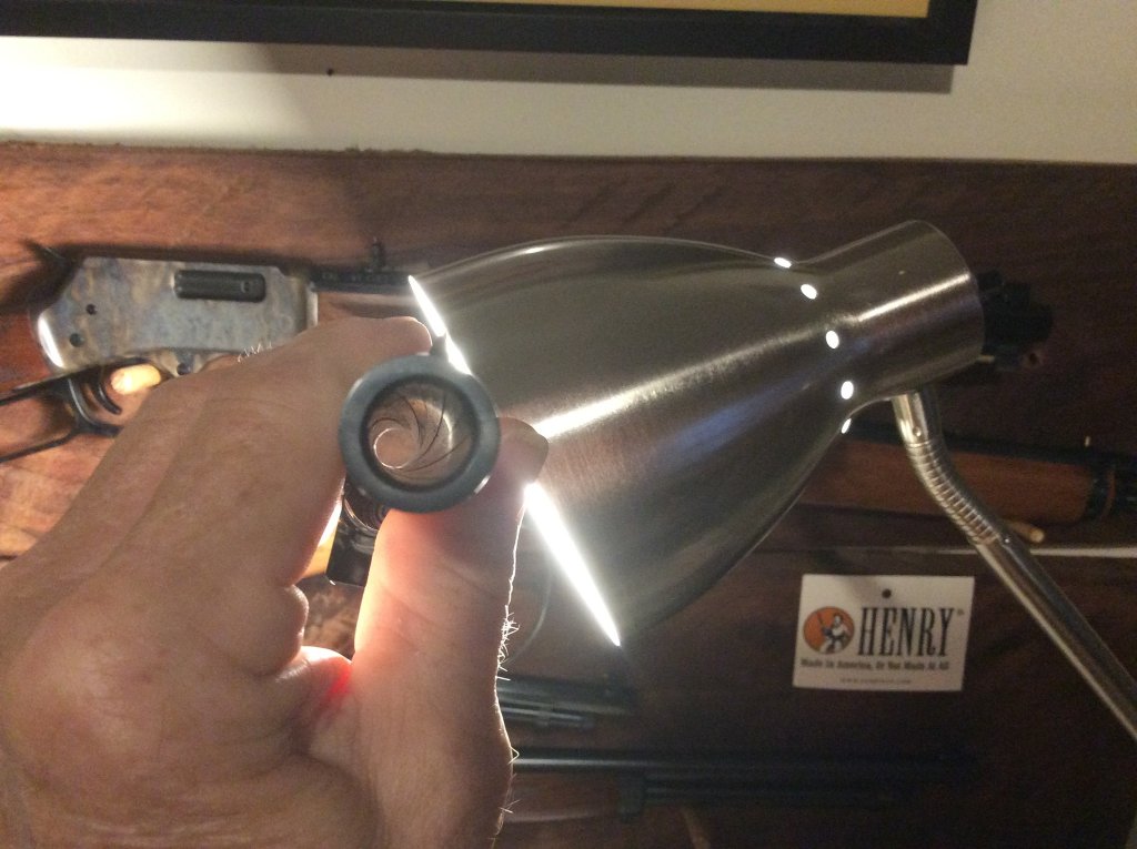

Post by fortyshooter » Mon Oct 18, 2021 9:06 am
Took a pic of the barrel from my 1872 .44 Open Top revolver showing just light residue after 60 rounds. Bullets were the MB 240 gr coated SWC with Bhn of 18. Just a run thru with a Ballistol patch should do. Have some uncoated 240 gr. cast lead bullets rated at 11 Bhn coming from Matt's to try but think the MB will work fine as well.

Post by Rifletom » Mon Oct 18, 2021 10:04 am
Forty, that bore picture looks exactly like the bore in my Pietta after 50 rounds of coated 250gr rnfp. Impressed! Just ordered 500 more from T&B Bullets. Once my supply of plain cast is done, it's coated from here on out. Thanks for the picture.

Post by fortyshooter » Mon Oct 18, 2021 10:09 am
Tom...what did your plain cast loads look like?

Post by Rifletom » Mon Oct 18, 2021 10:33 am
They're the Missouri "Cowboy" #1 .452", 250gr rnfp plain with the blue lube ring. Basic stuff. Brinell 12.
T & B is 15 Bhn.

Post by fortyshooter » Mon Oct 18, 2021 1:24 pm
T & B is 15 Bhn.
Did the MB Cowboy bullets leave any leading?

Post by Rifletom » Mon Oct 18, 2021 2:49 pm
Yeah, they did. Got it out with some "Wipe-Out" liquid and a good number of patches. Then 50 rounds of a couple of powders, 250gr bullets from T&B and I was mighty happy with the results. Powders were Unique[8.0gr] and Universal[7.0gr].
I'm sure the coated bullets from Missouri would work just as well, I just didn't have any in .452". I'm a believer in these coated bullets.
