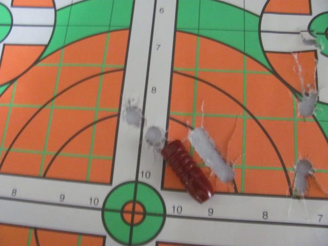

interesting .... MB puts out good bullets but its possible you got a bad one .... the fact that it is the only one you've had to tumble, my first reaction is a bad bullet ..... the only bullets I've ever loaded that keyholed were coated Acme 500 Grain RNFP fired from our 45-70 --- http://www.acmebullet.com/bullets-reloa ... uct_id=446 .... my belief is they were just too heavy for our rifle to stabilize .... I've fired bunches of brands of 240 gr'ers out of our 44 and none have keyholed
170809 001 500 g tumble 001.jpg (40.05 KiB) Viewed 1333 times
